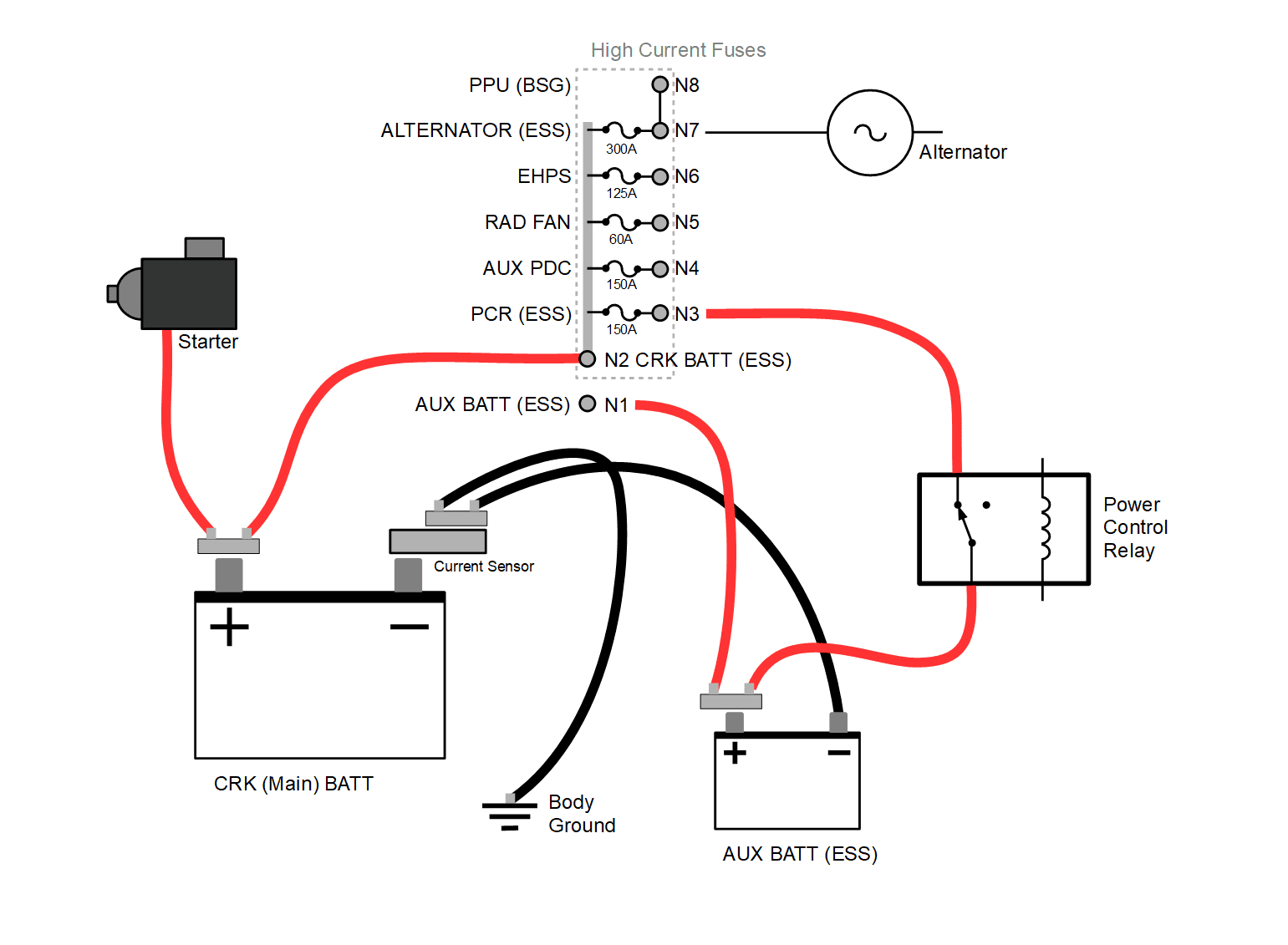

Are there terminals to attach a charger to?

Look at the diagram on the fuse box lid. I think N2 and ground should do it, but not sure. The little battery is under the fuse box, but I'm not sure how difficult it is to get to.
