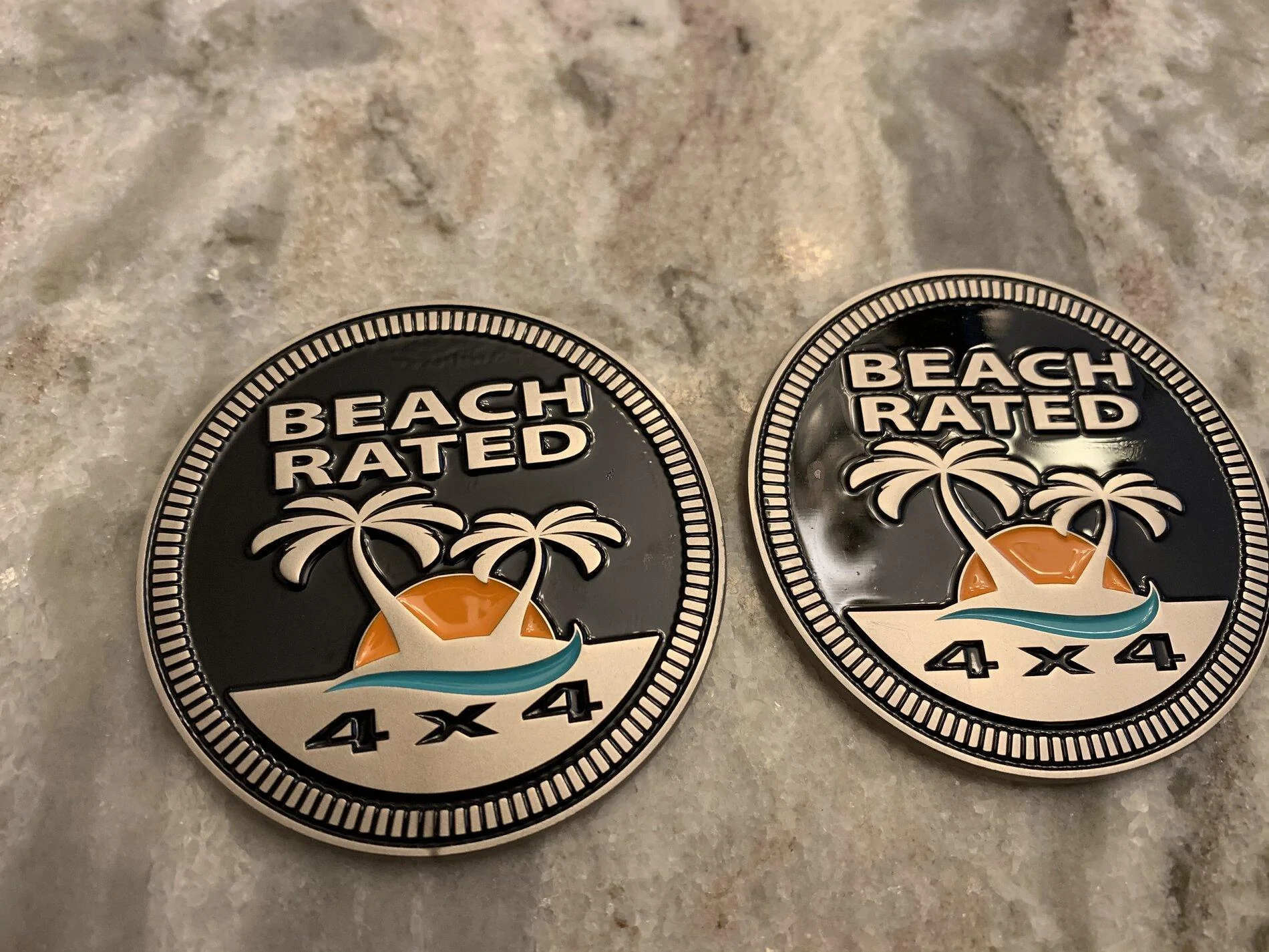

I just received my new beach rated badges! They use 3m VHB tape. Is it okay to stick them on in mid 30’s temperature? I’m seeing mixed opinions when I google it.
Thanks

Take a hair dryer and warm them up and where you are sticking them and Press and hold for 2-3 minutes and you will be good to go. As above 40 Deg is preferred.

Okay thanks, I think I'll try to be patient and do it tomorrow. It's supposed to be slightly warmer then. Right now it's down to lower 30's with the wind going crazy.
It's just hard to be patient.

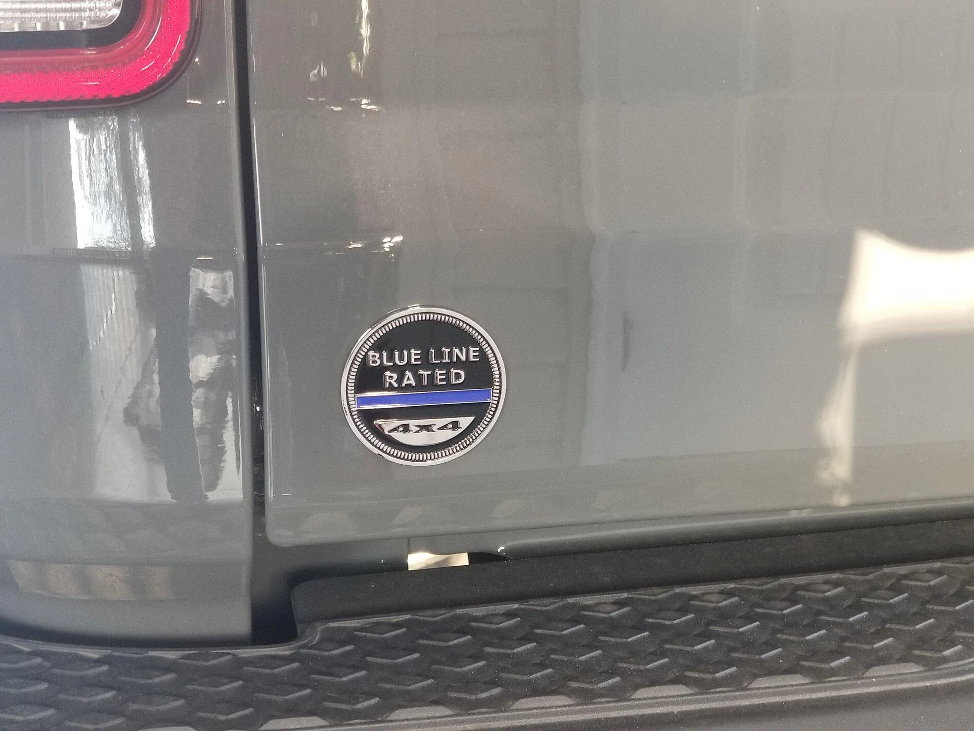

As above. Warm them up and press and hold, you should be fine, and make sure surface is clean. I added mine when it was about 44° and haven't had an issue.
