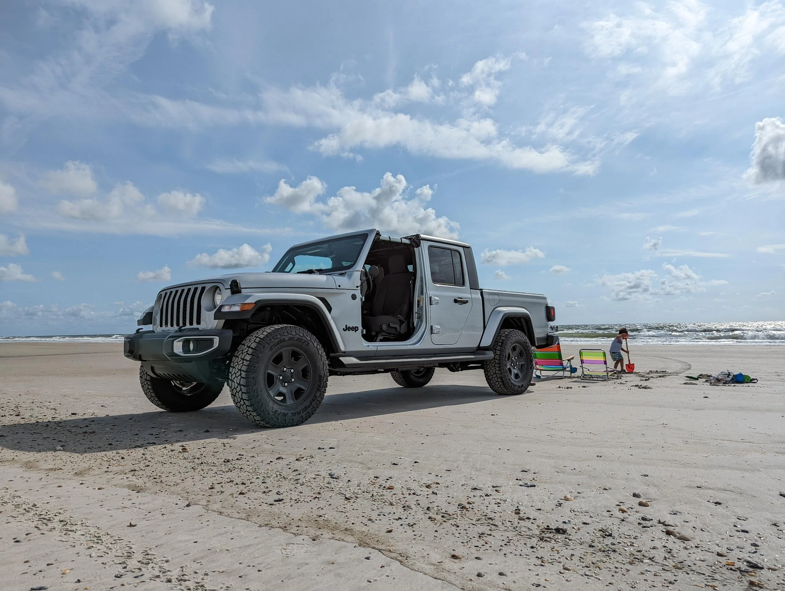

Looks great, depending on how much of a beach runner you need, I would not go very wide or big for beach travel, I'm running factory 33 Falkens, and will go to the next size taller (true 33")but narrower tire when I talk my wife into it or wear them out . Beach tires are best with not aggressive tread, rounded shoulders, and not too wide people think wide helps float , but you also are pushing a little wall of sand in front of you as you drive, and when airing down the foot print gets a little wider but also much longer. I like the Falkens for all around use, and is what I am thinking about going to in the narrower taller tire........Jack

Also in your picture that beach sand looks pretty hard and flat, nothing like I'm use to in Delaware, Hatteras and few other places....Jack

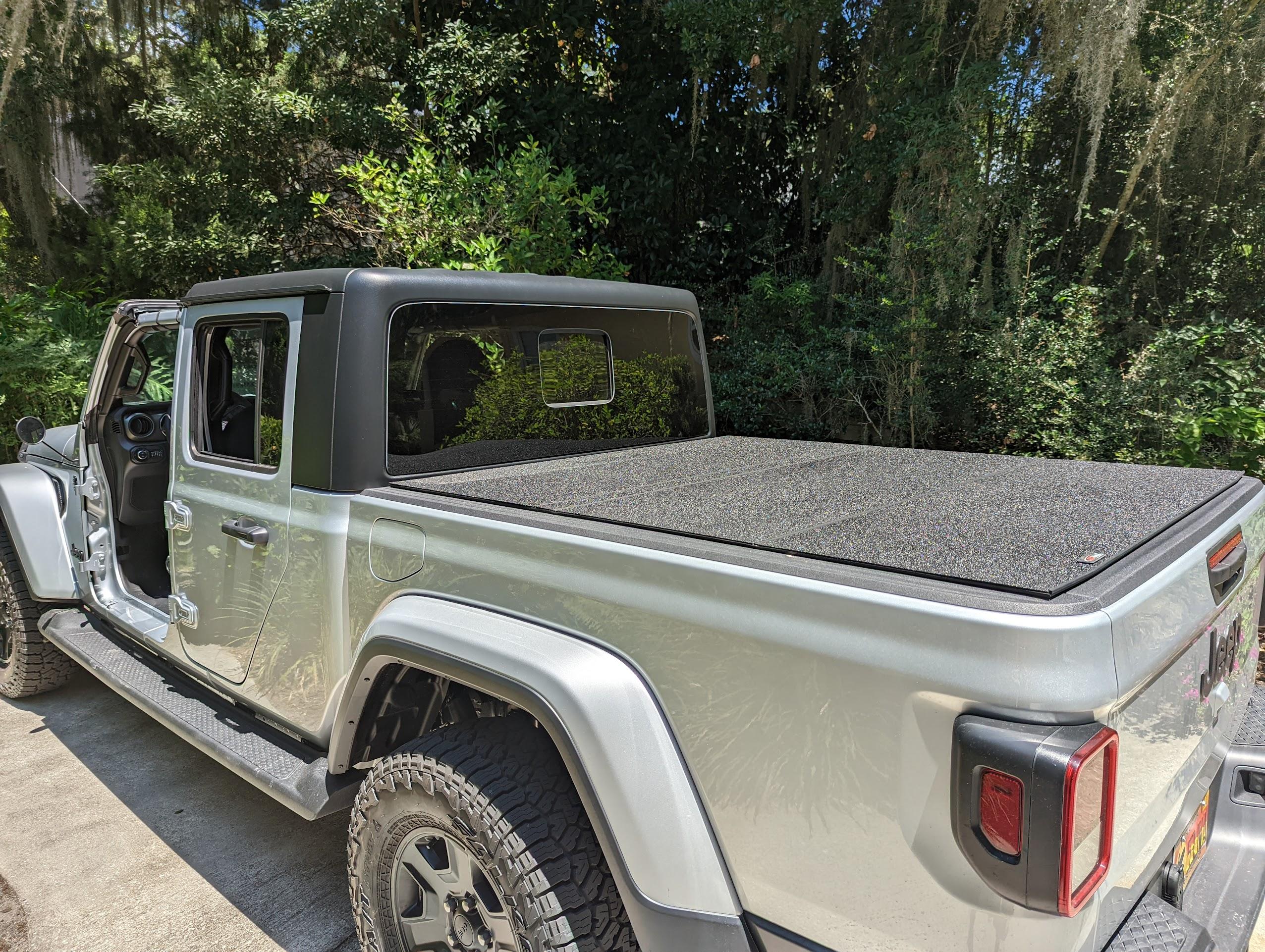

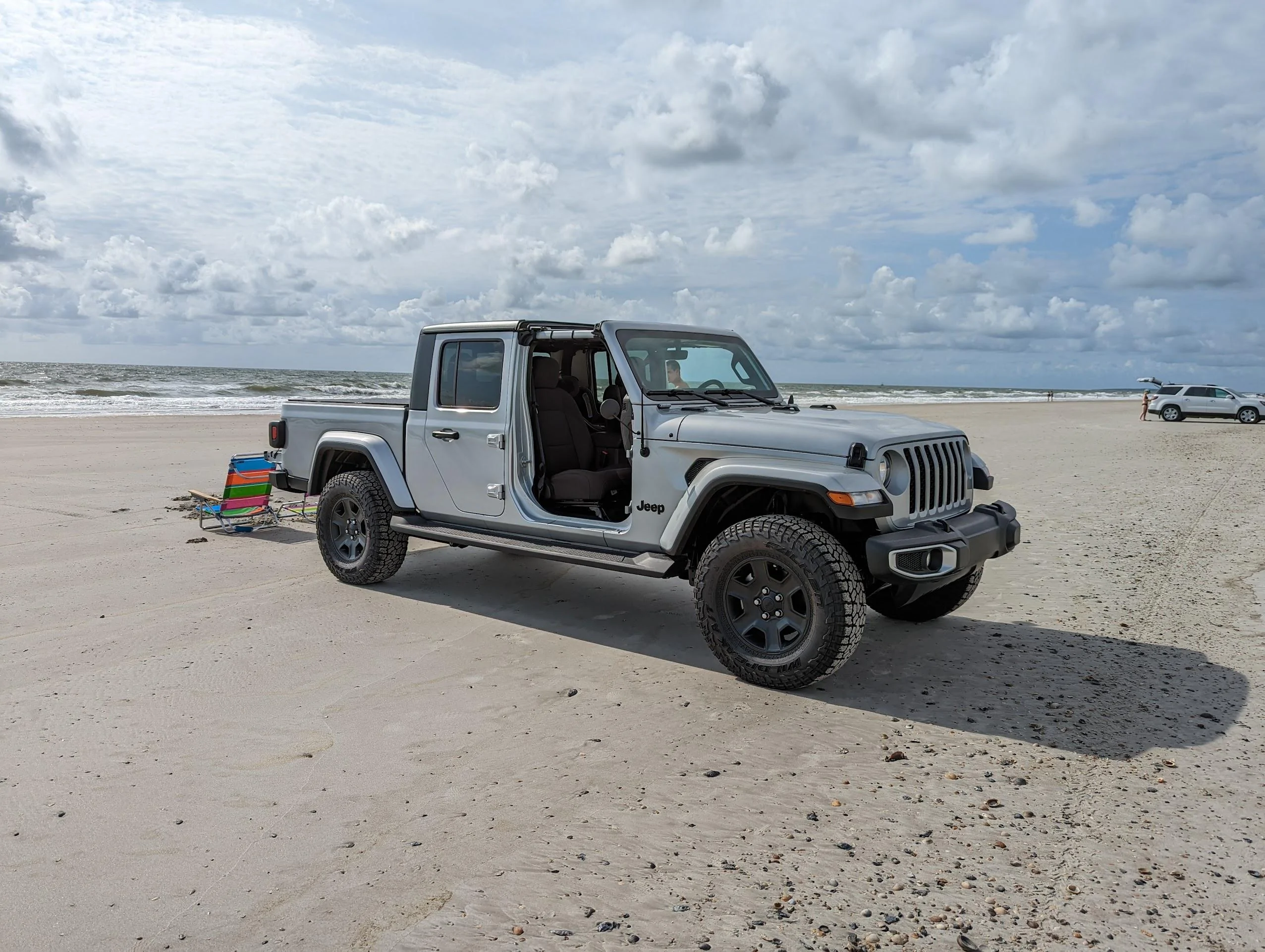

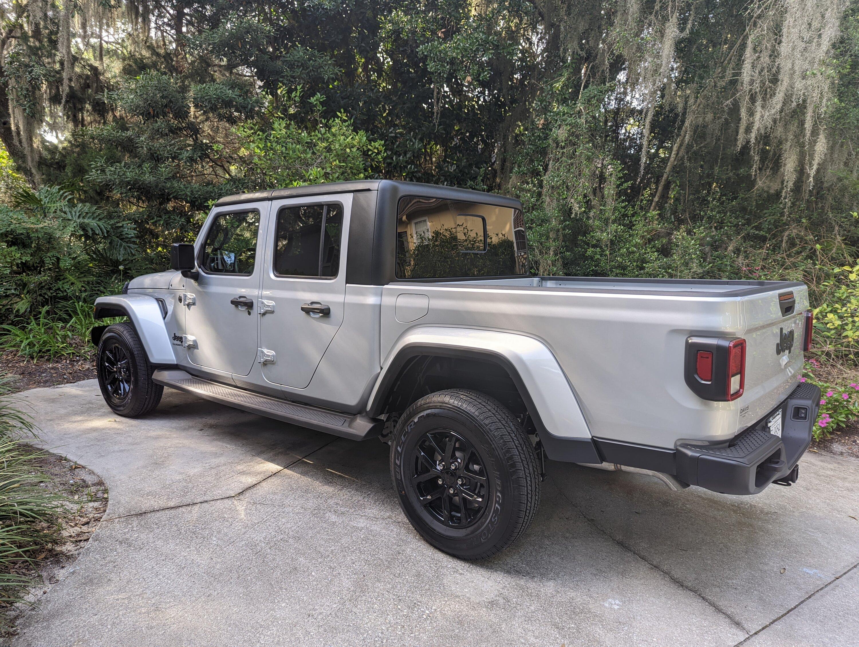

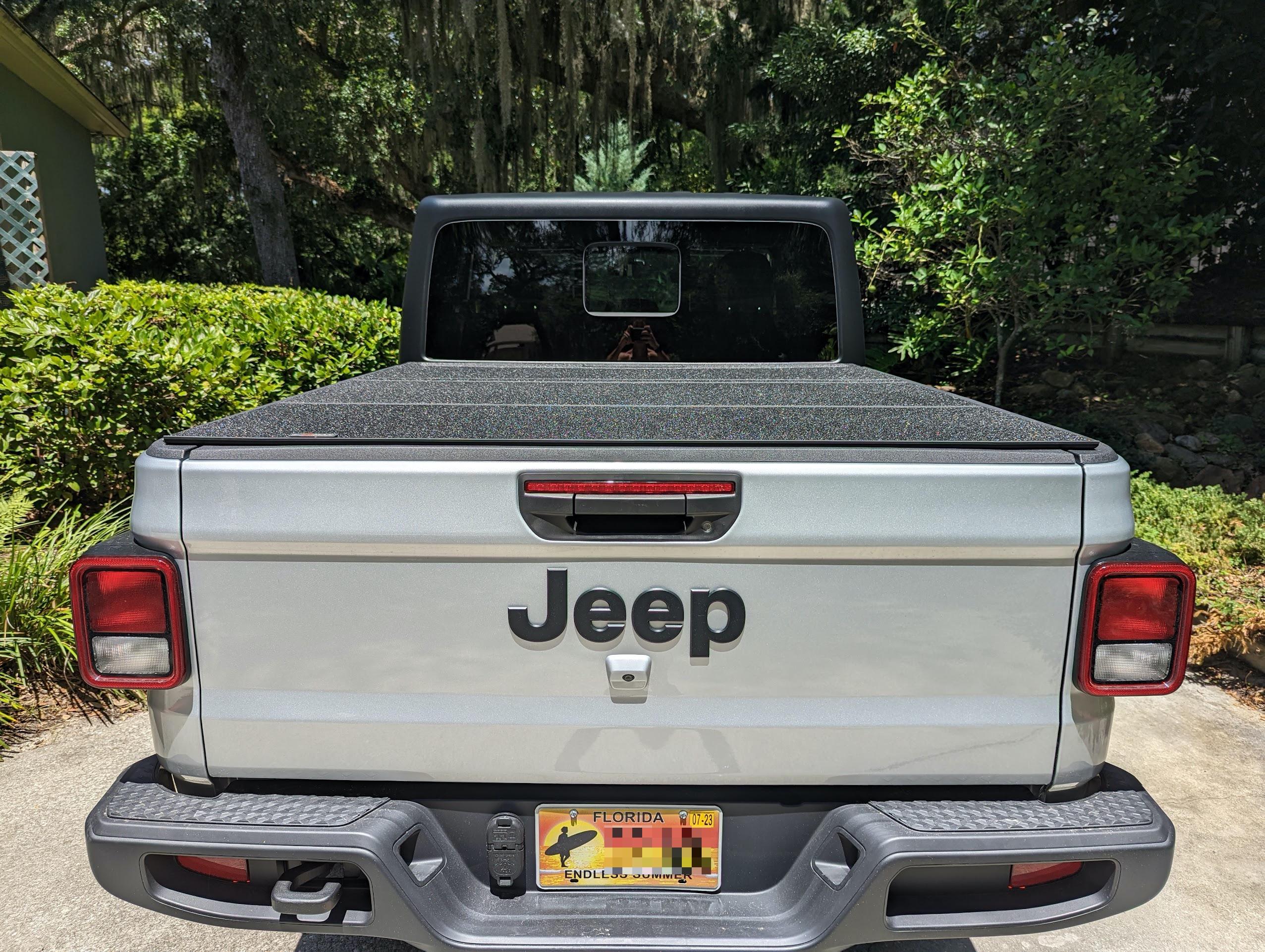

Finally got the truck out on the beach today! Recently added a 1.5" leveling kit, Mojave takeoffs, and a Lomax trifold cover. Waiting on my Armorlite flooring to arrive.
How do you like the Lomax cover? I have one as well and you don’t see too many of them. Very low profile, easy to fold, and remove. Little weighty at times…
I love mine. Glad to hear from another owner.
I don't understand why the Lomax isn't more popular. When I compare it to photos of other covers + what I see on other trucks around town, the overall look of the Lomax is much better. I also haven't had a single leak despite a lot of torrential downpours during the Florida summer. And I didn't have to do any fiddling with seals, or adding weatherstripping, etc. as I see folks talk about with some other brands.
Maybe it's a bit heavy, but I'm far from being a big/strong person, and it has been no issue for me to lift off/put on when required.
Yeah, not extremely heavy, but slightly more than fiber ones. I can echo leaks are non-existent.
