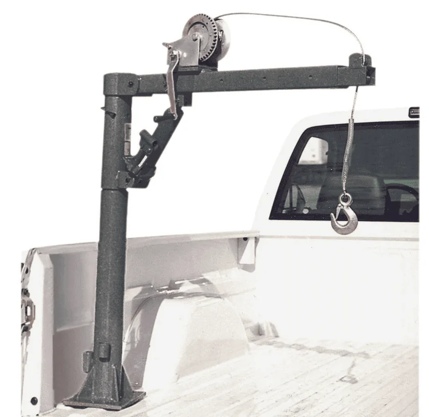

If you go with the bed mounted version, skip all the plates.
Locate it so it's over one of the frame rails, use U-bolts to go around the frame rail and up through the bed and bolt down the base to those.
Remember one thing, IF you swing the jib to the side of the truck it is bolted to, you CAN turn your truck over very quickly and very easily. You won't have outriggers to protect you.

Yes, take a look at any big utility truck with a bed crane, they are u-bolted to the frame.
By applying plates to each side of the bed, you are still mounting it to the weakest structure available. The frame is the strongest part of the vehicle at this point. You can use a plate on the top side of the bed to protect the surface, but not use it as a mounting point.
It's going to have crazy leverage no matter how you mount it without putting a full sheet of steel in the bed and mounting the steel through the bed back to the frame.
Your choice of plating top and bottom puts all the force to a small section of the bed. A 10" x 10" or 12" x 12" plate is not big enough.
But, you do it your way, you've seen it done that way for years and it must be right.
The truly correct way is to mount a davit arm and base attached to the frame and use outriggers. Any other connection risks damage to the vehicle and/or operator.

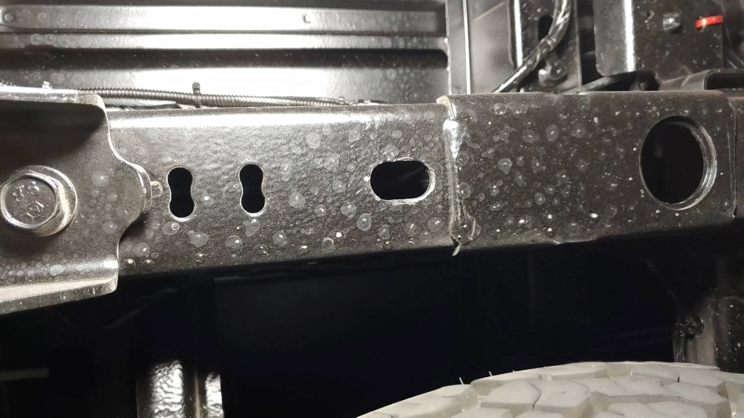

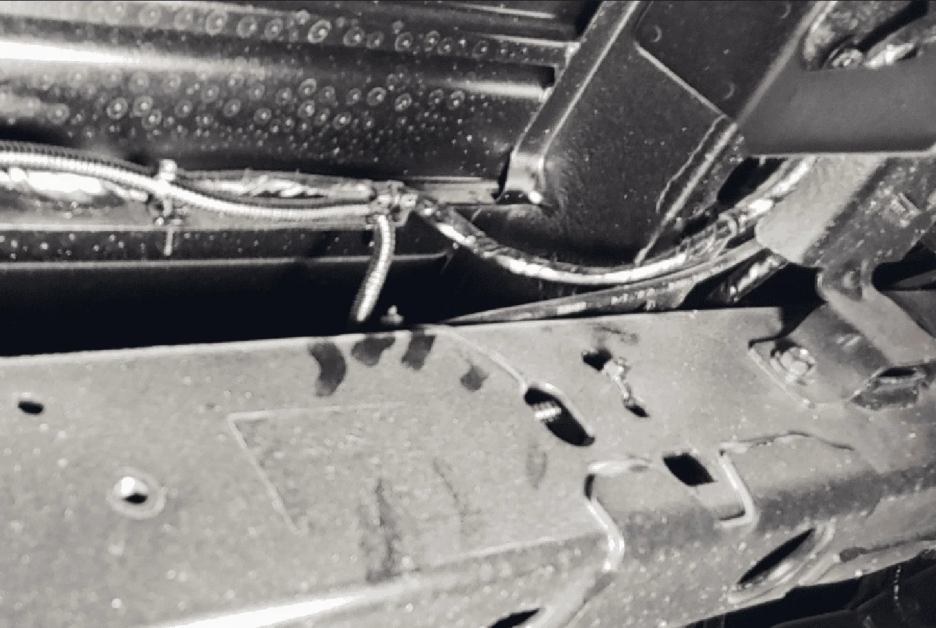

Yes, clamping to the frame is best but you can't just drill through the bed floor and use u-bolts down around the frame - not on these.
There's at least 1.5" between the bottom of the bed floor and the frame. How do you suggest spanning that gap?
If you bolt through the bed and around the frame, you are going to be pulling the truck bed down hard. You'd bend it. So you need a channel between the floor and the frame to prevent sucking the floor down. You'll suck the bed floor down if you don't span that gap.
If you mount it over the cross braces, you'll crush them - look at the gauge of metal used.
Jeep Gladiator Bed Crane - Harbor Freight 20221216_211922
Jeep Gladiator Bed Crane - Harbor Freight 1671250400086
These frames are narrow boxes. So a u-bolt would have to be narrow - meaning the crane would have a lot of leverage over them. You need to spread the fasteners out in a larger pattern.
So ideally, you'd "pad" the width of the frame to prevent the u-bolts from pulling down at an angle.

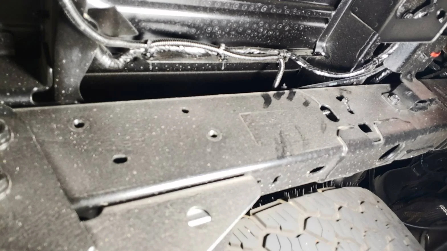

Jeep Gladiator Bed Crane - Harbor Freight 20221216_211900
You need to overcome the shape of the floor - or you'll crush it down as you tighten any bolts - even just using plates. These bed floors aren't made for clamping forces like that.

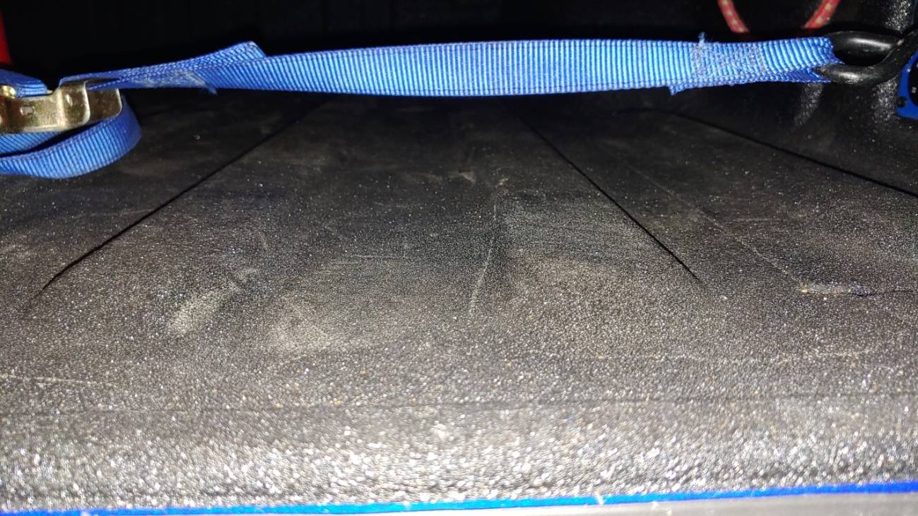

Jeep Gladiator Bed Crane - Harbor Freight 20221216_211745

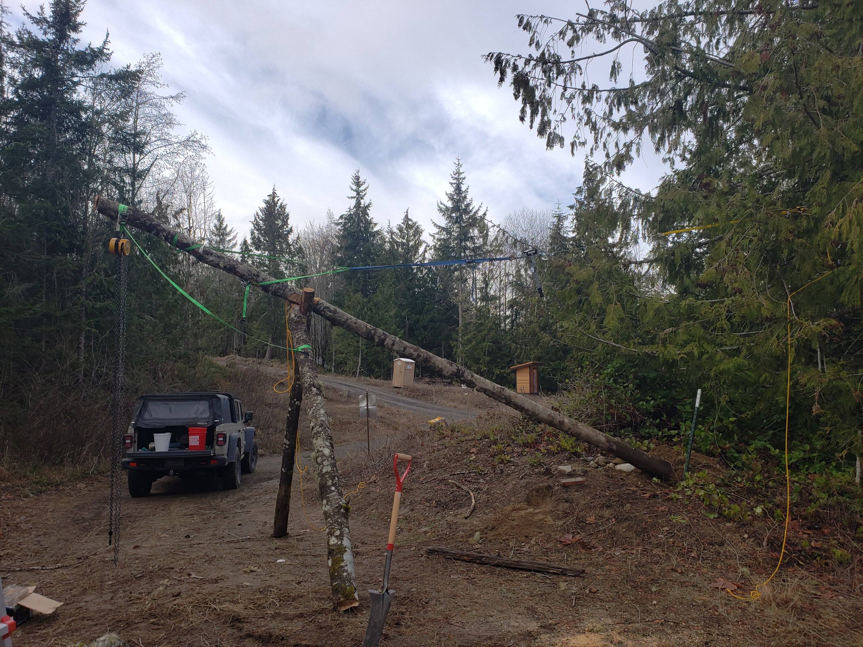

Jeep Gladiator Bed Crane - Harbor Freight 20221217_113416
I ended up engineering a different solution with local materials.
