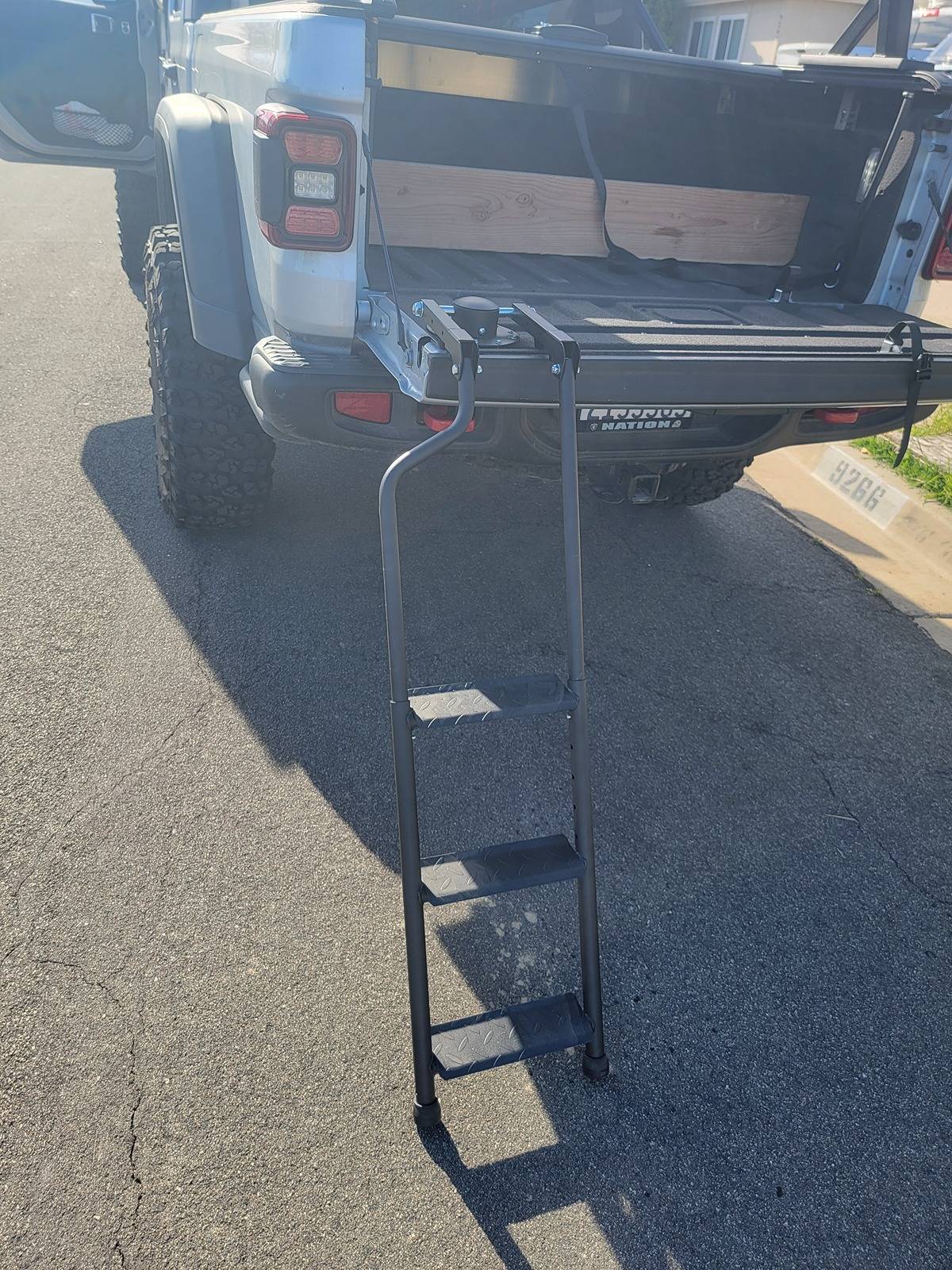

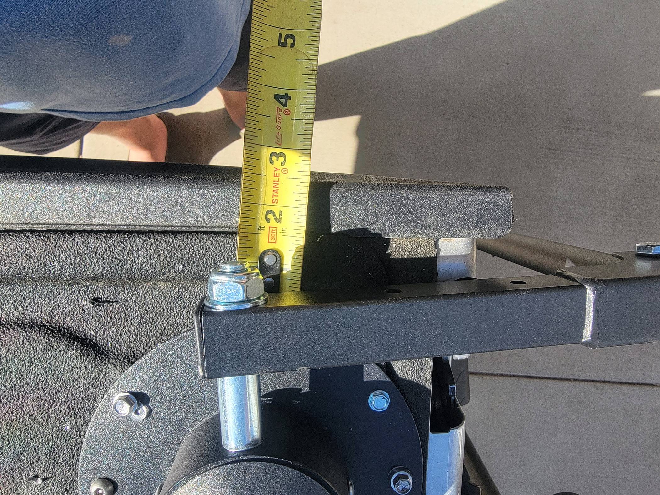

Mine measured 42" to the top of the bed liner on the thickest part of the tailgate. I did the install on my driveway but had to pull into the road to get it flat to ensure it worked....I was nervous about those 3 inches! :CWL:
No need. Works perfectly!

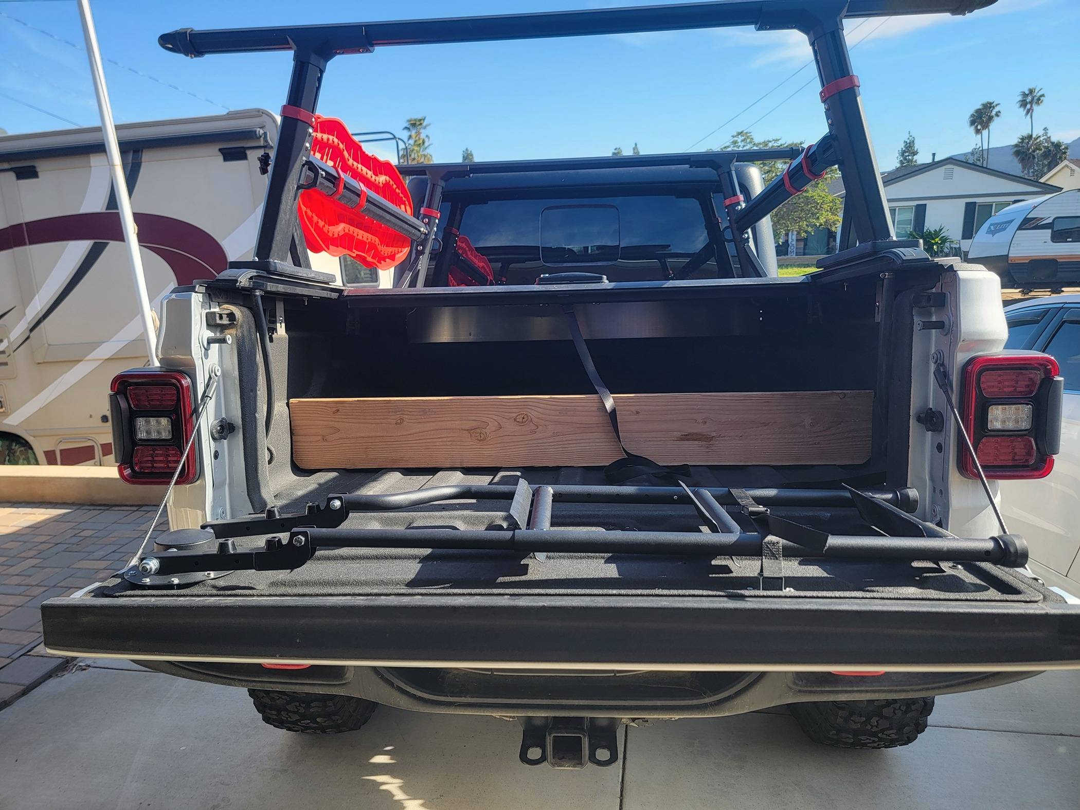

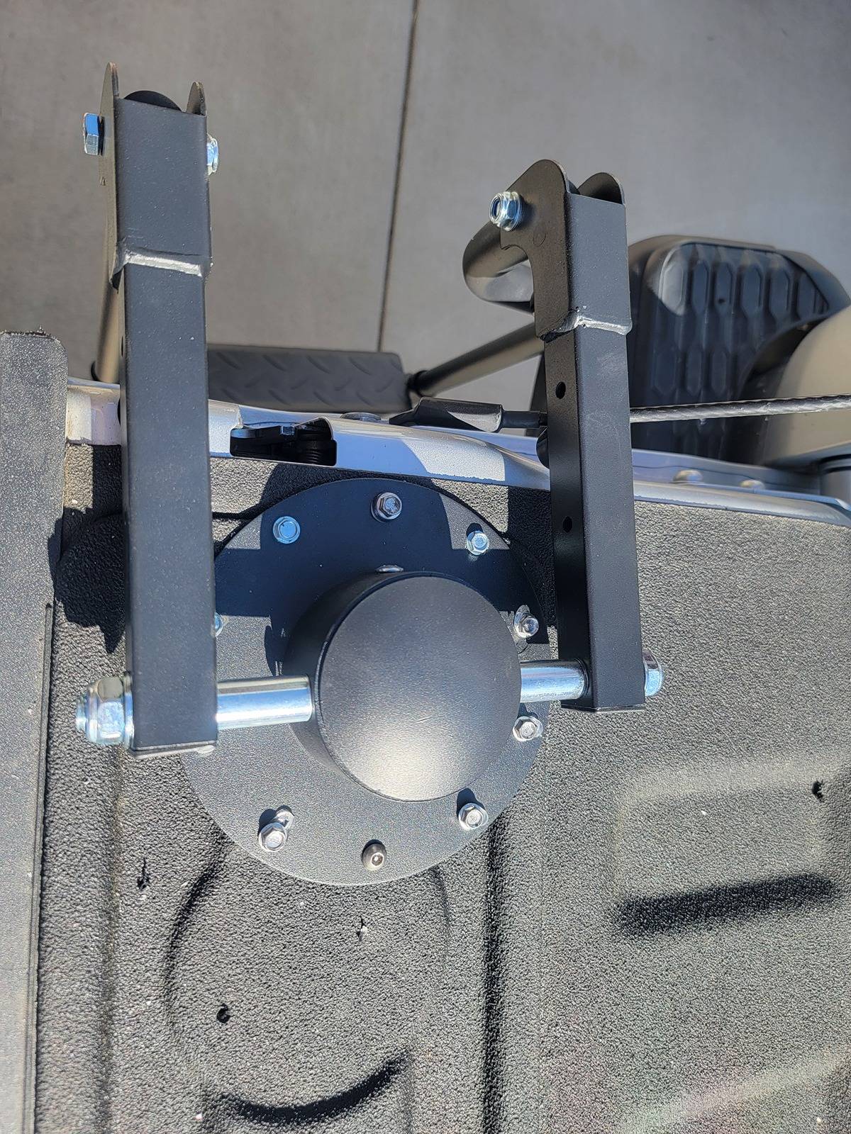

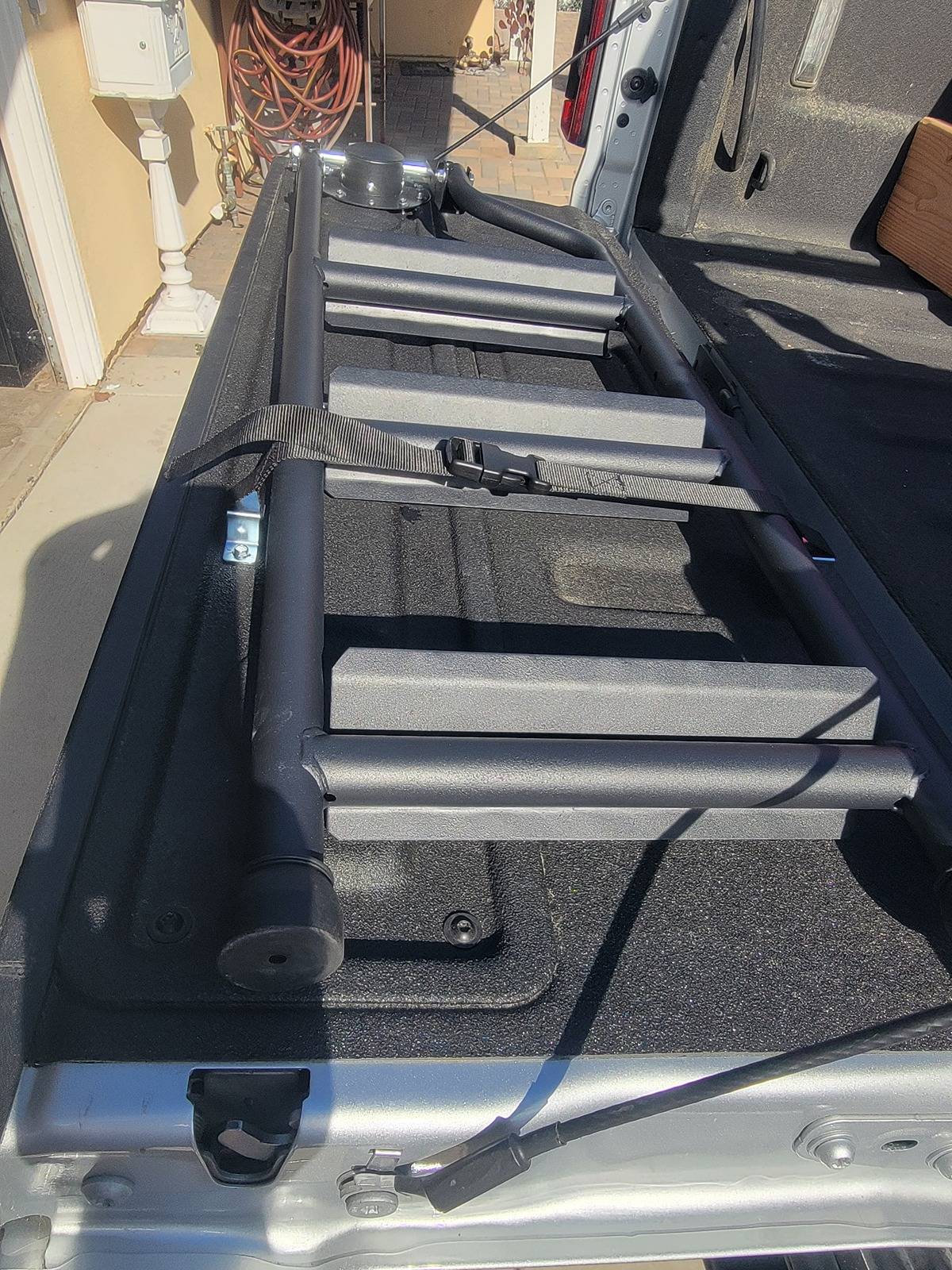

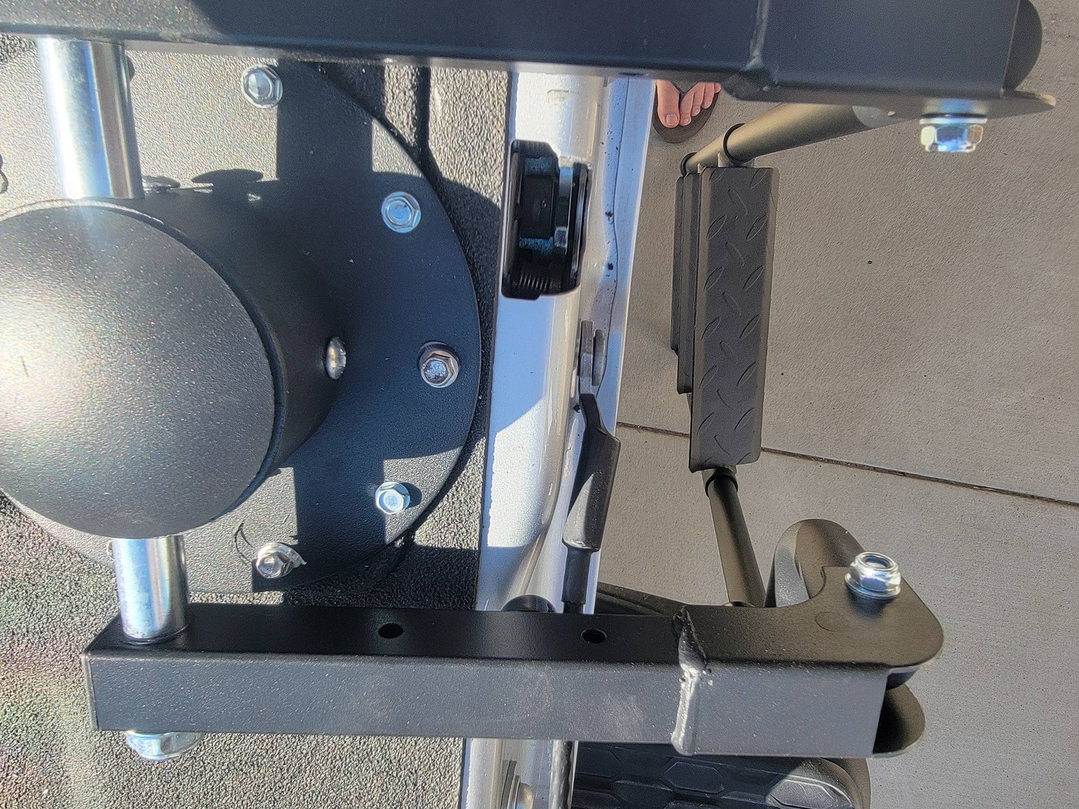

Pics of install to follow. Notes: 1) Don't use all of the factory screws. They are much too long and may interfere with the bed hardware. Especially for the tie down. Really close to the internal hardware. 2) Open up the large access panel and make sure you don't screw into anything. 3) Use my placement as a guide only. Your tailgate may look different inside. 4) I may get some black silicone or some sealant and go over the screws to prevent rust and water leakage....maybe Black Flex Seal? 5) OMG!!! It was the first time that I've ever just walked up into my bed!!! Usually climb up on the bumper or wheel. This think is AMAZING and super sturdy! 6) Pay attention to the mounting area. I have 2 spare holes due to misplacement, so I hope this helps. Oh...and the little crappy washers will get removed before sealing.

Looks like you did a great job !
Are the included screws "self tapping" ? or are they bolt/nut type ?

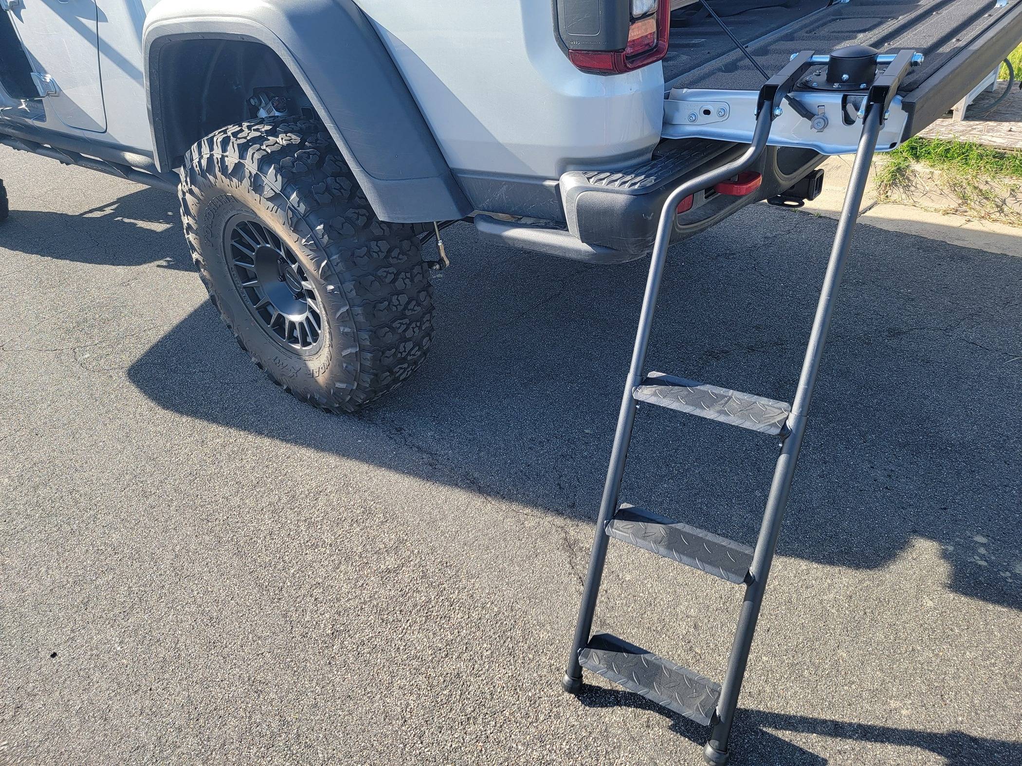

How much of a climbing angle were you left with when the ladder is on the ground ?
When the ladder is deployed to the bed side, the tailgate looks like it angles up due to the ladder resting on the tailgate retention cable... is this happening or is it just the picture ?
IF
It is , do you see a way around it ?
I know ShadowsPapa has a different setup, but I think he made a cut/bracket to avoid it somehow.

Thanks! They are 1 1/2" self-tapping that come with it. I have 12 that I didn't use.
I used 1/2" and 3/4" of my own and one thicker allen-lock type. If I did it again, I wouldn't even use the longer ones that come with it.
2 bolt/nylocks for the legs (13mm).
I added extra blue lock-tight to those, and the large nuts with spacers (19mm). While they were also nylocks, I prefer to also add lock-tight.
I put red on the swivel retaining screws (#2 Phillips)
I never trust that they add enough...nor that they tighten them down. In this case, 2 of the 4 seemed to have inadequate amounts and one wasn't tightened down.
The angle was good. I didn't measure, but I walked up with flat feet and felt that I was going up stairs, not a ladder.
Where I mount it, it barely touches. You can pivot it more, against the bumper or away without a problem. My biggest concern was clearance at the top for my hard tonneau cover.
Looking back at the ways I have had to get into the bed and once atop the roof, this should have came factory! I did make an bonus hole, which I will close when I get the flex seal.
