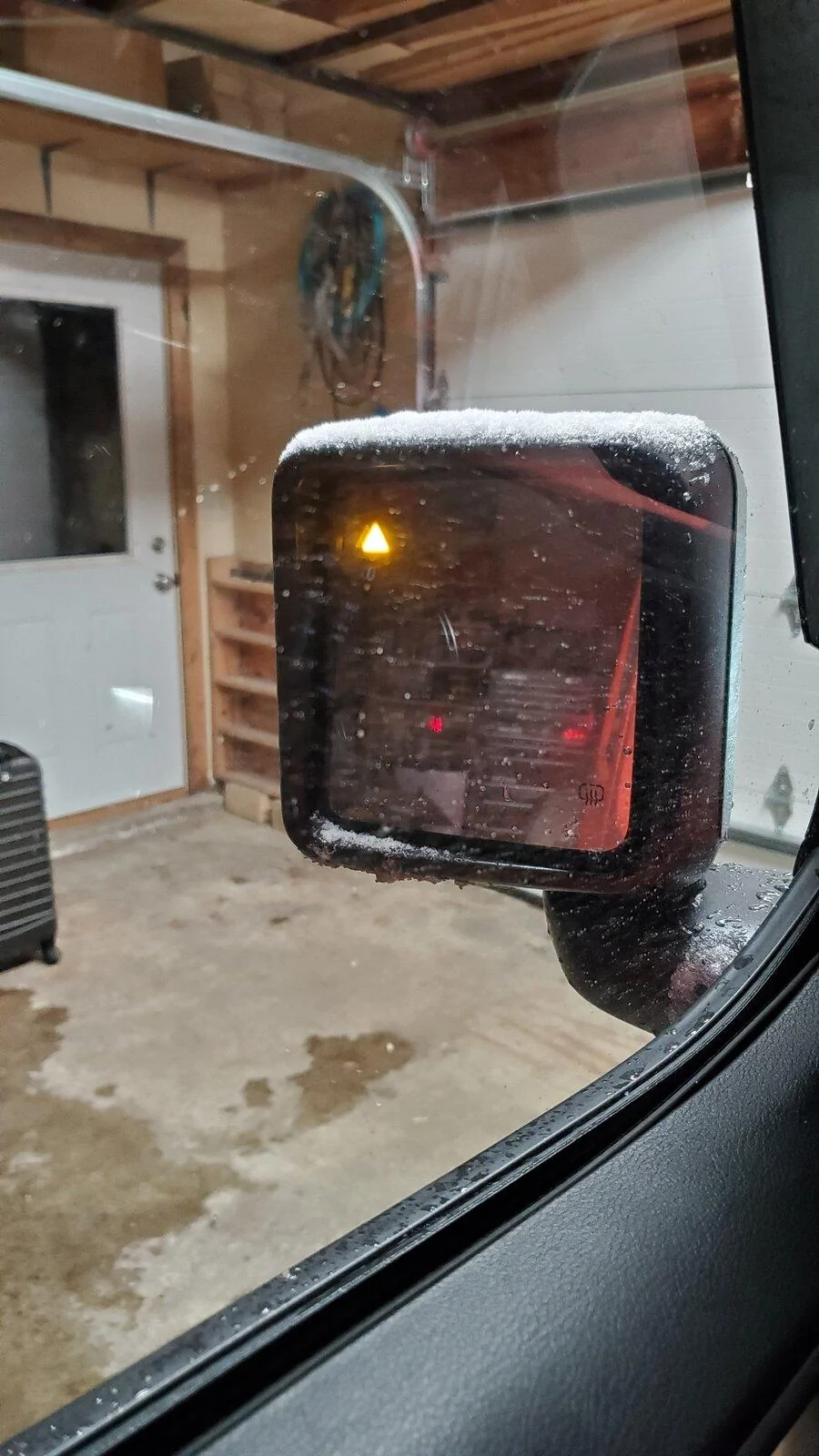

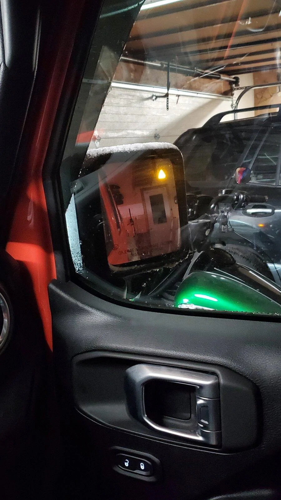

Alright I'm having some issues with the blind spot freaking out.
Short version of the story the lights on the mirrors come on and stay on until the next start up. Sometimes just one light but most of the time it's both lights. It started last year in a heavy rain storm. I took it it the dealer and it all checked out and couldn't be replicated. Tech said next time it happens bring it in while freaking out.

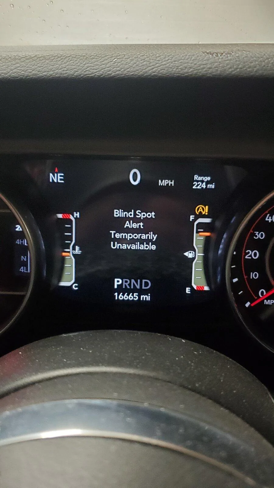

Finally I was able to show them what was going on. I got codes; B25C9 Driver door ajar switch 2 stuck closed, B25C8 Driver door ajar switch 2 circuit high, U140E-00 Implausible vehicle configuration data received and B285f-15 Blind spot warning light-control circuit short to battery open. What my tech is telling me now is that he wants to order a new driver door harness and go from there.
Now I know I'm not the only one who has had this problem. Unfortunately I have seen it before on a YouTube video. Besides the lights I'm also getting Start Stop unavailable and Auto park unavailable. Originally my tech and I thought it was the door pins and we checked that and yes there was a problem there but that was failing the locks and powered mirrors. We got that all straighten out then 4 days later I get this crap.
Any help old be appreciated
