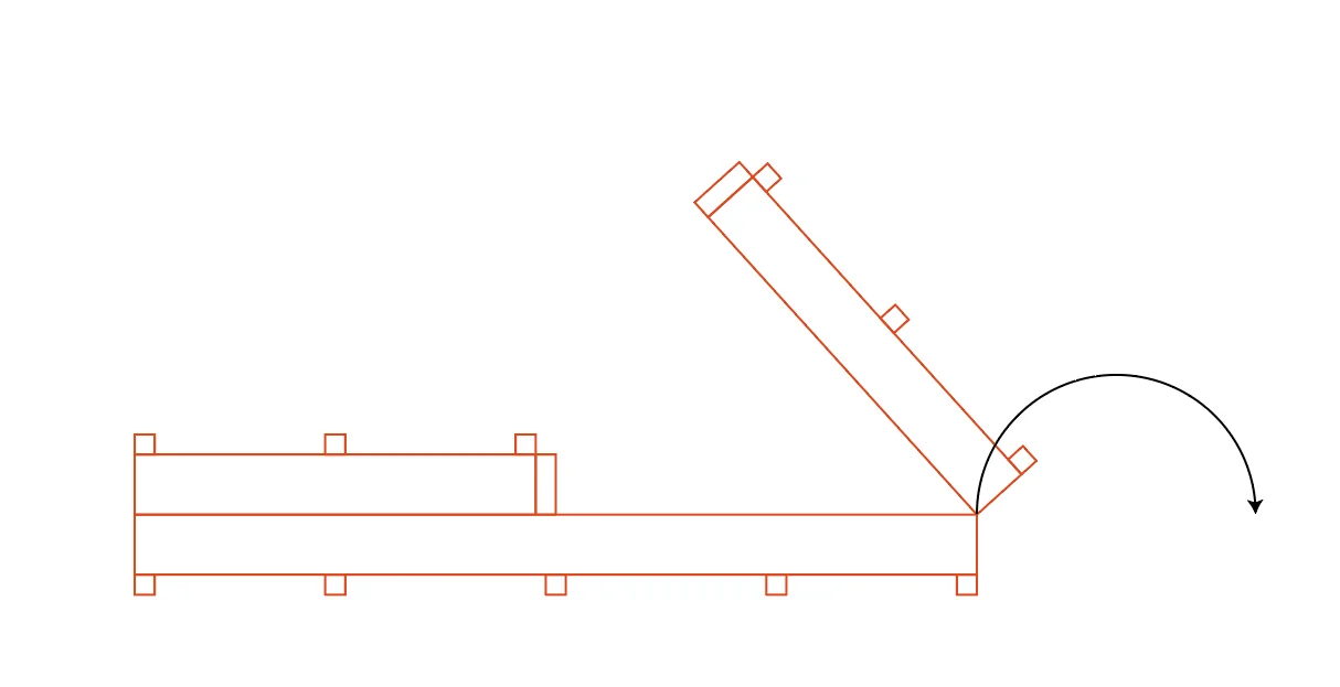

I plan on giving a lot more details on the construction. so in the meantime here are a couple of details that are not shown.
1 right now you are only seeing the framework. this still needs to be skinned. this is why it does not look very weatherproof. I have some interesting materials that I plan on using for that.
2. It doesn't deploy to a tent on a slide. however there is a drawer slide system incorporated into it. Once I get the rest of the assembly together there will be a better understanding of it.
In order to deploy it to a platform it gullwings left and right.
See illustration below.

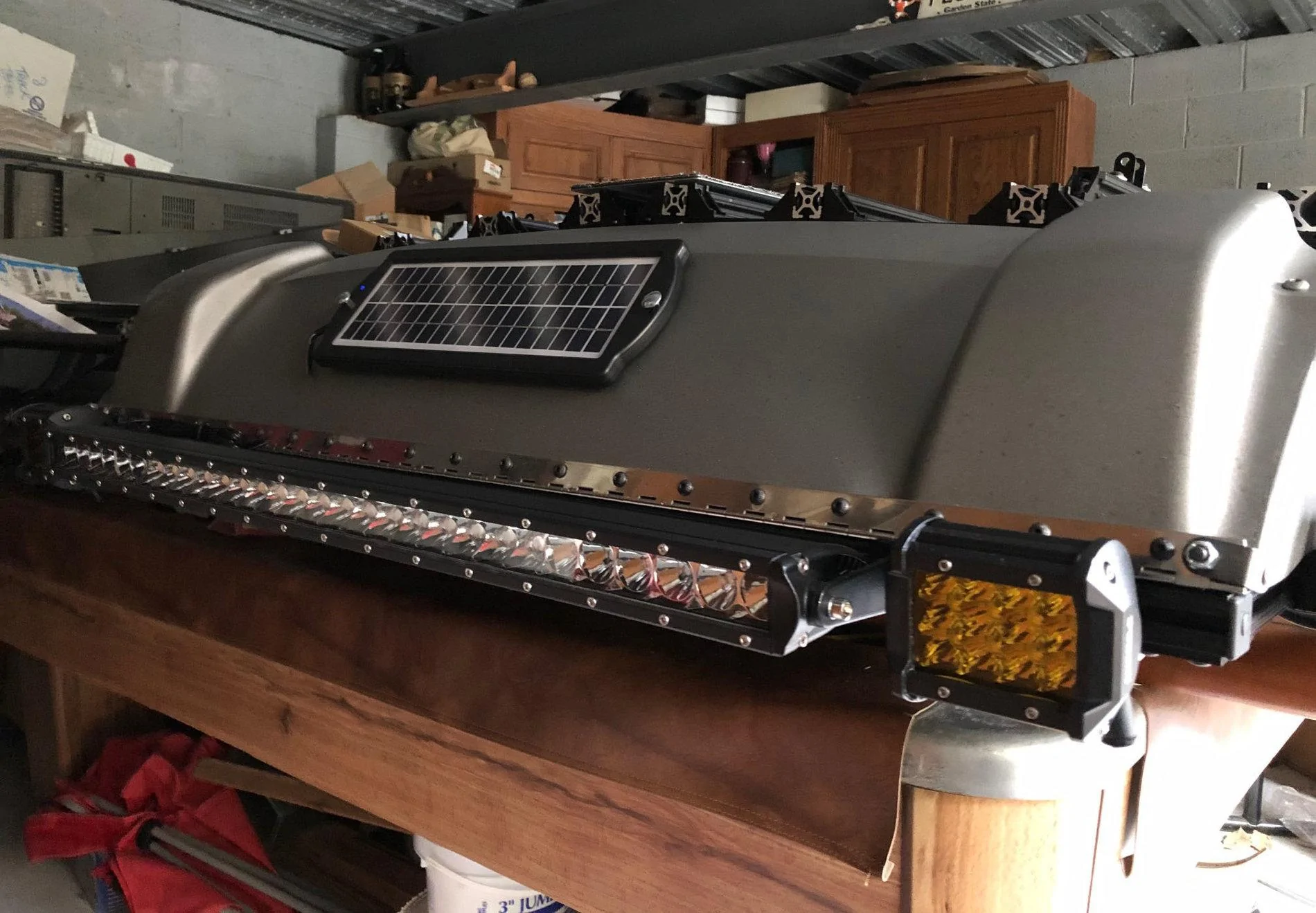

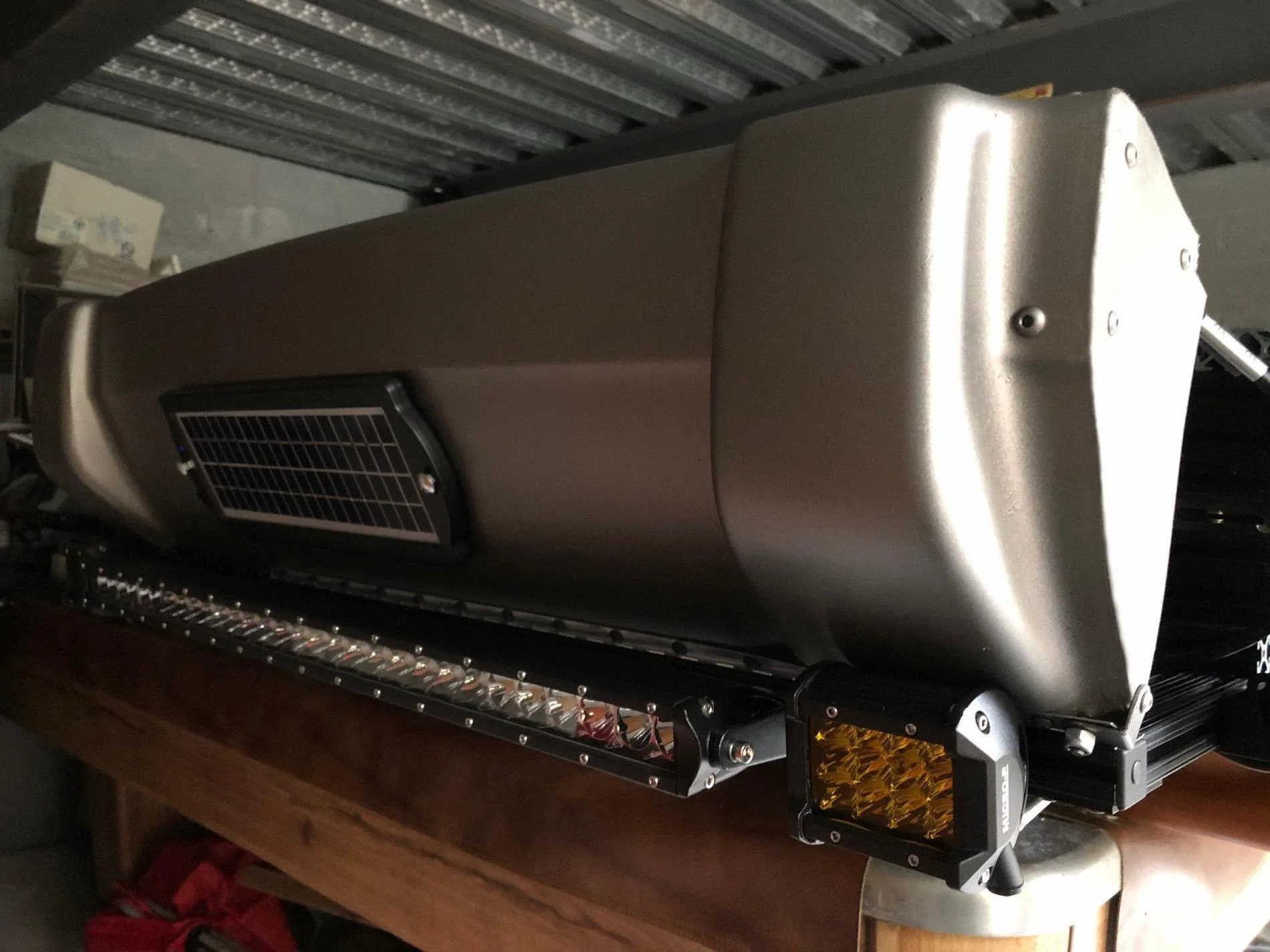

So I got the lighting, solar panel and power control box and airdam
in this weekend. I also have all the aluminum panels cut and ready to install. Still working on what type of battery I will be using. I am hoping to go with lithium ion if I can source one at a reasonable price.
