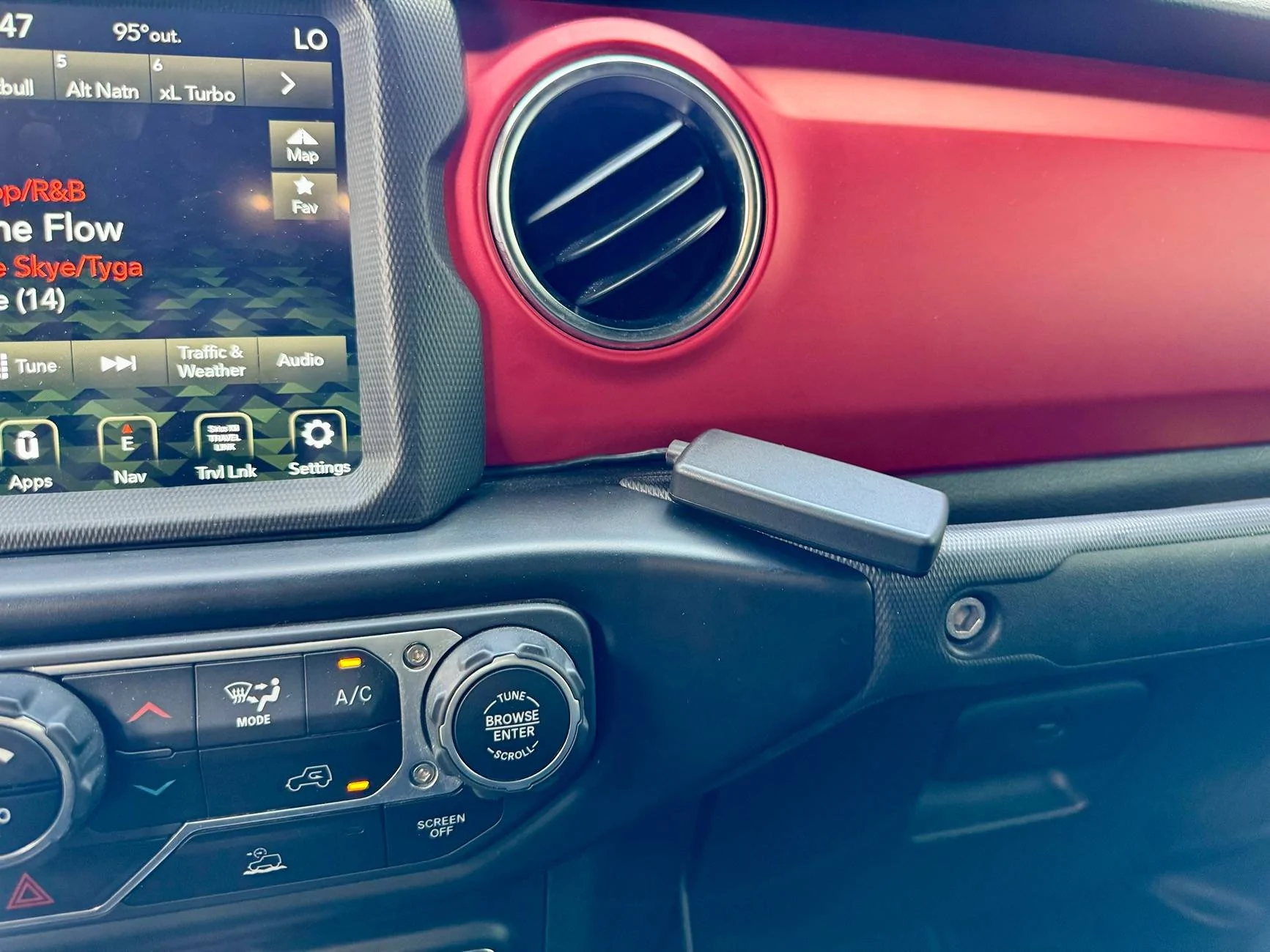

Here is where I put my interior antenna in order to get the booster to work. Booster is finally boosting.
Jeep Gladiator Booster antenna locations that actually work? IMG_4474
