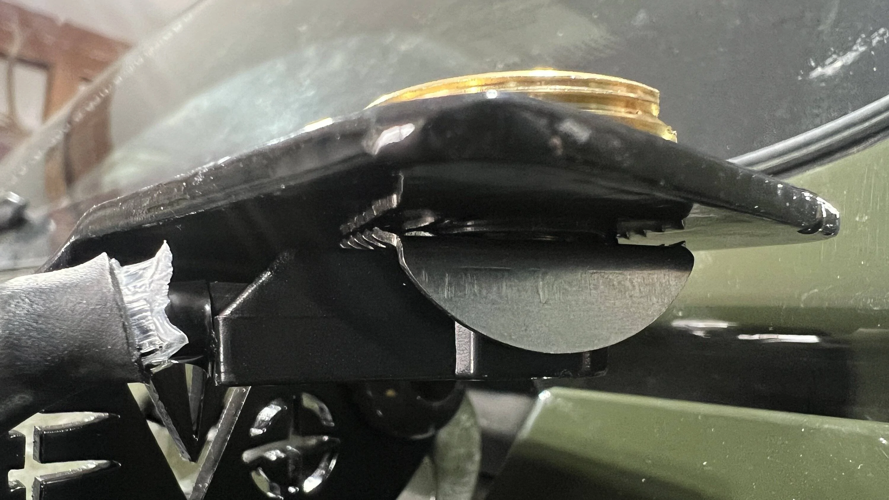

So I got the bracket and antenna on today and as you suggested I first tested continuity from of just the coax, then the antenna and then the coax and antenna together. I probably should test again now that the coax is routed to the final destination.
The coax and antenna combination varied between .01 and .03 and I think that was just because I couldn't get a good solid connection on the antenna itself with the multimeter leads. The antenna is coated in something black.... and the tip had a rubber covering, so I pealed that off and found some fresh metal (assuming it is stainless steel). There was a little gash up there probably from the manufacturer process that showed just a touch of bear metal. So I think the lead just couldn't touch the metal fully to have a good enough connection for no resistance. All the components separately measured flat 0
However, one thing I found interesting is that little metal bracket with the teeth on it underneath the bracket isn't touching metal. I'm not sure if it is supposed to or not? I did tighten it down quite well, and probably could go more but it doesn't feel right doing that. It seems the plastic isolator is what is preventing it from crushing into the metal bracket.

On the ohmmeter test if you measure less than an ohm consider it a short. When the antenna is screwed on you should show a short between the whip and coax center conductor. My test was to slowly unscrew the antenna and see how many turns you can go before it looses continuity between the whip and center conductor. If it goes open within a half turn that means the center pin of the mount could be recessed too much and not making good contact with the antenna. If you can unscrew several turns before loosing continuity its good.
The brass threaded part of the mount should have very good continuity to the metal bracket which should have good continuity to the sheet metal of the vehicle around the bracket which is part of the ground plane. With the coax disconnected from the radio you can place the ohmmeter across the brass threaded part of the mount to a screw or bare metal spot on the vehicle near the mount. It should show a short or .2-.3 ohms if that is what your meter reads when the leads are shorted.

I did measure the depth of the inside of the antenna base, and the protrusion of the center pin above the bracket. It looks like the cetera pin will be compressed about 1/4 of an inch. I dont have anybody to help me so doing the unscrewing method would be difficult.... But it sounds like I have a solid connection from the tip of the whip to the end of the coax on the radio side. I just can't confirm with certainty how much compression the center pin on the antenna is getting.
But going back to the continuity between the metal bracket. Referring to my picture above, just to clarify I understand you correctly, if I remove the antenna, and place one lead on the large threaded brass portion that goes around the inner brass center pin, and another lead on a ground - there should be continuity? I will check that tomorrow, but based on my picture it sounds like I don't have enough compression of that large brass threaded.....puck I guess I'll call it... so maybe I need to tighten it down a little more. It does touch the bracket - of course the bracket is painted. but on the bottom side, those little 'teeth' really aren't even touching the bracket at all, but the inner 'smooth' teeth are. I'll try to draw on that picture and re-post

Jeep Gladiator GMRS / CB antenna locations - near A pillar or mid point on hood IMG_9883 copy
in red are the teeth that are not touching.
in green is the half moon thing that still protrudes that does seem to touch.
the brass threaded portion on top also does touch.
I probably would need to bend those teeth up more if they are supposed to be digging into the bracket.

There should be continuity between the threaded brass part and the mount and the vehicle body.
