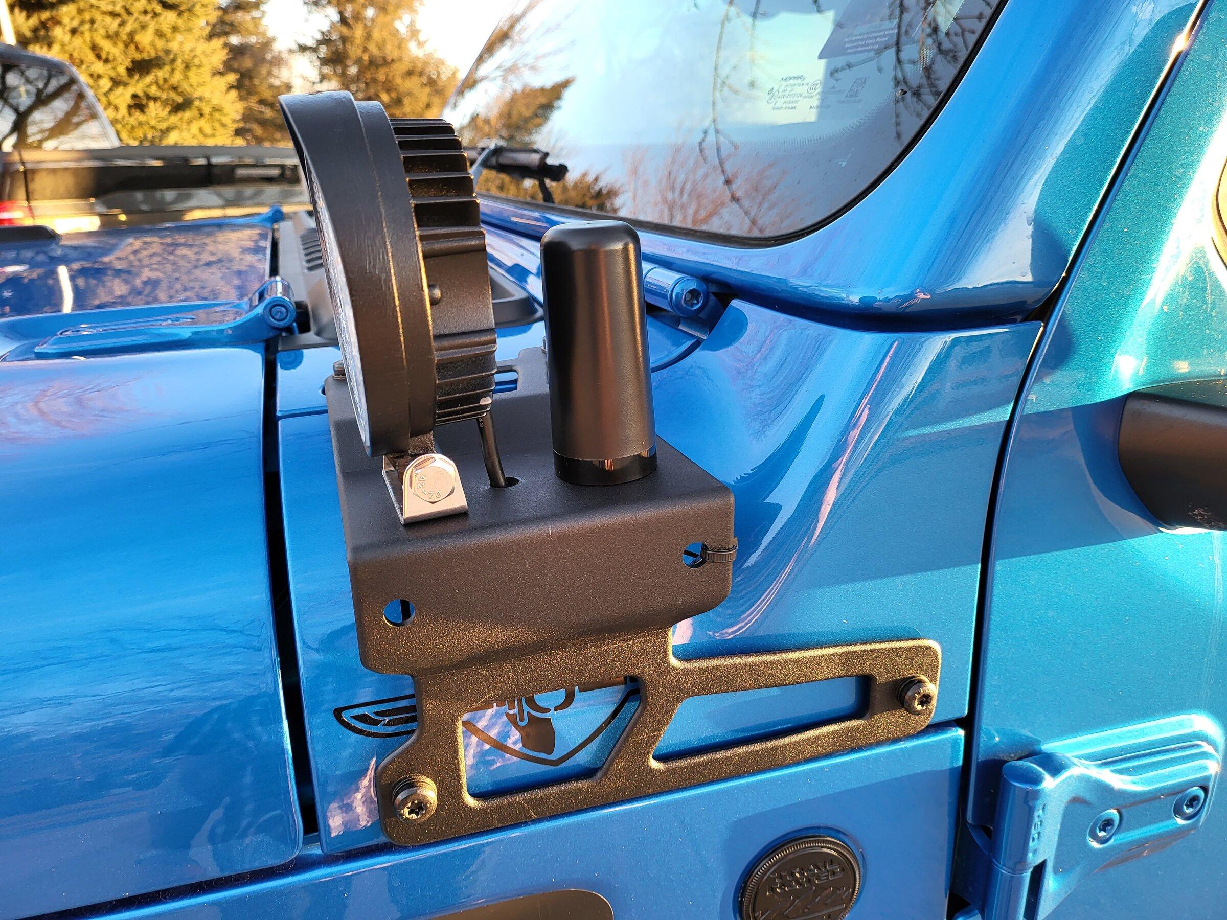

I am currently using those brackets with a GMRS antenna and signal is pretty good. I also have a light right next to it so that doesn't help at all. In the future I will probably get a taller antenna too improve the signal.

how did you route the coax?

I ran it down the inside edge of the cowl and then through the conduit/channel at the top of the firewall over to the passenger side. From there it goes into the cab through the grommet that one of the main harnesses runs through.
