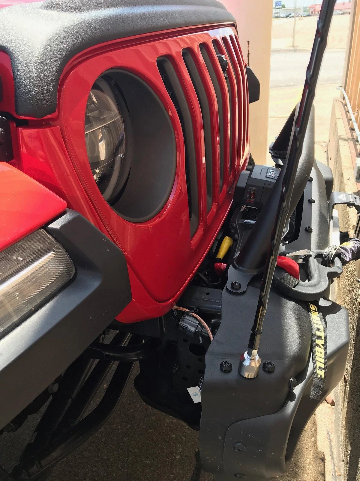

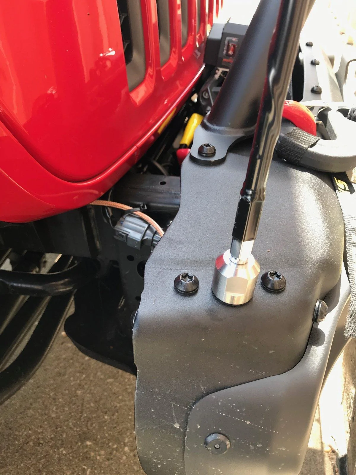

Well I have it installed. Still need to tune to make sure I have a good ground and this will work. It is angled forward a bit but if it works, that is good as it will be much harder for it to smack the hood!!
hey I know this is an older post but after doing some looking around this is my favorite no drill option for a CB antenna would you be able to provide a parts list like what size antenna you used and what is the adapter you use going from the bumper hole to the antenna and how long of a cord do I need to go to the interior ect. thanks

I used a 5’ Firestick antenna. Can’t remember what the adapter was. I think you need about 12’ of cable.
