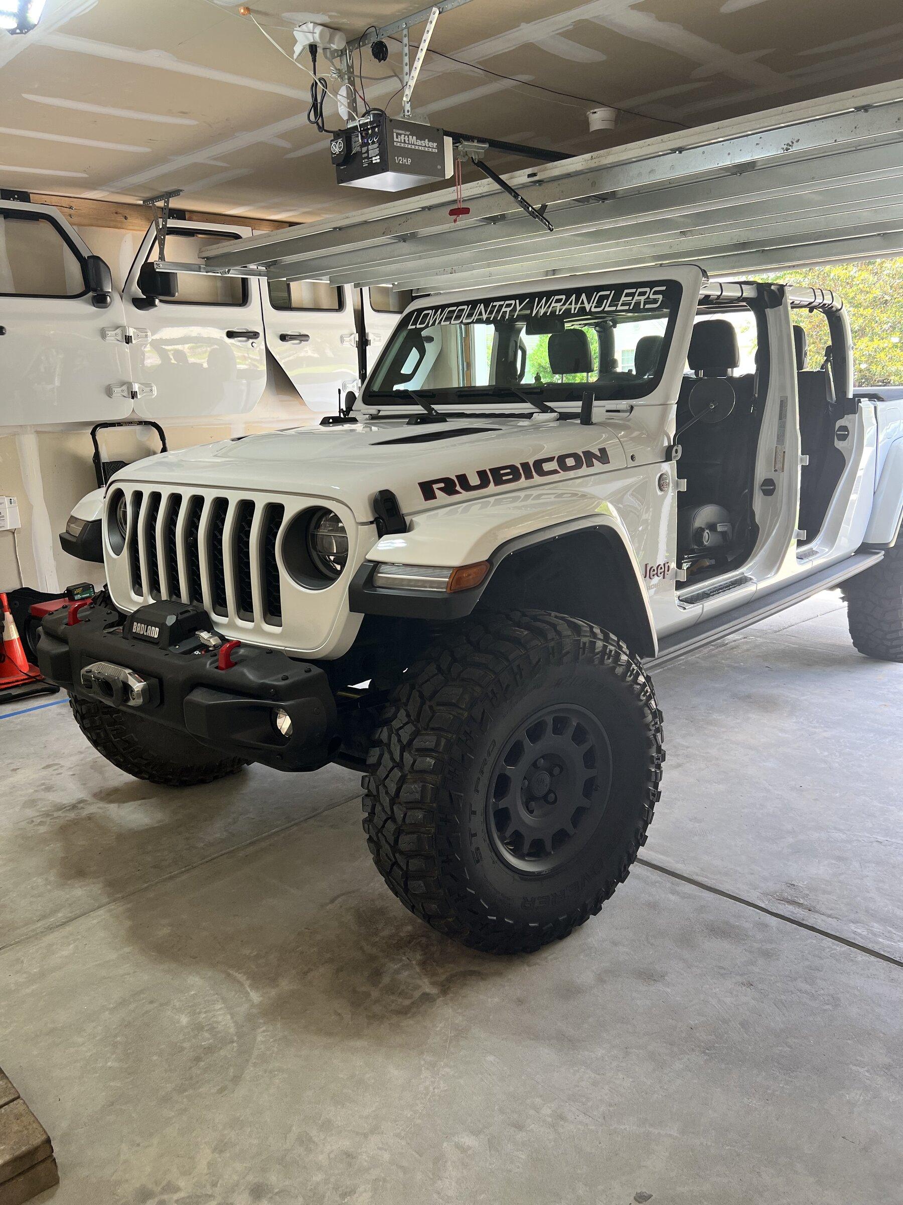

2022 diesel Rubicon
Bedliner, tint, spacer lift, Mopar bead locks, warn vr10s, warn plate so far
Did the warn winch you installed fit without any modifications? The winch plate provided worked?

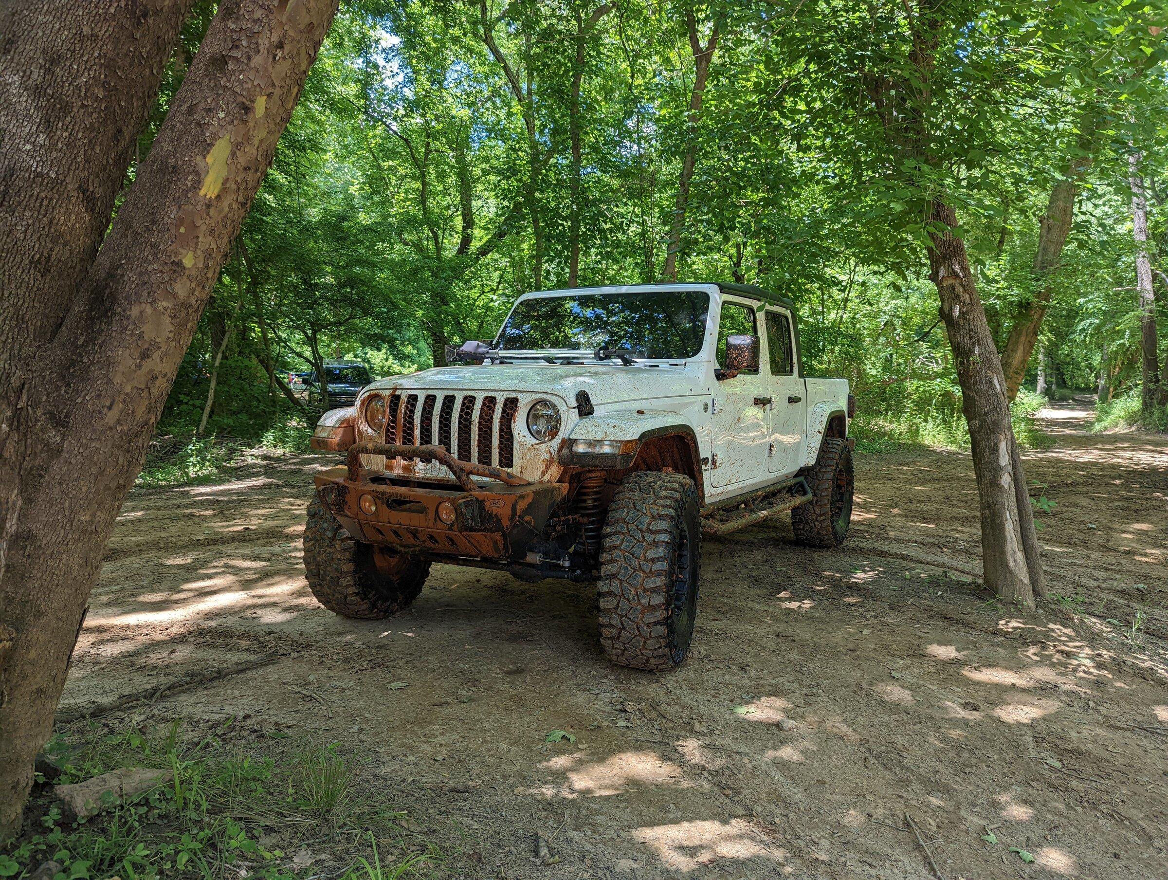

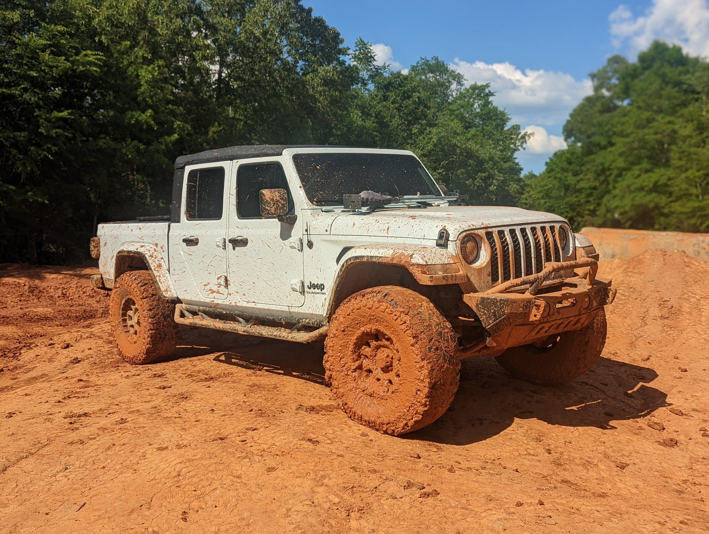

Well...
First time taking it trail riding not bad did really well for the small amount of work I've put in to it. Super impressed.

@ChillxPoint The Warn VR fits perfectly as does the Warn winch mount. I have the same setup on my JL. My only complaint is that the two bolts that hold the fairlead to the bumper are too short. I had to source longer ones for both installs.
When you say the 2 bolts that hold the fairlead to the bumper what do you mean? The bolts that come with the winch? Sorry im new to all this.
The fairlead is where the winch line exits the front bumper. There is a bolt on either side that secures it to the bumper. i have found on my last two installs that those bolts that come with the winch plate are about 1/2" too short. Not a huge problem but Warn should have addressed it.
