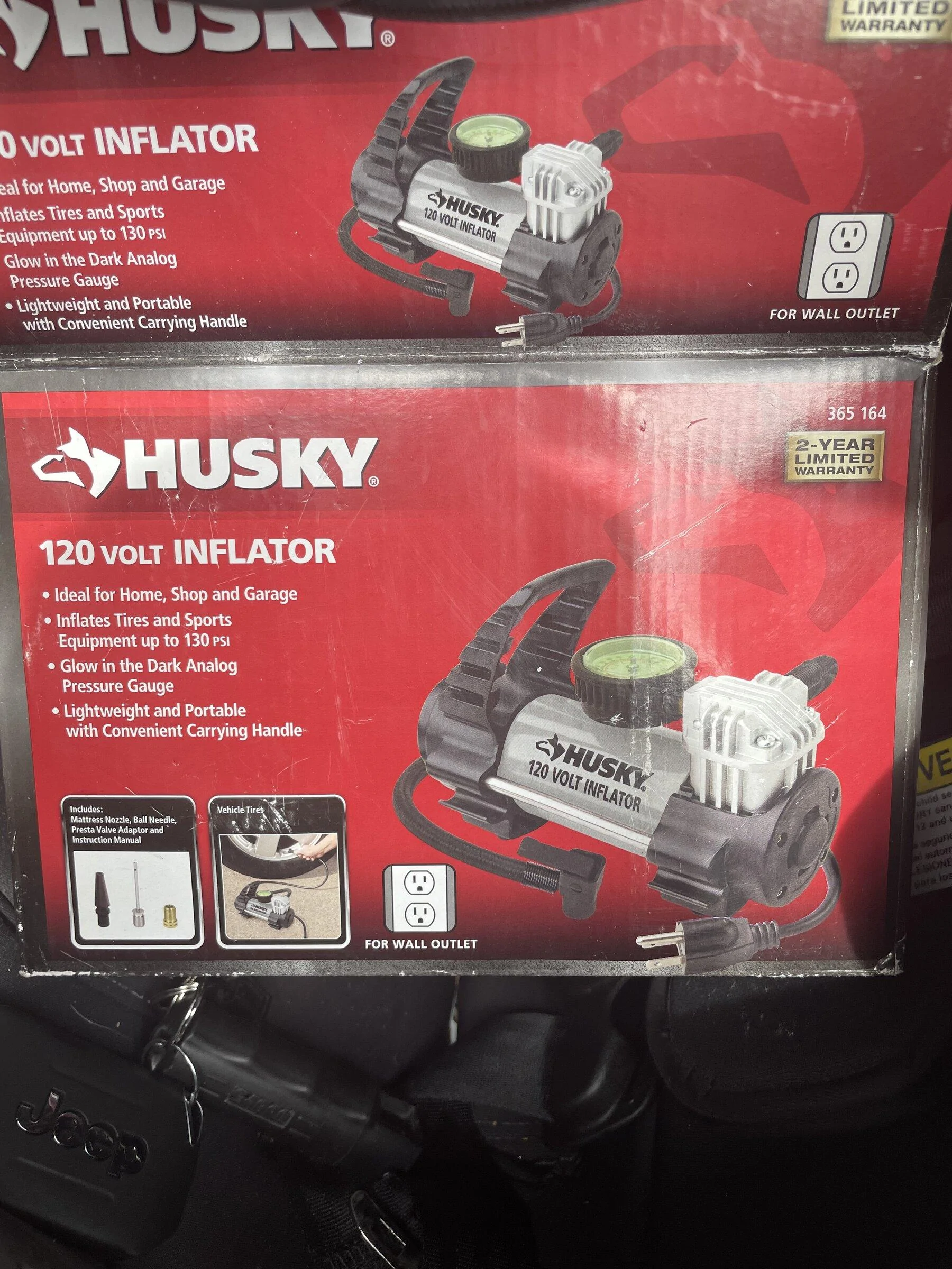

Am I going to blow up the wiring if I try to run this from the cabin plug? Or will it just straight up not work?
going on a trip this weekend and gas stations I stop at NEVER have inflators.
Jeep Gladiator Cabin 115v air pump question CD5ADD9C-A7CA-429B-9545-9EC499B1BD61
120v/1.1A/60HZ. Can’t see wattage anywhere on it. Any help greatly appreciated!

The math says it will work, 120V at 1 amp draw is 120 watts.
You won't burn anything up, circuit breaker or fuse will pop first.

Thanks for the reply! Yeah I know zero about electronics and don’t fancy having a dead truck in the middle of nowhere haha
