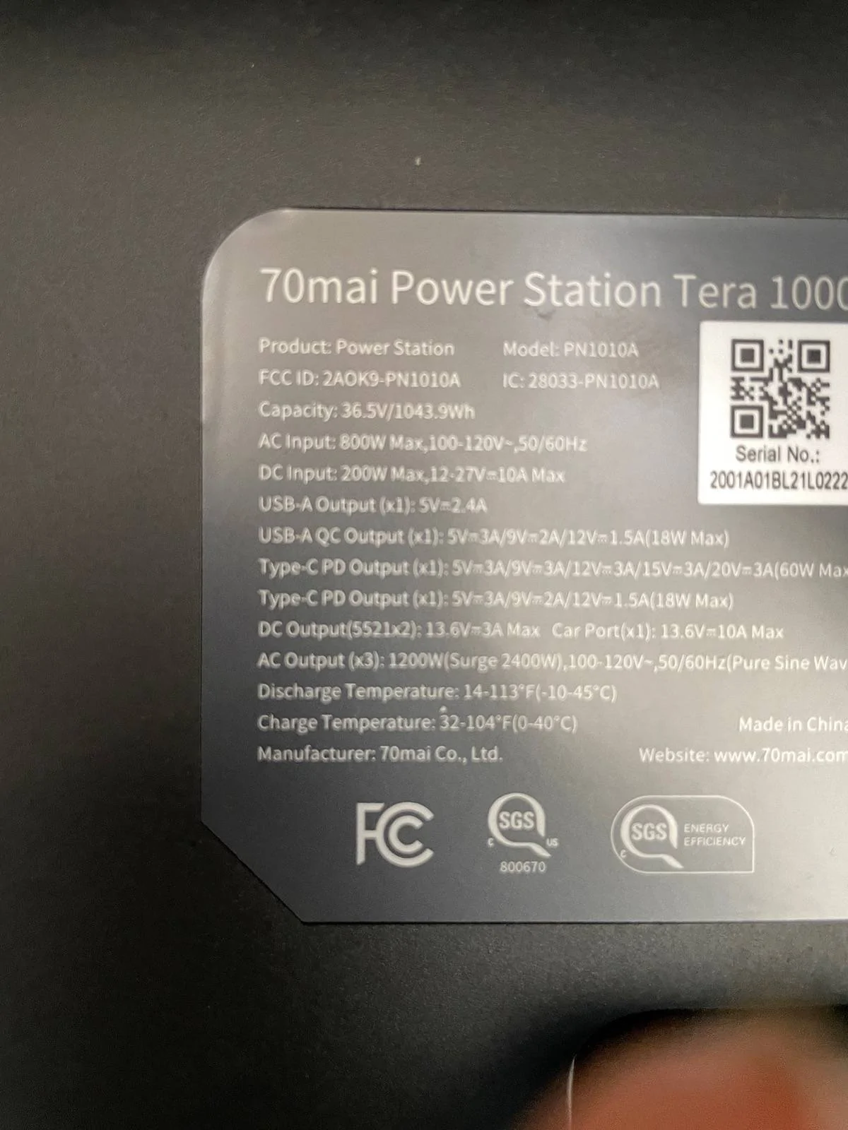

Power stations that have an internal power brick require a pure sine wave regardless of the draw.
Shouldn't require pure sine wave - very little actually does these days, especially power supplies that step down the power and rectify it for storage in a battery. (power brick is outside - internal is likely on a PCB)
There's really little reason for there to be a difference in which waveform they'll handle. They store power in a battery and step it up or down as required for the various ports.

Whether the powerstation's charger agrees with MSW depends on the vendor really. Some deal ok some don't. There are plenty of threads, examples, and videos that show it.
Thx for this. I’ve run into this issue with a Anker C1000 solar generator.
Searching for a fix now. What solutions have people found?
