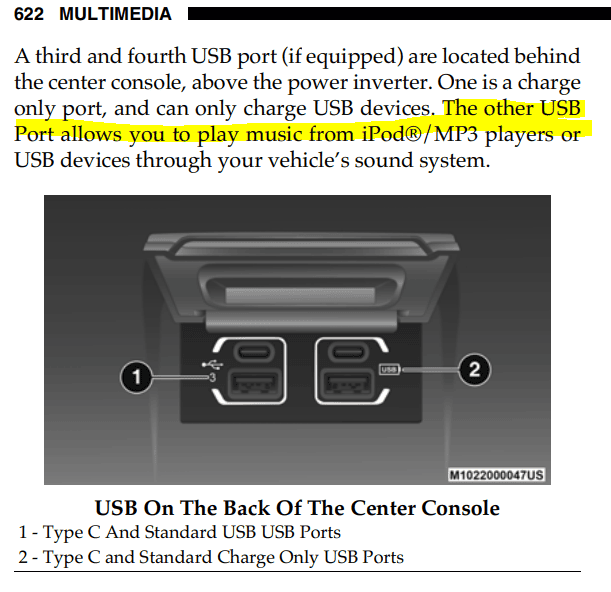

If you mean the ports on the back end of the console facing the rear seats - wrong. It depends on the port you use. I can plug my phone in back there and it jumps into android auto. If I don't want it to do that I have to choose the other port back there.
The port inside the console is absolutely also an AA port - I've put a USB stick in there. So - since it's right back there it's obviously paired with one of the other ports on the very back of the console. I had my phone plugged in back there with android auto active. I know it works as it pisses me off trying to connect when all I want to do is charge or my wife plugs her phone in back there and it wants to connect to her phone.
One is connected, the other charge only.

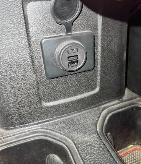

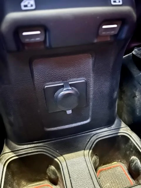

This is the route i took:
- 12V Dual USB Panel
- 12V Power Adapter
About $30 and 30 minutes to install. Easiest mod I ever did
Any pictures of using that 12v adapter. I can’t seem to find any decent pictures on how it gets connected. If my leads fall through on the factory option I might end up with something similar. Though probably 2or 4 USB’s and 2 12v plugs.
Thanks. I'll remove my earlier post. I just read the manual and must have mis-read it.
248
40,497
54,067
That's easy to do - I KNEW mine did android auto and took me a few minutes to find it in the manual. I recall as I was really annoyed at the pop-ups when my wife plugged her phone in thinking she was just charging it while she played her words with friends game.
I move the cord to the other port back there and it was fine. I then reminded her that 60% was not a dead phone battery and she could still pay her game but she's a stickler for keeping her phone above 80%. She freaks if it gets below 50 like it's some emergency.
here’s a link to the instructions.

Why couldn't you just tap into the power for the power windows?
I hate T-taps. If I want to remove it down the road I dont like having cut wires. The more I can use factory plugs/adapter the better.
There is a harness available that connects to the back of the 12 volt outlet on the center console and provides a power tap. There are also the two 12 volt hot wires available under the dash, if the truck has the factory installed AUX switches.
