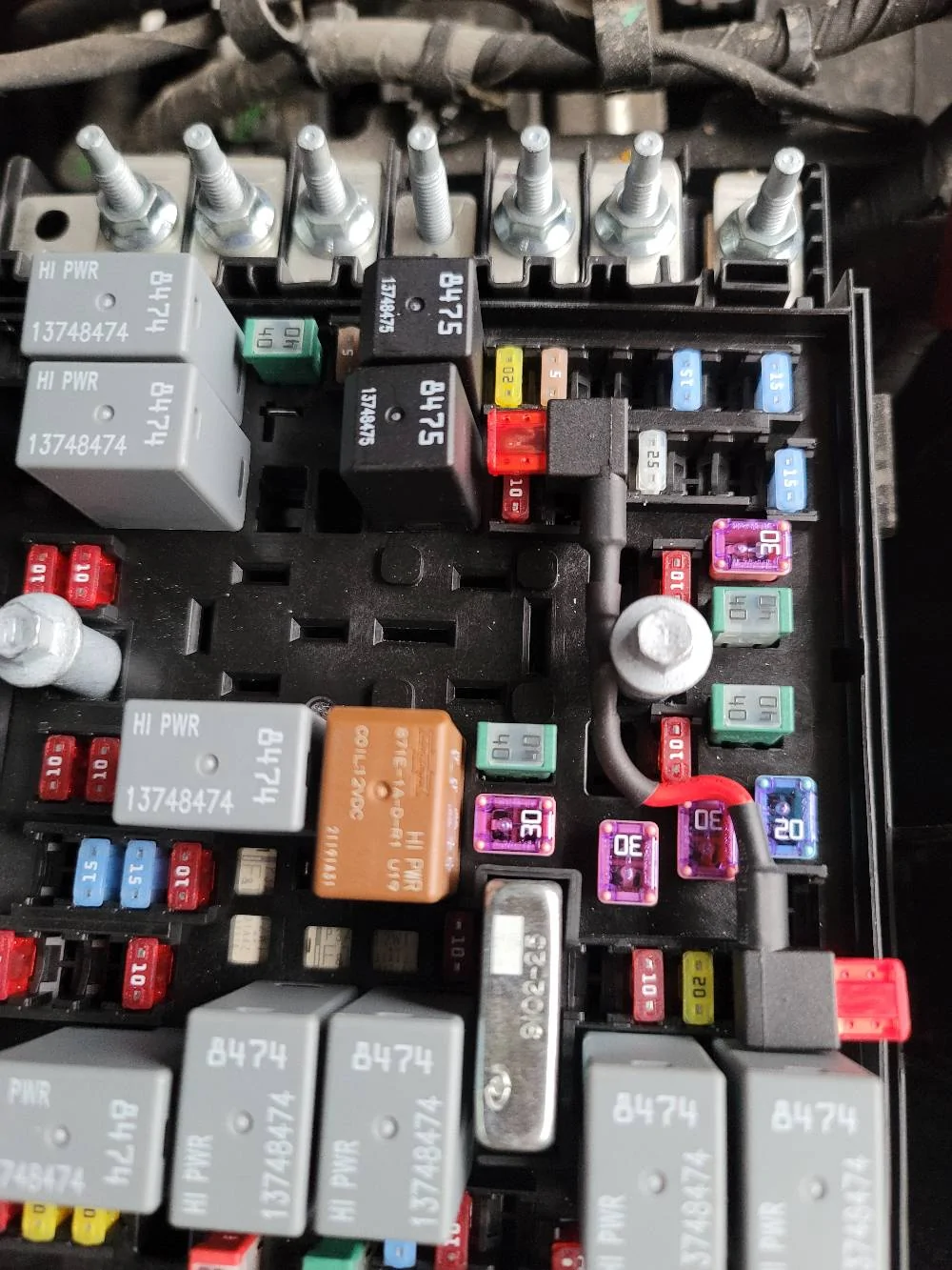

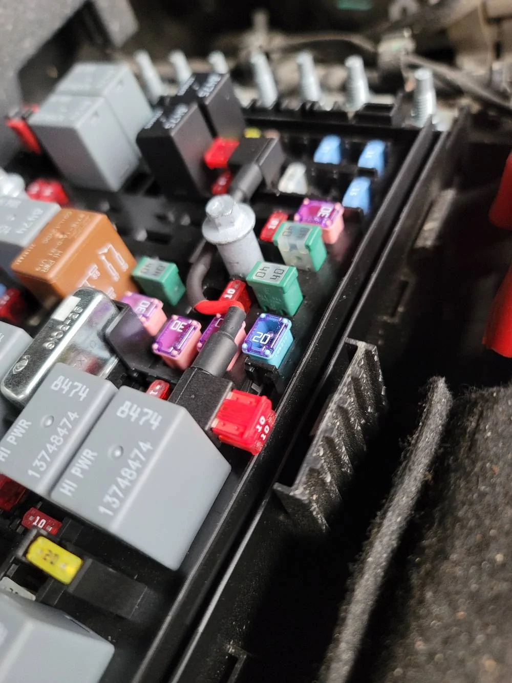

I have a 2021 Mojave, and I ran into the same issue. The F102 fuse was not supplying power to the USB port in the center console. I plugged in a USB powered light into the center console USB port and started pulling anything in the fuse list with "USB" in the description. It turns out, at least on my Gladiator, that the fuse supplying power to the center USB port is F11 - UCI Port (USB & AUX).
I shortened the jumper that I made from two fuse taps (as suggested by @landonbour ) to run between F53 and F11. Worked like a charm. Pics of the jumper are below.

Just wanted to add, this was the same scenario for my 2021 JTR.. made the change today, and it works fantastic.
One thing to note for folks, is that if you use remote start, it actually doesn't seem to activate this circuit, until you actually press ignition, too... So no worrying about your phone redirecting to Wireless AA, if you're inside and letting 'er warm up.

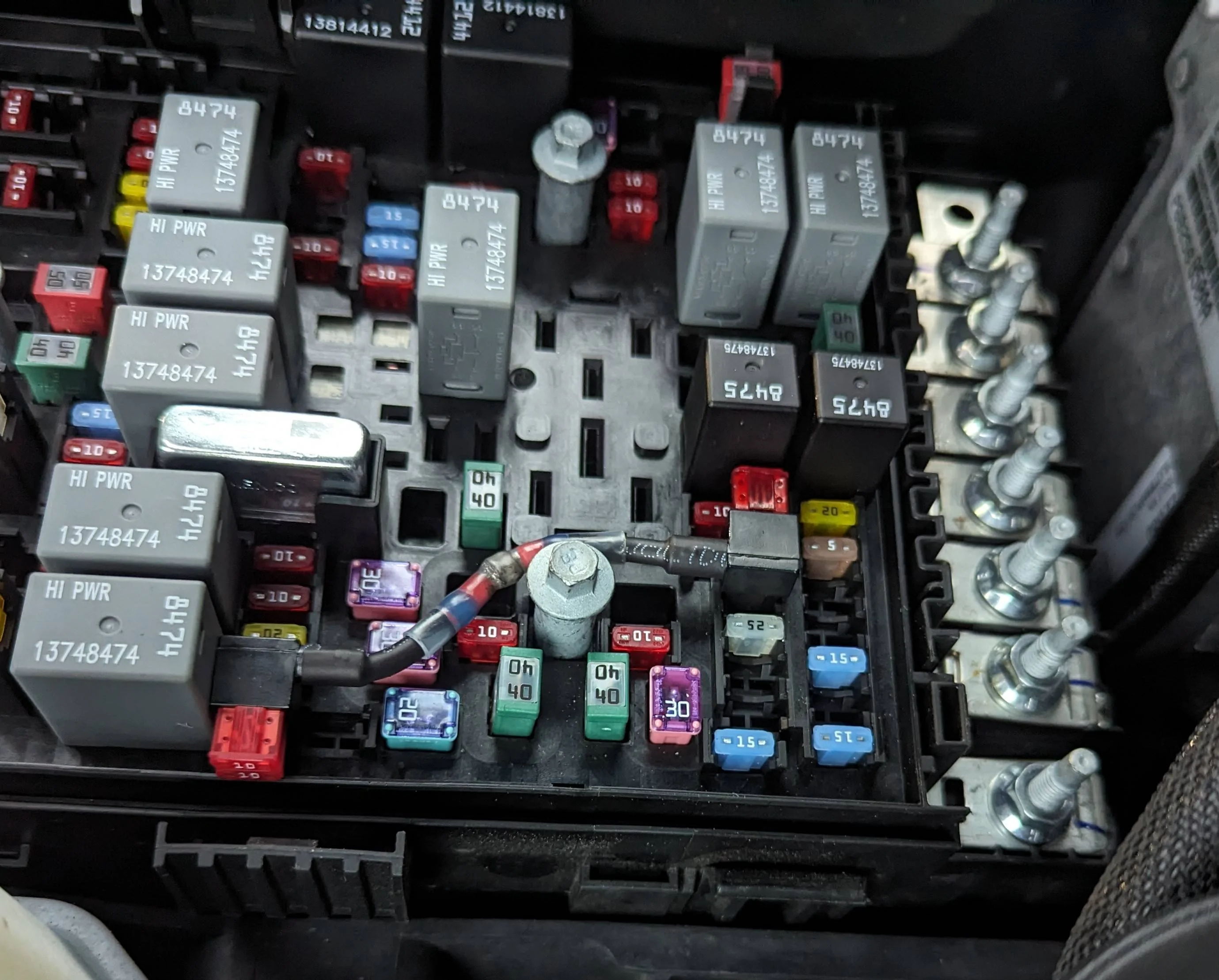

Just another data point for this thread. 2022 Rubicon and my center console USB also was protected by fuse F11. Mod works great as long as I targeted F11 not F102.

gents when you made the jumper is it only going to the load side of F11? Meaning did you cut one of the prongs off so it only makes contact on that side? Have a 23JTR that will eventually make it to me and use the Motorola AA adapter in my current vehicle. having power switch off when i open the door will save my phone battery from doing weird things lol.
By using the dual fuse system, we plug both sides in, but don't bridge the connections, when we leave the power fuse out on the one side where we only want power to go.
Note: get a test light. Helped a friend do his the other day, and his 'hot' leg was actually the opposite of mine. If we hadn't tested that out with the light, things could have gone badly.

2023 JTRD. USB port in console gets power thru F11. Motorola AA adapter always looking for signal. Installed jumper as described by others tapping into F53. Works awesome . Port has power until I open the doors.... vs the old way of adapter staying on and draining my phone battery when I got too close. Thanks for this solution.
