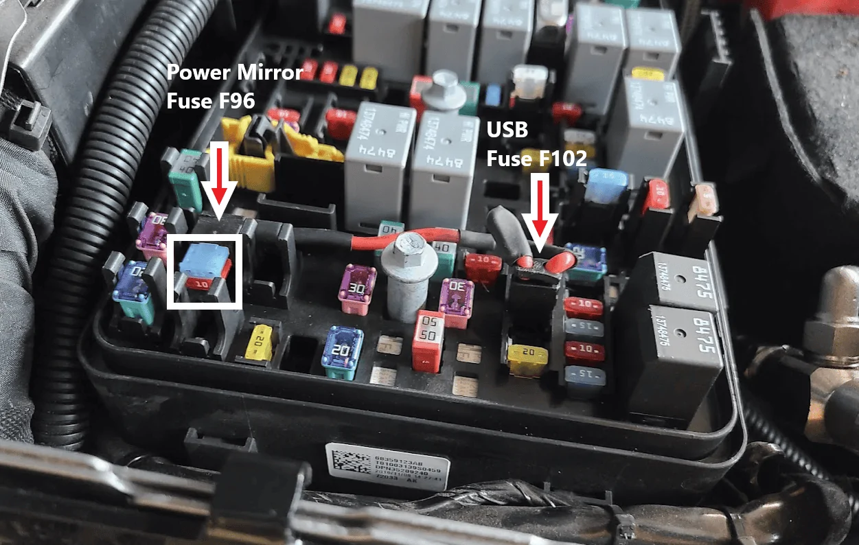

I was not fully understanding your description of how you wired it. If you could post pictures of which wires are connected and go to which fuse slots.
The most recent picture is really the best to do this with. For reference this picture of the fusebox was taken from the passenger side of the truck. The windshield is to my left, front grill is to my right.
F96 (left side of picture, firewall side of fuse box) is the power mirror fuse. I installed the fuse tap on this fuse location. In the white box are the two fuses installed in the tap, the top is the blue 15A that goes to the USB circuit and the bottom is the red 10A for the power mirror circuit. I connected the lead from the fuse tap to the "right" or vehicle forward side of the USB fuse location F102.

It is absolutely critical that you have the F102 connector exactly like I have it in the photo above: the firewall side of that fuse connector needs to remain unconnected to anything else. You want to supply power to the forward (right in the photo) side of the fuse connection only. Otherwise you'll have constant power backfeeding through the fuse tap to the ACC powered circuits. This will likely blow the 15A fuse immediately.

Thanks that is really helpful and clear. I will have to try this when I get a carplay adapter.

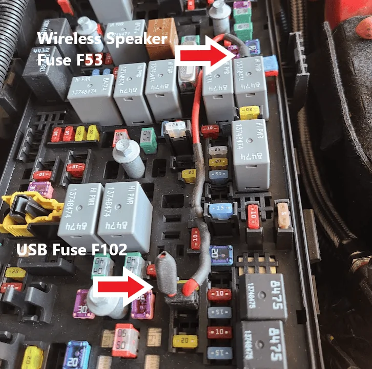

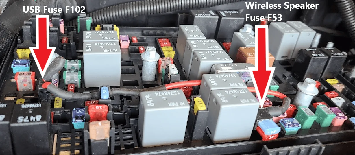

So I discovered today that if you take the doors off, this solution will stop working because without the doors the Jeep doesn't send power through the mirror circuit. Makes sense, since with the doors off the power mirrors are gone. That was just something I didn't consider when doing this the first time.
To keep this working right, I moved the fuse tap to fuse F53 (Wireless Speaker). Same concept, just a different spot. See the photos below. This way, the USB's are switched even with the doors off. The Wireless Speaker is a non-critical circuit so that makes it a great candidate for something like this, as the worst case scenario is that your bluetooth speaker stops charging (assuming you have one). I don't have one, so it doesn't matter to me.

Again, note the orientations on both sides of this jumper to make sure each line is properly protected and not back feeding anywhere. And even though it might look like the fuse tap is too close to the edge, it doesn't interfere with the fuse box cover closing up and sealing like it should.
