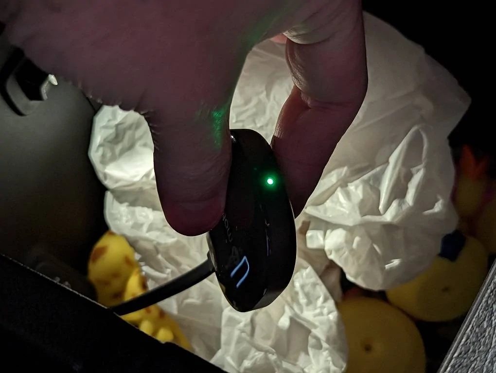

So, trying the mod seemed to make zero difference, as the power to those ports doesn't even seem to be connected to the fuse.
As you can see in the below photos, even when the 102 fuse was gone.. still had power. Debating on taking it into the dealership and have them check the connections, now...
Jeep Gladiator Making Center Console USB Switched PXL_20230111_000031595
Jeep Gladiator Making Center Console USB Switched PXL_20230111_000053153
Still not sure exactly HOW that would happen.

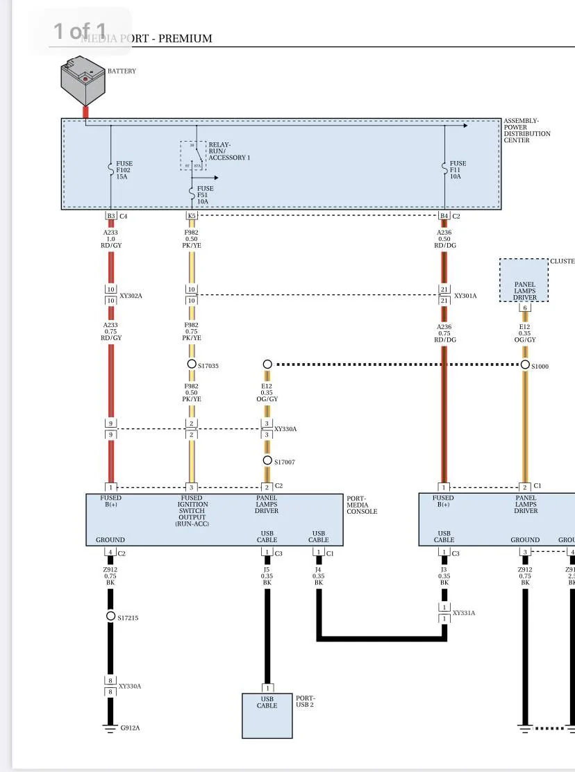

According to the console usb diagram below. There's a constant and a switched 12v wires at the connector located behind the rear usb ports panel.
In theory, swapping the 2 wires/pins will turns the console port into switched power and the rear charging only ports constant.

That's very interesting. Pulling that 102 fuse should kill your USB power. Do you have anything aftermarket wired in by the radio or USB ports that might be backfeeding the circuit from elsewhere?
Caspien
May 3, 2021
282
422
StLouis, USA
2025 1500 RAM, 2020 GC Trailhawk, (Previously 2021 JTR)
I.T. Architect
Nope.. everything hardwired is done via the pre-wired aux switches. (Winch, exterior lights are hooked up in the engine bay. Dash cam, and wireless charger (which apparently has problems with Pixel phones) are wired in via constant and switched power, respectively. Nothing running off the accessory or a tap at all.
Also, those ports seem to be ALWAYS on. Left the MA1 plugged in, all night long, and woke up to see the phone STILL trying to connect to it. Even plugging into the dash usb or the console, without ever firing up the ignition means the device goes live.
Interestingly, enough, I also discovered my wife's 2020 Grand Cherokee Trailhawk has the same thing going on. Her USB ports are also always live, and stay on as long as something has a draw on it.
Weird, for certain, but I'm going to just add an inline rocker/toggle for that port (and her GC TH) , and mount the switch on the back side of the center console, to toggle it on and off as needed.

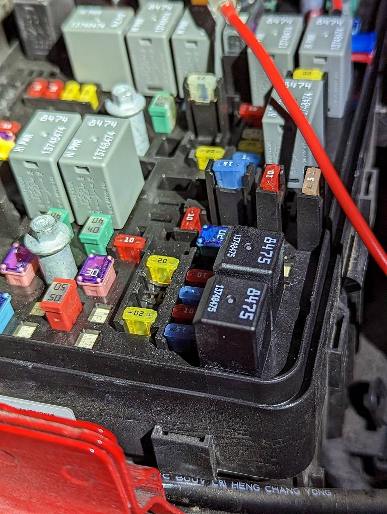

I have a 2021 Mojave, and I ran into the same issue. The F102 fuse was not supplying power to the USB port in the center console. I plugged in a USB powered light into the center console USB port and started pulling anything in the fuse list with "USB" in the description. It turns out, at least on my Gladiator, that the fuse supplying power to the center USB port is F11 - UCI Port (USB & AUX).
I shortened the jumper that I made from two fuse taps (as suggested by @landonbour ) to run between F53 and F11. Worked like a charm. Pics of the jumper are below.
Jeep Gladiator Making Center Console USB Switched 20230211_170550
Jeep Gladiator Making Center Console USB Switched 20230211_170600
