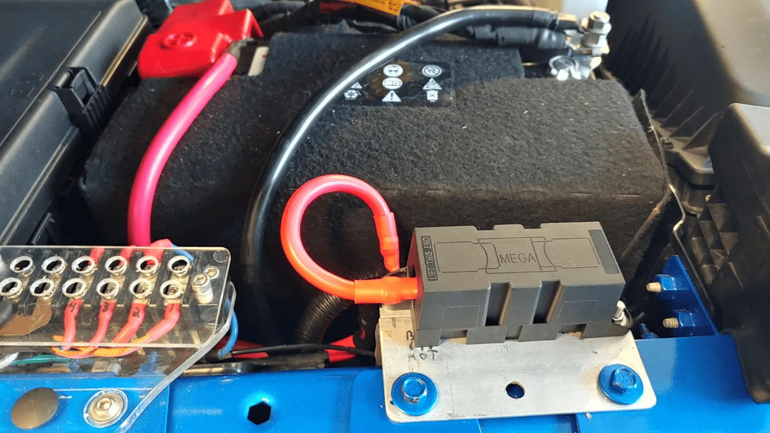

This - ^^^^^I don’t like having all the accessories hooked to the battery terminals either but did have to make a few exceptions:
1) My winch, which does have a solenoid interrupting power
2) My air compressor, which does have a solenoid interrupting power
3) My DC-DC charger, which is really the only major power running front to back and I purposely oversized that run for a better margin of error. It is fused and I recognize a risk there.
#3 is another way to go if you really need to have power back there, unswitched.
Oversize the wire, match the fuse to a smaller gauge wire.
If 10 is adequate, fuse for 10 but use 8, just for example.
