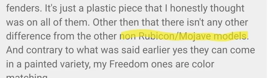

I did a little more research then perhaps others did and here's the difference. The Max Tow fenders have an additional lip for the wider axles on the edge of the fenders. It's just a plastic piece that I honestly thought was on all of them. Other then that there isn't any other difference from the other non Rubicon/Mojave models. And contrary to what was said earlier yes they can come in a painted variety, my Freedom ones are color matching.
The Rubicon/Mojaves fenders absolutely sit higher and have more clearance around the wheels than the max tow fenders. The max tow ones are far more similar to the lower trims, they just have the nicer two bulb halogen fender light (like the overland) and the lip for the wide track axle pushing the tires out the extra bit.
I have a max tow and test fit the some Rubicon takeoff fenders on mine and saw the differences first hand.
