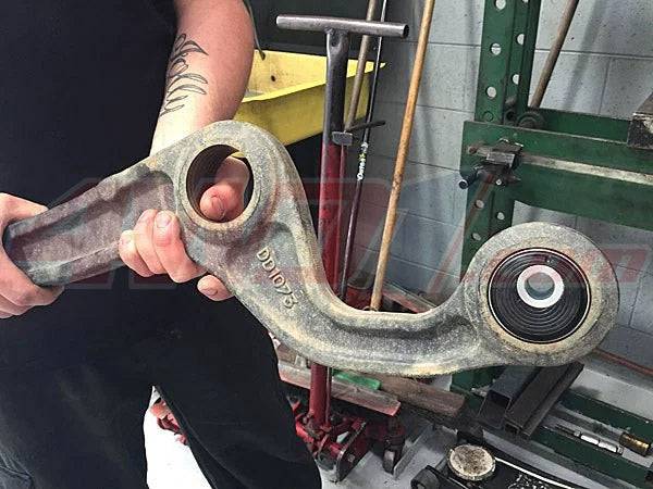

Has anyone found if there is a manufacturer for caster correction bushes for the Gladiator?
I am looking to fix a drift to the left in the steering on a stock Gladiator Rubicon (NZ Market right hand drive).
Ideally, I don't want to swap to Adjustable Castor correction arms, or geometry correction brackets because in New Zealand the truck would need to be recertified for these modifications, a bush upgrade avoids this.
On the toyotas we swap out the bushes to resovel the lack of caster adjustability using something like this:
https://www.ocamindustries.com.au/tough-dog-castor-correction-bushes-for-toyota-lc-70-80-105-series
Jeep Gladiator Caster Correction Bushes? bushes-1_e5e307c6-48a4-4fa0-a85e-6b5c26a81bd1_960x
Cheers from NZ
