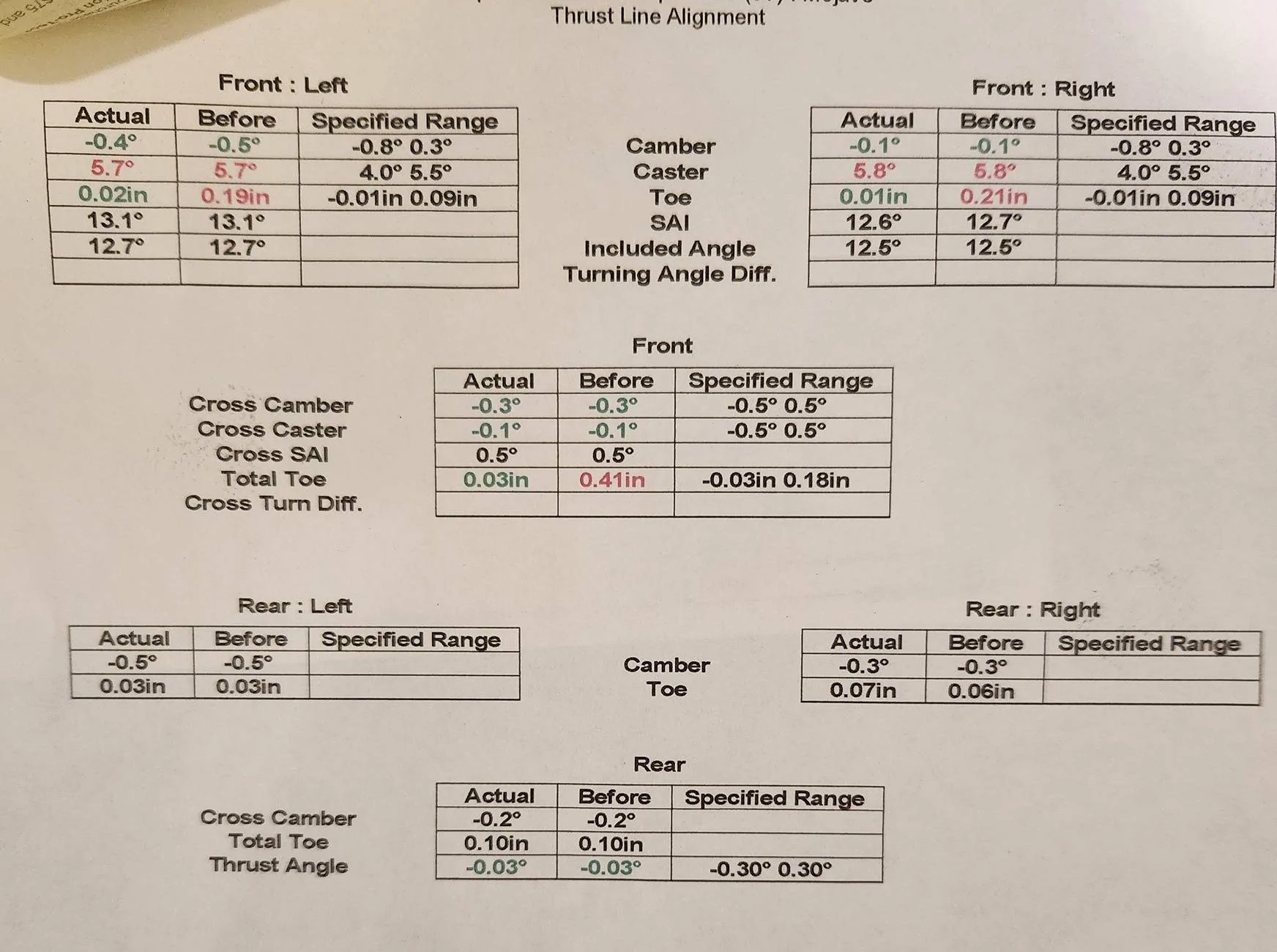

Just had a 3.5 GC lift installed and had it aligned. It was suggested to me that 6 to 6.5 is ideal. Currently it is 5.8. Question is this close enough. I did not want the guys at the Big O take thing apart to try to adjust without knowing the torque specs and letting the lift settle in.
Thoughts?

Metalcloak suggests 6 degrees. I have 6.1 on mine. I don't think 5.8 is going to be an issue.

5.8 is good no need to adjust

Probably couldn't tell 5.8 vs 6.0. Go drive her, if she handles great going down the free way call it good.
3.5" lift?! Getting ready for Moab eh? :jk:

No way you can feel tenths of a degree of caster. Think nothing of it. Drive it and enjoy.
