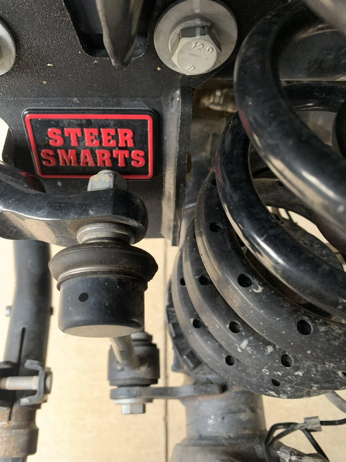

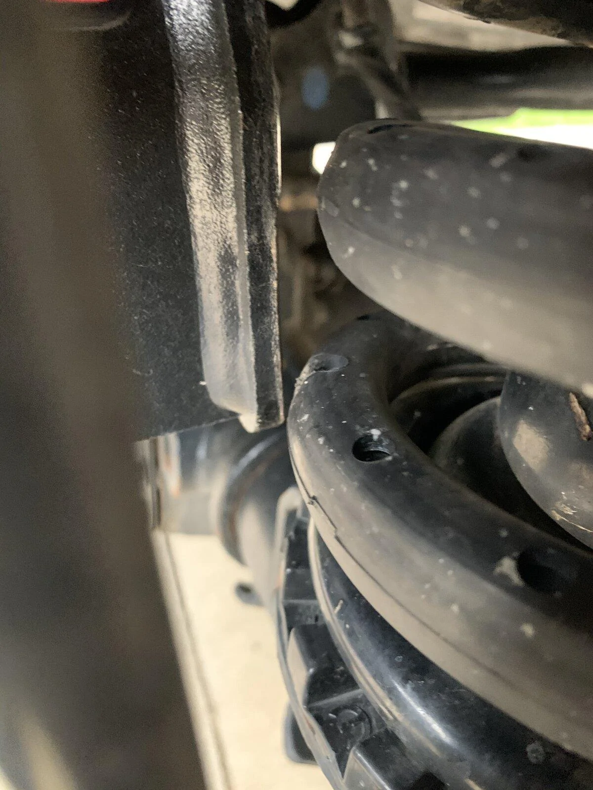

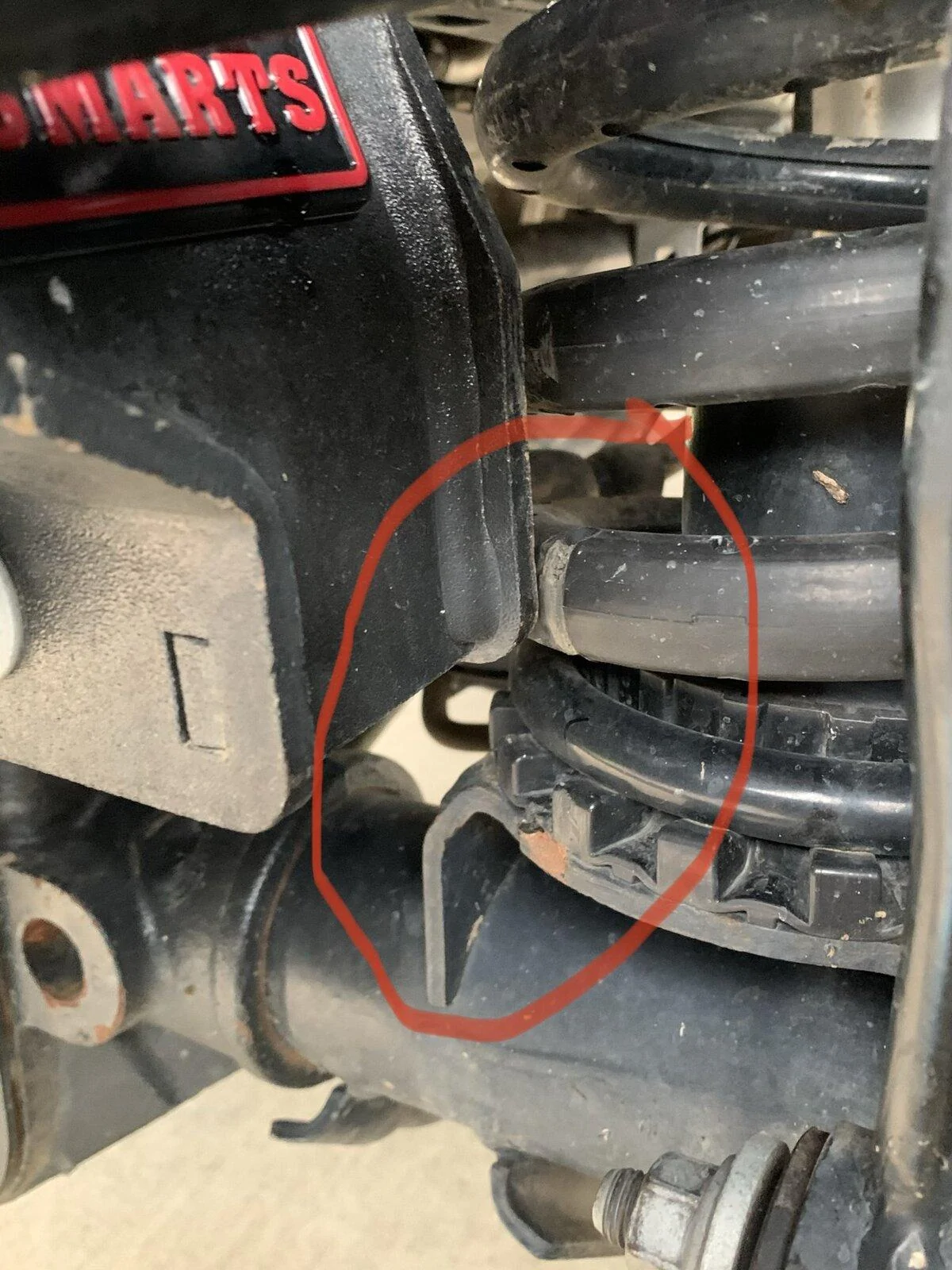

Just had adj lca's put on, and could not get past 6 degree of caster, was shooting for 8, without the steersmart brace hitting lower spring perch.
This is on a JTR with 2" Mopar lift. Anyone had this issue?

This is with 8 degrees when we realized it was hitting on bumps.

Cut corner off, problem solved and it won’t hurt much

Not a cheap solution, but adjustable upper control arms. Leave the lower arms close to stock length, shorten the uppers, increases caster without pushing the axle forward.

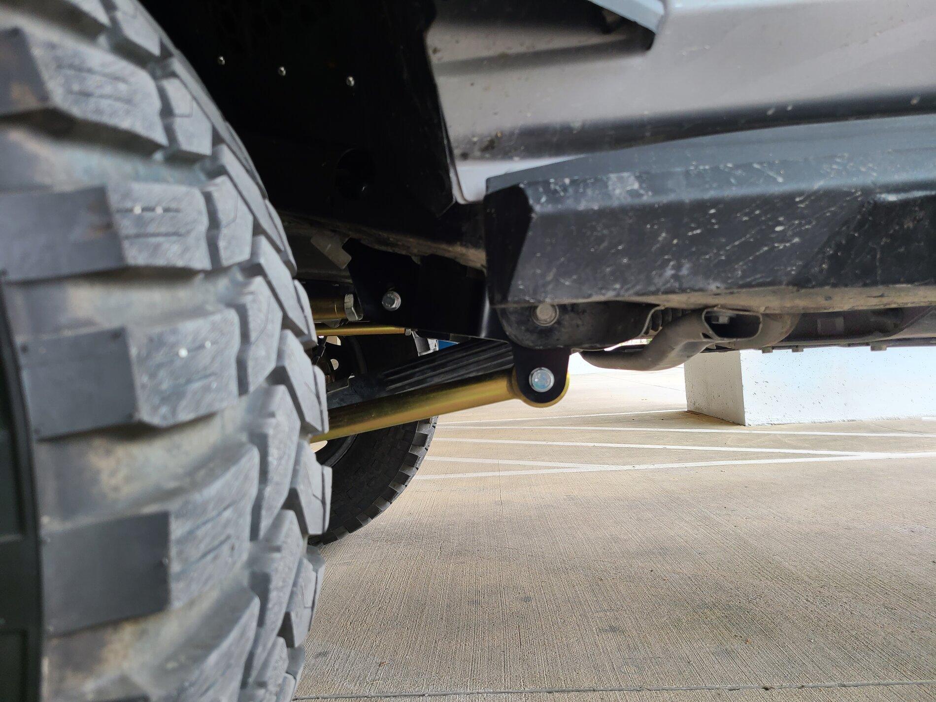

I had my LCA's out as far as I was comfortable going and still ended up using rancho geo brackets. They worked great!
