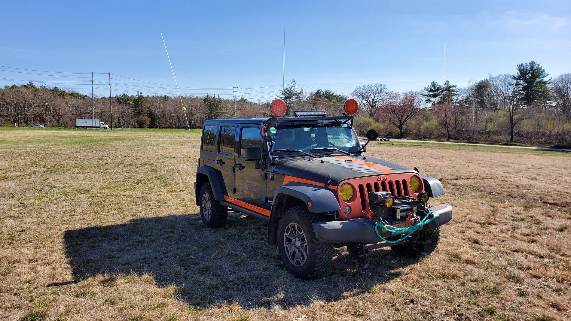

I'm in the middle of adding an old school cobra 29 wsnwst to the rig. Highway company and some fun for the boys.

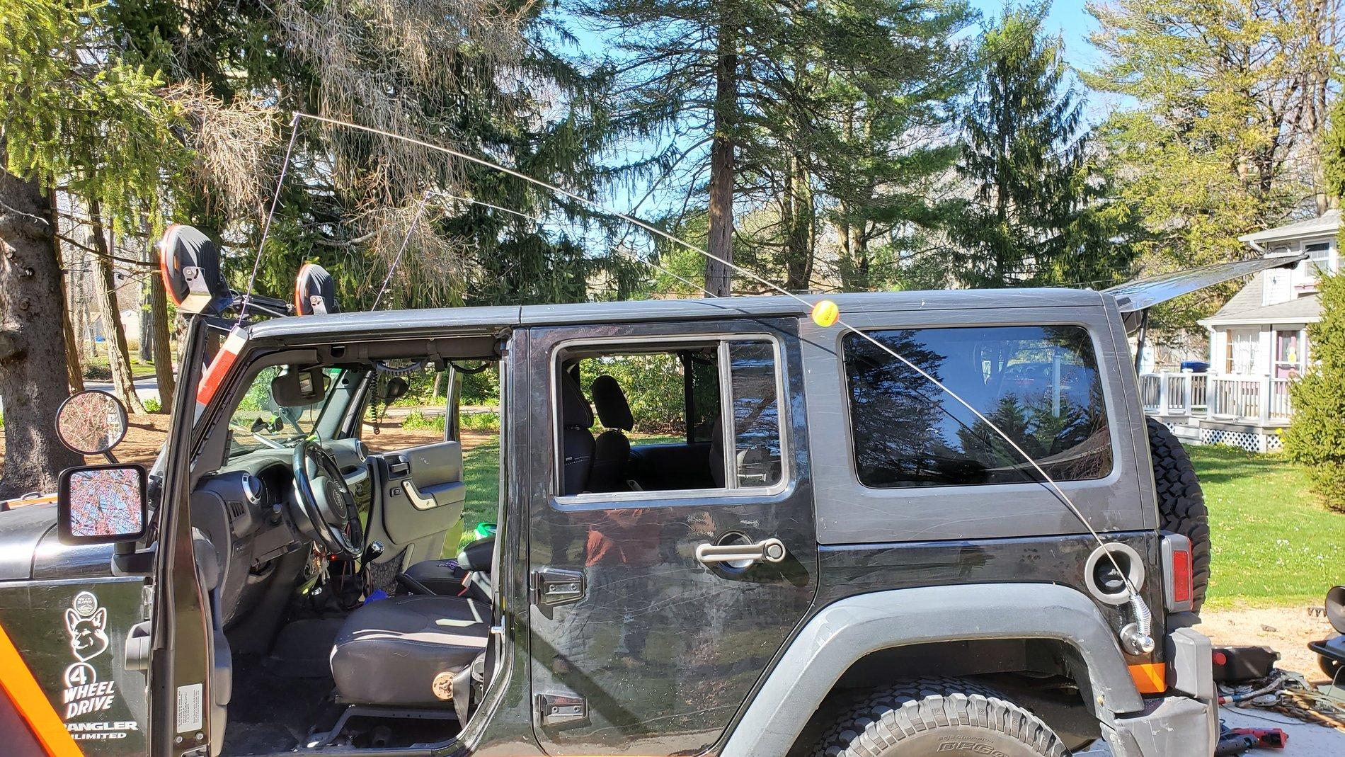

"The plan" is to mount twin 102 whips on balls centered up on the rear wheel arch. Now I'm not looking to run cophased, nowhere near wide enough to make it even worth the bother. So why twin whips? Symmetry and style. And one is for trail flags.

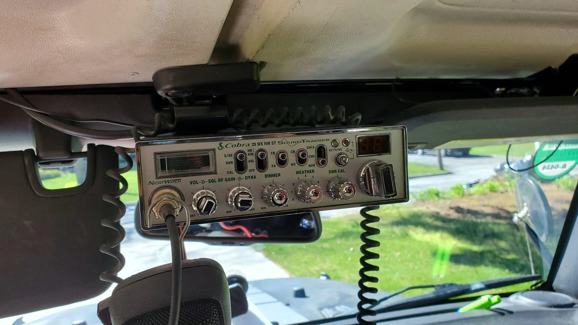

Radio is going above the rear view.

The setup is pretty straight forward:
Rugged ridge cb radio mount

Swivel ball mount
https://www.rightchannelradios.com/.../products/cb-antenna-ball-mount-and-hd-spring
Hustler super heavy duty spring. The spring that comes with the ball mount I suppose is good but wouldn't hold my whips well enough.
https://www.rightchannelradios.com/products/super-heavy-duty-cb-antenna-spring
The whips are classic 102" stainless steel. SWR<1!
https://www.rightchannelradios.com/collections/whip-cb-antennas/products/102-cb-antenna-whip
Coax is the single RG58 type with terminal ends. The ball mount requires terminal ends. 18' just made it from the rearview mirror, across the header, down the a-pilar and back along the rocker, up the wheelhouse and down into the taillight void. A JT has a shorter cab so you should have more slack but mount access is up to you.
https://www.rightchannelradios.com/collections/cb-coax-cable/products/firestik-cb-coax-cable-1
Radios are radios, mine is a classic Cobra 29 WX NW ST, weather channel/night watch illumination/sound tracker noise filtering. Astatic filtering power mic. The radio is peaked and tuned and I'm pushing about 30w. Not ham power but it works. Depending on the amount of getting out into the big empty we do I've been interested in getting my ham license.
