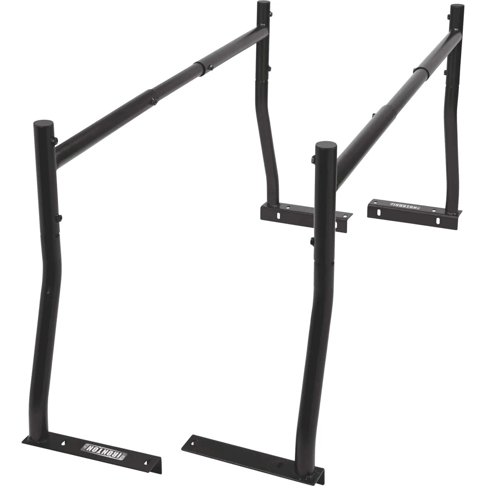

How much was it, as it shows no longer available. There is a different one recommended above it, possibly same rack?

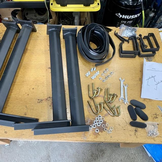

Well I paid about $225 I believe. They had a few vendors all with similar racks at this $250 price point.
This is the better one than the one I got. They have accessories like a rear headache rack. As well as a roof overhang. I had my eye on this one as it seemed to be the better make. Mine arrived a little dinged and dented as I think there was definitely savings in the shipping and packaging.

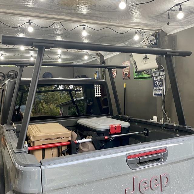

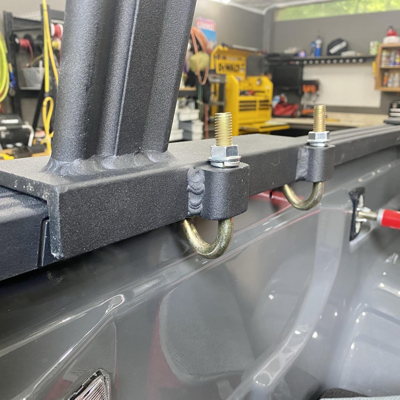

Looks to be high enough to carry a ladder over the cab. Is it strong enough to carry some lumber(not much but a few things)? How quickly can it be removed/installed?

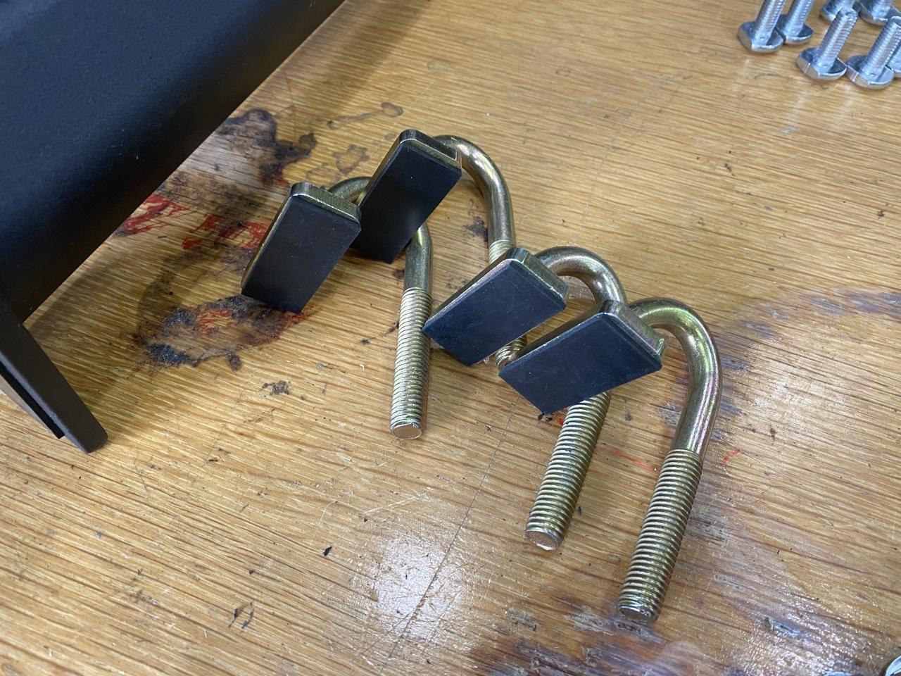

It’s rated for 800lbs or so. And it’s about 4-6” over cab height. Its quite solid. Once it’s adjusted, to remove its basically it’s taking the 8 J hooks off. Probably could put wing nuts or something on it to make it easier.

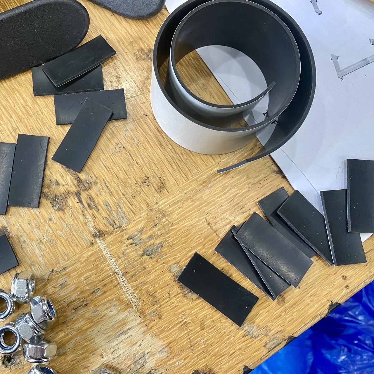

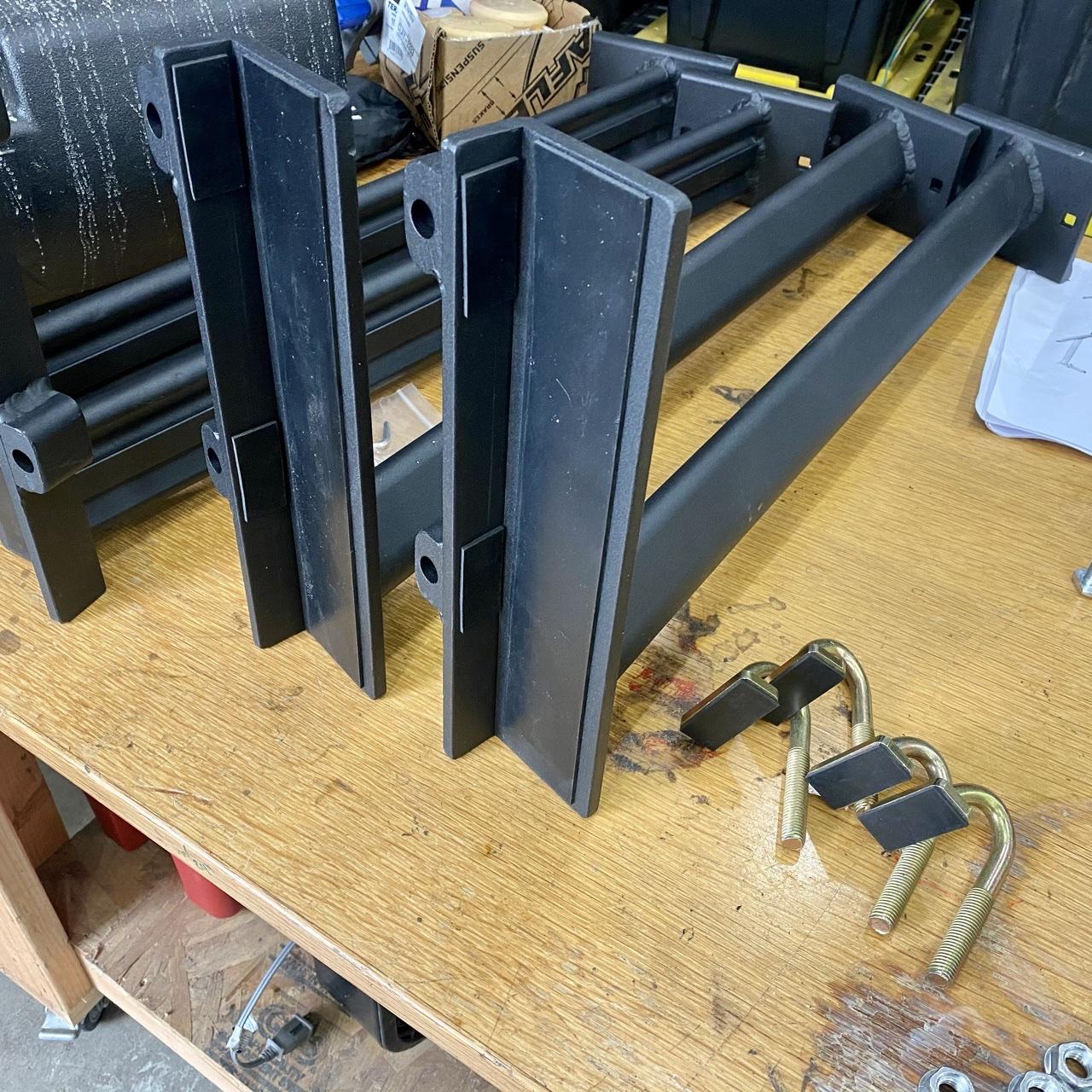

I also had a roll of neoprene rubber I cut up and added to the feet and contact points so it won’t marr or scratch the plastic rails or paint underneath. Cheap and easy to do.
