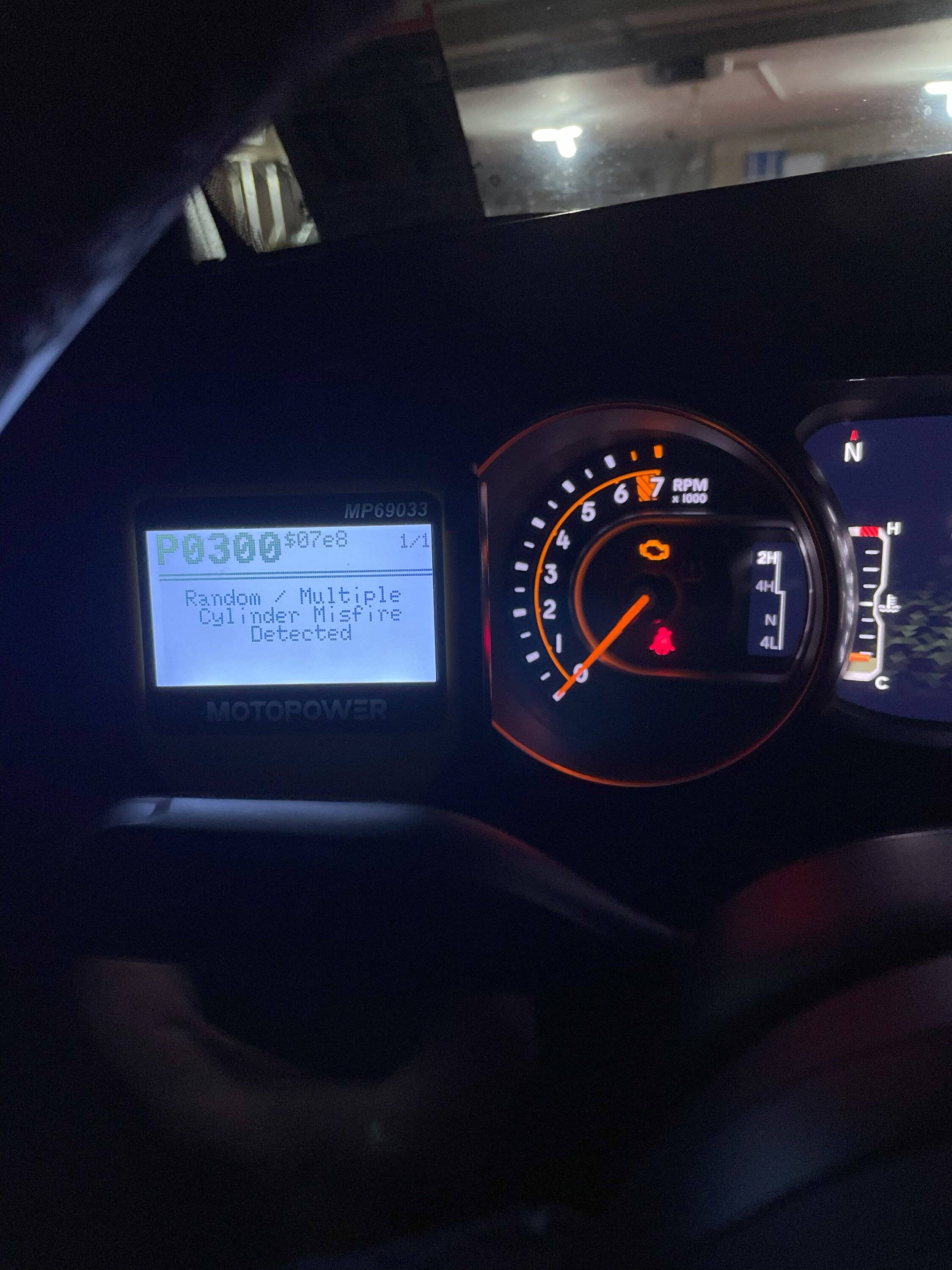

Welp, I shoulda known to just keep my mouth shut and never mention my original check engine light again. I literally just got this last night! Called the dealership first thing this morning and of course earliest they can get me in is next Tuesday. At least this time I captured the code.
Really not happy at all with my first Jeep.
No exaggeration that over the last 30 years I've owned at least 25-30 different cars & trucks from just about every mainstream foreign & domestic manufacturer and have never had an issue like this with a new vehicle. I'd say it's luck, but after reading through the mountain of issues (engine and otherwise) I'm starting to have major regrets.
Problem is, I love the damn thing.
People tend to buy a new Jeep, have problems, then figure it's just Jeep. However, had they instead bought a new GM, new Ford, new whatever, they'd find similar. It's not just Jeep, new cars and trucks have actually gone down in ratings in the last couple of years. Check out what J.D.Powers is saying now. First time ever, 2 years, satisfaction is down - almost across the board.
So it's not just Jeep.
Get it to a dealership. If it is doing like what mine did - hot restart misfires, the fix will be very simple.
Don't assume that because it doesn't do it for a month it's going to be fine.
Mine was fine for a month, then suddenly did that very badly - I mean the truck was shaking and #2 didn't fire at all for about 30 seconds. It would go days or even weeks between instances of the misfire. I tracked it down to the left bank only when it did this (even number cylinders, 2 was the worst, then 4 but not as bad as 2, then 6 but not nearly as bad as 4. 1, 3 and 5 were pretty much fine)
