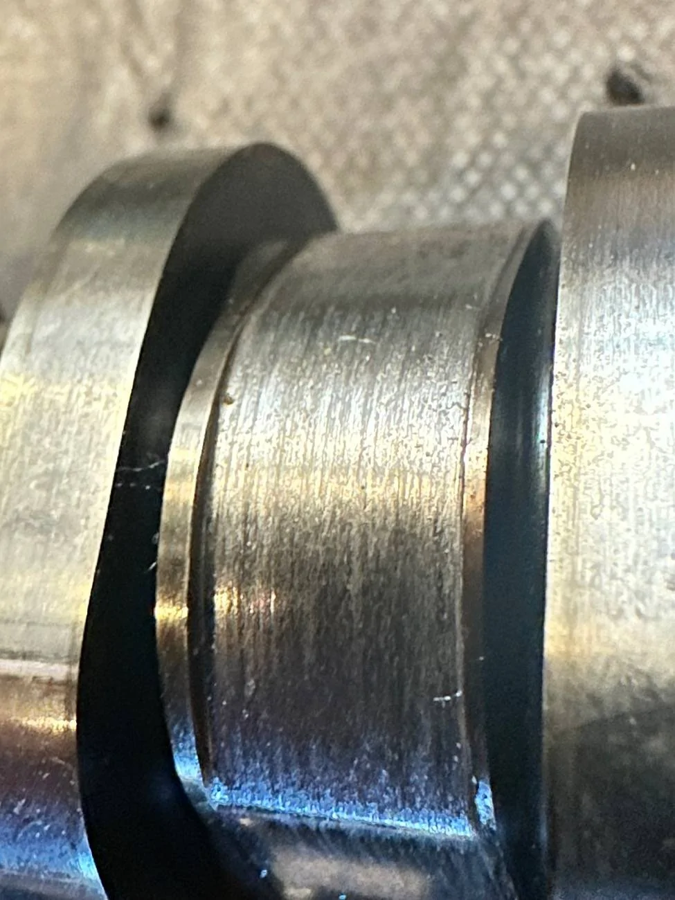

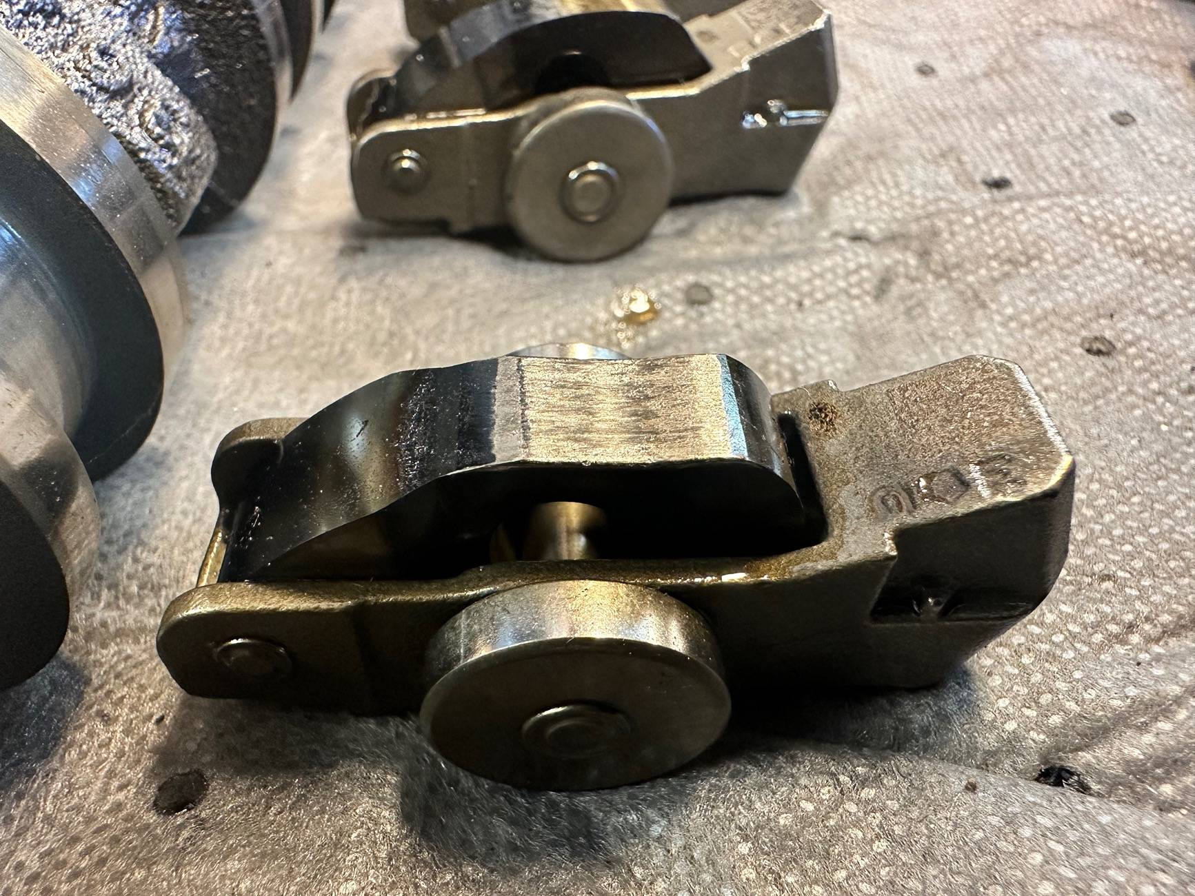

How many miles? I got the check engine light while climbing a steep hill on a hwy. shop pulled the plugs, which were fine, but borescope found the #1 Camshaft had a worn lobe and rocker. My engine only had 75,000 miles 🤬
Jeep Gladiator Check Engine Light IMG_8915
Jeep Gladiator Check Engine Light IMG_8914

I wonder if Heat treatment, hardening of the cam shaft has something to do with that ? Or is it the angle of the engine . Did it starve out the ones in the front of the motor
What year is your JT also. Was it the ones in the front of the engine ?
My JT is a 2021. This was the the first lobe and rocker closest to front of engine.
it’s been running great since the replacement earlier this year but confidence isn’t great that another camshaft won’t have the same issue.
Out of curiosity what brand of oil was you running when it happened 🤔

Not a specific oil brand loyalist. Over the course of the truck's life so far I have used Mopar, Penzoil, Mobile 1 and Kendall. Just made sure it met the jeep specific requirements. Jiffy Lube did the last previous oil change with Penzoil.
