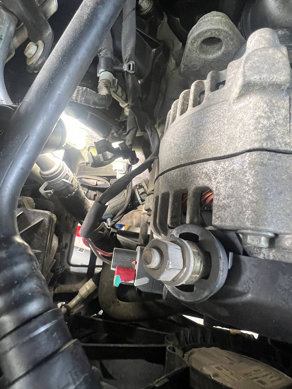

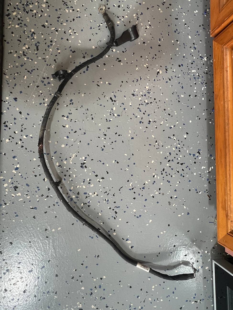

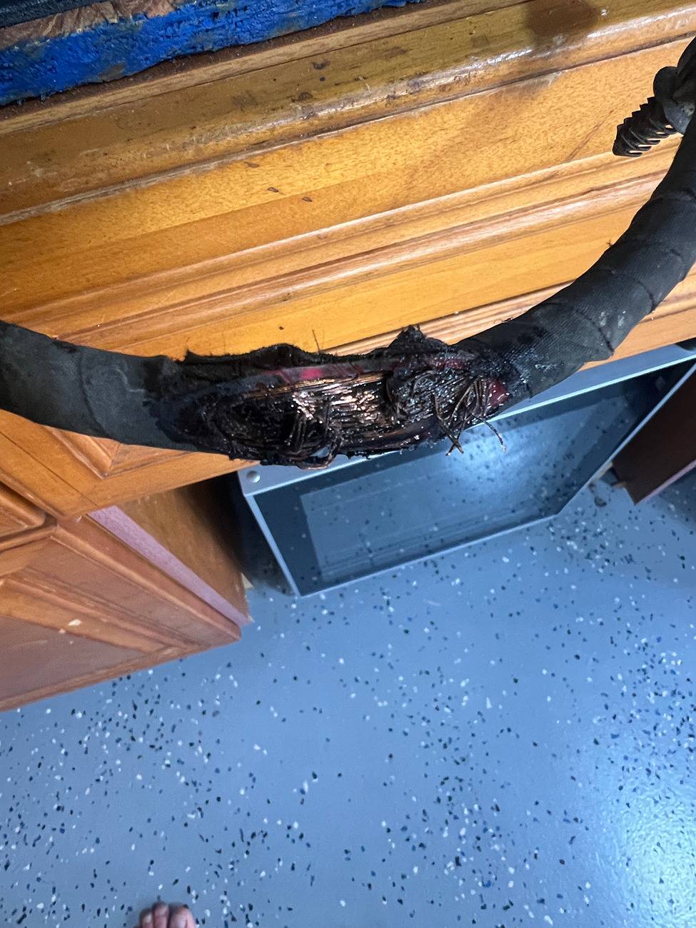

Hello everyone,
Just a heads up, i was looking over my engine bay because of an ESS issue and i just happen to find that my wire from the alternator to the fuse box was rubbing on the idler pulley. 2 of the plastic mounting clips had failed and caused the wire to fall onto the pulley. It is an easy fix, just a crap design. This will of course cause issues with the ESS. I have had mine turned off and never used my ESS, from day one with a Tazer. Its around $60 online for a replacement. Thankfully its not attached to any other wires or in a loom.

Well yes it is a crap design because when 2 of the clips failed it was able to fall onto the idler. Thats not good. Apparently it is a length issue with the 19-23' models. Looks like they changed it for 24'. Even with the 2 upper clips still on (heater hose and next to the alternator) it would hang almost midway down the idler pulley. It could have just been an issue with the clips themselves during manufacturing. No engine mount issues, never been hot.

Wow, that's a scary sight.
But, as Bill mentioned above, that's got nothing to do with ESS. It's an edge case failure and while I agree that is a shocking discovery (no pun intended), it's not an indication of a design fault. It's simply a rare failure that occurred to you.
Much like how a single failing engine mount can damage a ton of other things; that's not indicative of a bad design on the engine mount but just the result of a component failure.
