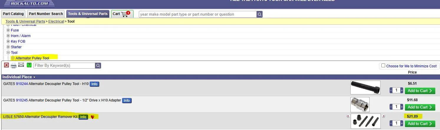

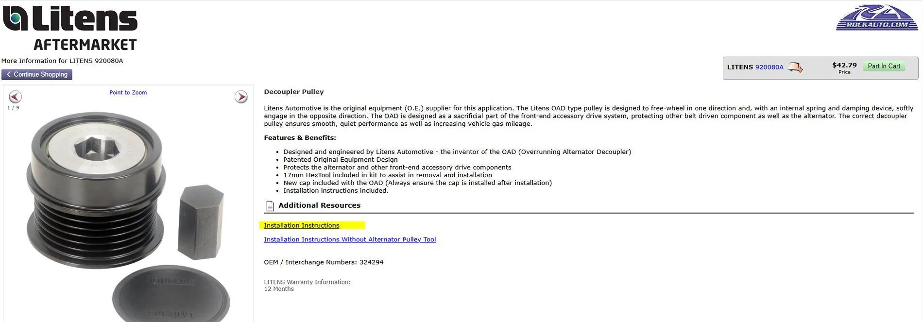

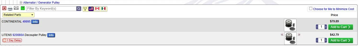

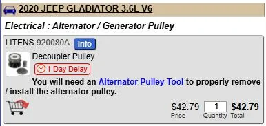

Bumping this back up... been chasing down a high pitched noise at front of engine then I went out to see if I had any "racing stripes" from the decoupler pulley and I believe that I do. My alternator still seems to be charging fine as I regularly watch it fluctuate on the gauge from 12.6 - 14.3+ volts.
I guess my question is can I just replace the decoupler pulley with one from RockAuto? Quite the price difference between the two offerings but I'll pay to play if I get better quality from the Continental.

Well I ordered the Litens decoupler pulley and tool as well as a new serpentine belt. For reference I have a 2020 JTR with 61,000mi currently. I'm chasing a whistling sound and I'm going to systematically try to replace parts to remedy the issue. It might require time and duplication of parts removal but I can perform the maintenance myself. For reference, the whistling noise started around 59,000mi I believe. I noticed it during a trip in Oct 2024 to Moab. I'm not sure if my "racing stripes" are the beginning of the oil leak or the remnants of a completely oil-less decoupler.
My current approach to finding the source of the whistle...
1) Verify power steering fluid level and visual inspection of parts listed below
2) Remove serpentine belt and spin idler pulleys by hand to feel for any grit or slop
3) Replace decoupler pulley and serpentine belt (test drive, then perform next step)
4) Replace idler pulleys (test drive, then...)
5) Replace water pump... there's a great thread on here where the "whizzzzing" sound was a bad bearing in the water pump
6) If all else fails, just keep the radio above volume level 15 :)
Seems like a well thought out plan!

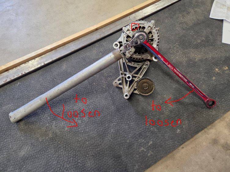

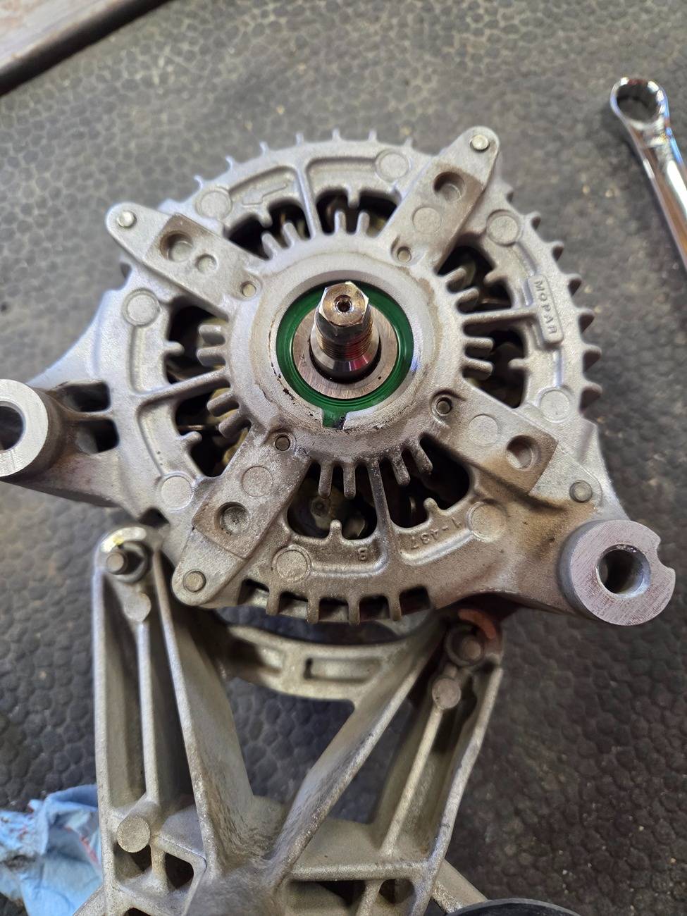

Just a update as I remove the OEM decoupler...
** Quick Tip before reading below = the decoupler pulley is reverse-threaded when looking directly at the pulley off the vehicle like in the pics below ** If you imagine the alternator shaft as a fixed threaded post and the decoupler pulley as a nut, then it's righty-loosey and lefty-tighty.
1) The dust cap was difficult to remove with a pick or small flat head screwdriver (for me at least). I simply drilled a small 1/8" hole in the center of the cap and used a punch to pry it out... worked great
2) I had a lot of grease in the center of my decoupler pulley and it might be the reason the idler pulley looked so wet and crudy? I'm replacing both idler pulleys while I'm in here
3) I personally needed all the leverage possible for the removal of the decoupler pulley... got a long 19mm box end to hold the large hex key in the body of the pulley and put a pipe extension on the 3/8" wrench with the 7/16" socket on the alternator shaft portion (10mm head) of the tool
4) If looking at the pulley on the alternator while it's off the vehicle, turn the 7/16" socket counter-clockwise (follow the direction of the arrow stamped on the alternator) while holding the 19mm box wrench stationary. If you do this while the alternator is still on the vehicle and you're standing at the grill, then you'd turn the 7/16" socket clockwise (or towards the driver side). Again, always turn the 7/16" socket the same direction of the stamped arrow while holding the 19mm box wrench stationary to REMOVE only
5) Reinstall
