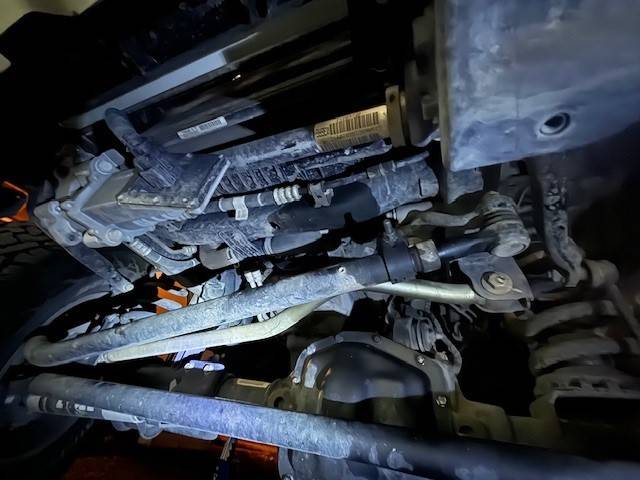

Anyone have any ideas why it looks like burger king fry station on my drop link, trackbar, tie rod, and front diff cover?
Looks like its coming from the radiator support? Is there a pump or something up there?

Possible power steering line leak, it runs next the radiator. I would shine a light right next to the frame where it goes up towards top of the steering gear box. I just replaced a line over the weekend and it was a PITA.
