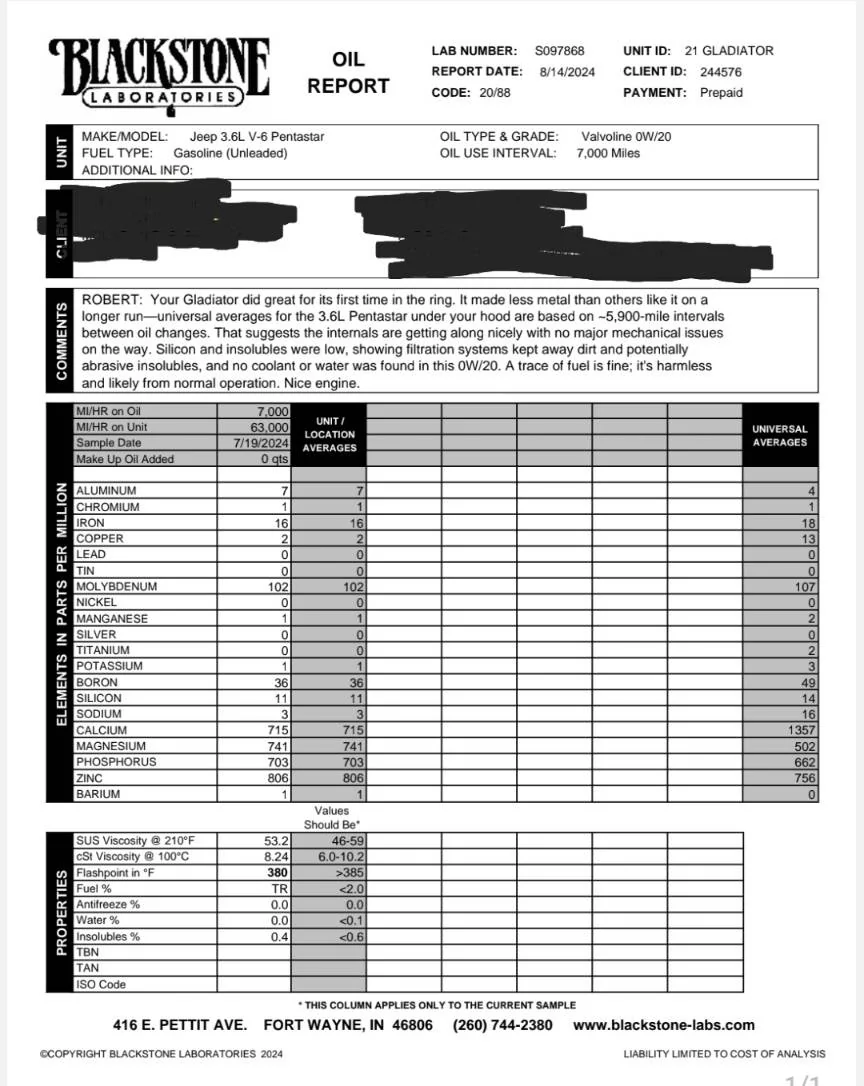

I have to admit, I'm pretty pleased. My first check at 63k miles on my 21 mojave. Everything is within spec.
The only thing I can mention that I do is I generally change the oil between %15 and %25 life left. Mostly because I change my own and that where the timing works best. I do use mopar filters, and 0w20 valvoline or mobile.

Curious about the flash point in Fahrenheit. You are 380 and it wants 385 or higher.

Probably from me having some higher amount of fuel in my oil. My daily drive is only 8 miles each way, but I pull a 600 mile trip every other month.

That proves it. The engine does not need and oil catch can.
