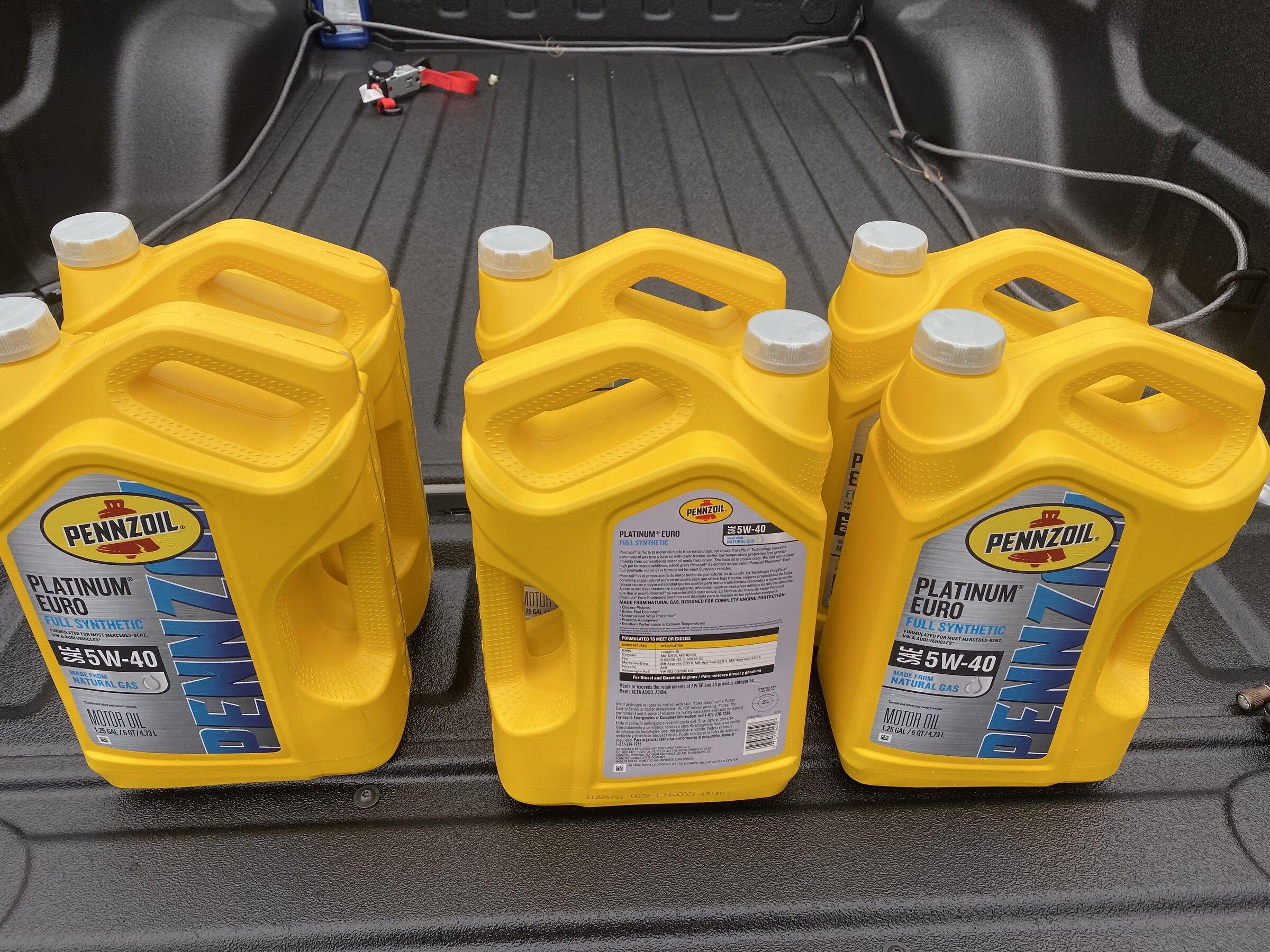

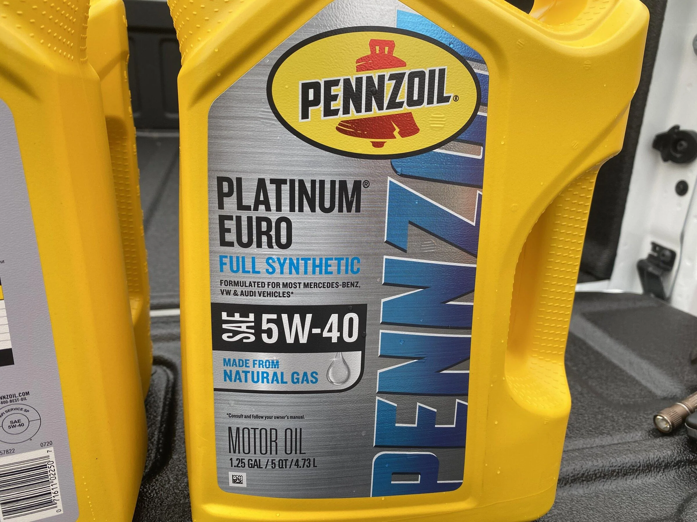

A couple months ago I couldnt find oil filters for my Honda (checked 5 walmarts and a few auto part shops). Now I cant fine any Mobile 1 0w20 Extended Performance. Actually I cant find ANY Mobile 1 0w20 5qt at Walmarts aside from a random jug of Advanced Fuel Economy. Some auto parts chain stores had it but at $40 whereas Walmart is usually $25. Amazon doesnt have it either.
I managed to get the Extended Performance High Mileage, but my JT is only at 46k miles not the 75k the oil is intended for. I do have a jug of Valvoline Ultra Platinum Full Synthetic from before Stellantis said Mobile 1 was fine to use. Which of the 2 should I use ?
Also curious if you guys have been seeing less availability of oil in your areas
Make sure it’s in writing. I’m just guessing you’re referring to oil for a 3.6. I lucked out finding oil and found 3 non Mopar filters. I’ve since picked up 3 more jugs. The 2 Mopar filters I ordered are still on back order 2 months later. Fuel filter??? A unicorn.
