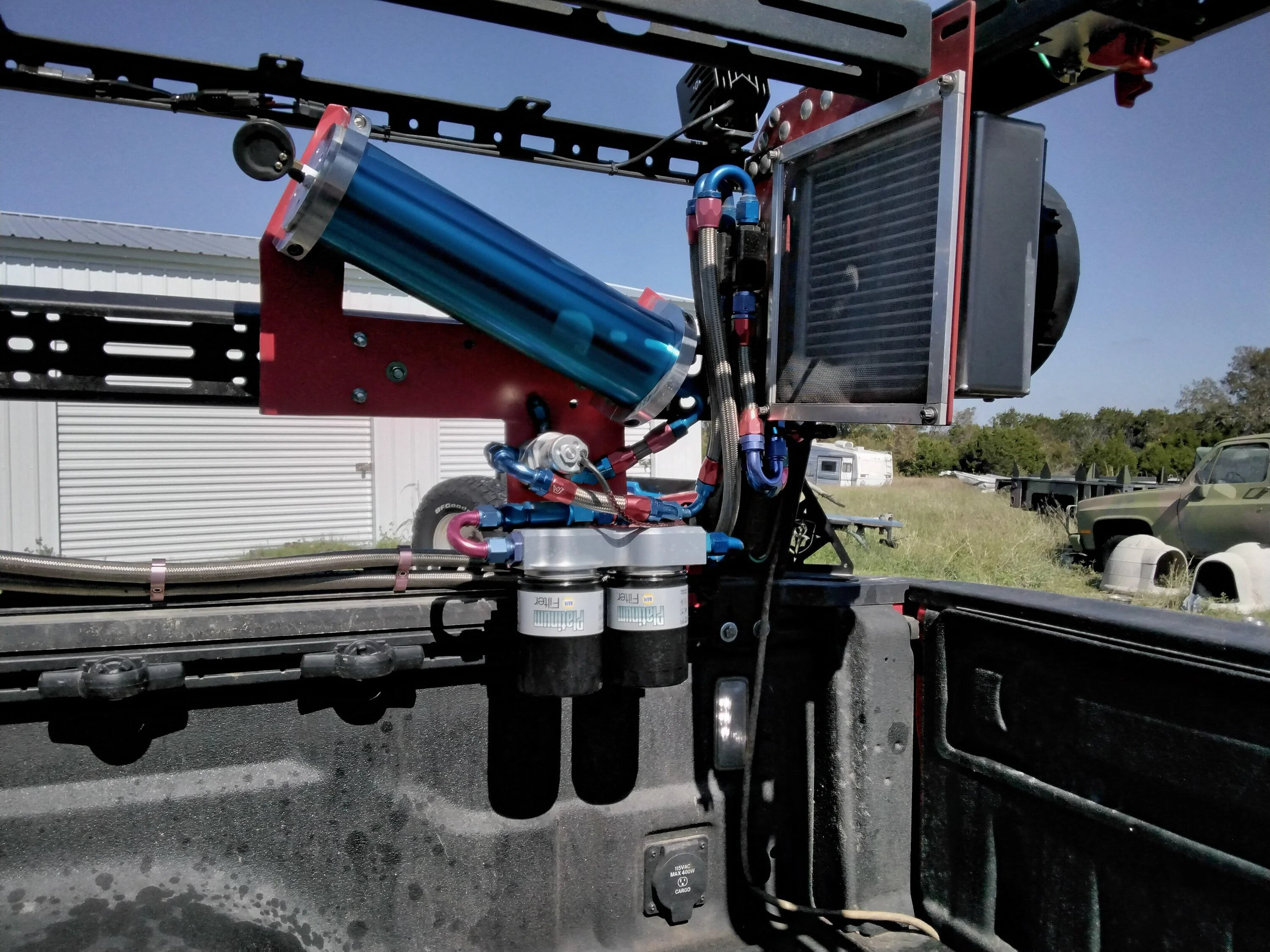

15 quarts a change? It only has a 5 quart capacity. What are you doing with the other 10?
If you're using 3x the oil each time, of course it's going to be way more expensive. You might be able to save cash by just using the 5 quarts it needs.
Yeah, it;s a 15 quart oil change exactly. The swapped Dodge Demon takes 6 quarts, the Canton remote sump (blue thingy) takes 3 quarts, the 2 filters take 2 quarts and the oil cooler and all 40 something feet of -AN 10 hose take 4 quarts. Add it all up? 15 quarts. I'm not complaining, just asking around about other people's experience with different synthetic 0W-40's.

Think you would have been better off with a dry sump.

I was channeling my inner plumber. Or plumbing my inner channels.
