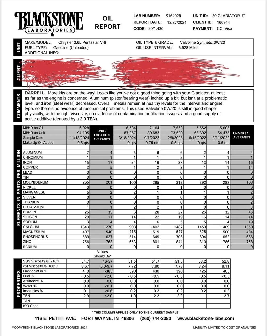

This guy mentioned a follow-on test which he has not posted. Not sure how many folks send use oil out to test to determine wear but the geek in me is considering it.
I'm one who has sent a oil sample in at all oil changes.
Jeep Gladiator Oil Change time rapidly approaching. What to do? Screenshot_20250214_004342_Adobe Acrobat
BTW;
A reason why I send a sample it is a traceable oil changes and dates. Hard to deny having a oil report on all oil and filter changes after the first few by dealership. And a report from people who know about oils.
I'm getting sucked in on another oil thread. :headbang: :headbang: :facepalm::giggle:

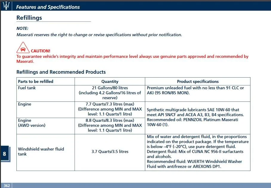

Globally, the 3.6L Pentastar as used in our Gladiators, specs 0W-20 grade oil regardless of market with no alternates listed.
The so called "European Pentastar" is a 3.0L engine commonly found in Maserati products. It is basically built as a short block on the same engine line as our 3.6L but is then sent to Italy where Ferrari under contract builds out the rest of the engine with their designed heads with direct injection and twin turbo intake system. Maserati prior to 2018 spec 5W-40 but since at least 2018 and up, they have spec 10W-60 grade motor oil that is commonly referred to as a "Supercar Oil" because most engines it will go in are expected to be tracked and pushed hard.
In my opinion, there is no detriment to running a heavier oil grade in our 3.6L Pentastar, but also that the current 0W-20 grade recommendations are more than adequate for expected normal service use.
Thanks for the information. Time to watch some more oil analysis videos ;)
