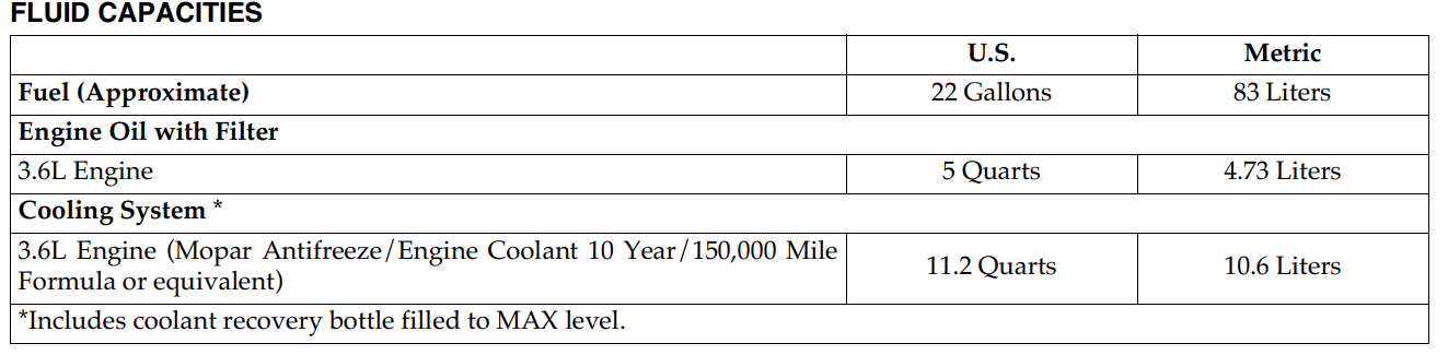

Yeah it says 5.7 quarts but I have never put more then 5 in. Measure what you pull out, put in 5 and check it. Mileage will vary I guess.
Guess the engine expands and contracts up to 3/4 of a quart?
250
40,604
54,296
Does no one read the MANUAL any more? That online chart even shows a different coolant capacity. Something is wrong with that chart, or, they are basing oil capacity on a dry vehicle that's never had oil in it and that .7 is what the cooler and lines hold. That's the only way 5.7 could be right.
5 is what it takes for a change with filter.

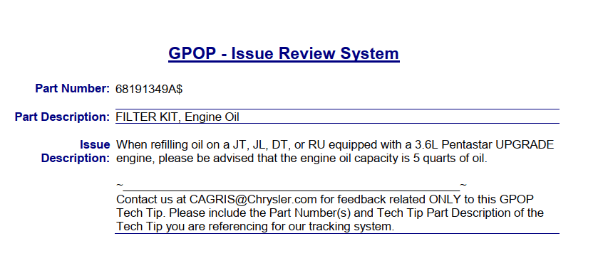

The "capacity" of the crankcase when changing oil and filter is 5 quarts. No guessing. Jeep even had communications to dealers on the topic.
When 5 quarts is added, oil comes up to the full mark on the dipstick of my engine. When over 5 quarts is added, it's obviously over-filled based on the stick.

2025 Gladiator Sport
It is either a typo or a dry engine fill capacity from the factory spec.
Owners manual and even the Chrysler Tech Authority the dealerships use for reference lists 5.0 quarts as stated capacity when servicing.
5.7 is too much for a in service oil fill. I have noticed also what others have already mentioned is to wait 10-15 minutes after a 5.0 quart oil change before checking level. I am on my third vehicle with the Gen 3 Upgrade Pentastar with probably easily 10 oil changes between them and they all took 5.0 quarts.

In any case, I am amused that to this day, years after the introduction of the modified 3.6 in the Gladiator, there's any discussion at all on oil capacity in the case of oil and filter change.
People are over-thinking it. It's clear in the OM, it's clear in the STAR communications to dealerships - the oil capacity in the case of an oil and oil filter change is 5 quarts. The pan was made smaller and lighter, among other changes.
The talk of measuring what comes out and putting the same amount back in is also amusing. What comes out isn't necessarily what it started with due to multiple factors - natural oil consumption (which includes burning and vaporization and PCV operation) and natural increases through combustion products entering the crankcase. And unless you use a spatula to scrape every drop of oil film off the container you drained it into, you'll likely miss.
Drain it, change the filter, put 5 quarts back in and be done with it.
That's the process used for longer than I've been alive and yet - there's still doubt that it's good enough?
Between Hootbro and I, we have provided 3 documents supporting 5 quarts - two of them from FCA tech, one the owners manual, plus the fact that if you put more than 5 in, it's over-filled on the stick.
This is so very simple but is still talked about 3 years after this truck was introduced.
