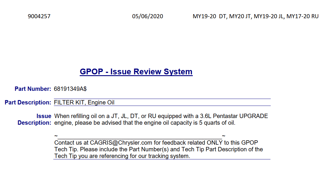

I’ve changed the oil myself once and just took it in for a free Jeep Wave oil change.
Brought in my own oil and filter and they looked at me like I was crazy.
Then the tech and his buddy wanted to argue with me about it taking 6 qts instead of the 5 I brought in.
I told them I would get the manual out of the glove box if they didn’t believe me.
Needless to say,the tech gave me a thumbs up after checking the oil level after changing it.
Anyone who has problems with the dealer on oil capacity - show them this Chrysler communication (full PDF attached with original number for reference)
Jeep Gladiator Dealer oil change oil-capacity

Complete, total and absolute BS. Requiring dealer brand parts to preserve a warranty is specifically prohibited by law. To void the warranty, the dealer would have to prove the oil filter caused a failure.
I will be doing some more checking on this. This is interesting.
Is it the same on the JTRD

That's bunk because right in the BOOK it says FIVE (5) quarts. Show them the capacities in the owner manual. Also - there's a TSB about oil capacity in the 3.6. You'll never guess what it says the dealer should put back in - yeah, FIVE quarts.
I don't get these "Dealers". Do they not read? Can they not read?
It's in this communication to all dealers, it's in the owner manuals, it's in their tech documents.
