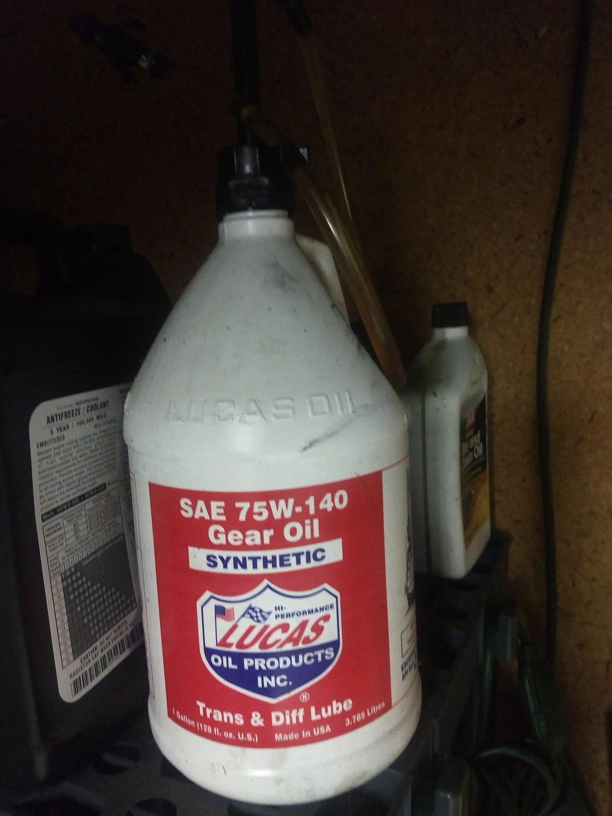

Also @ShadowsPapa what do you guys think of this diff fluid? I used it on my JK"s and wondering if it is compatible with our JT's
