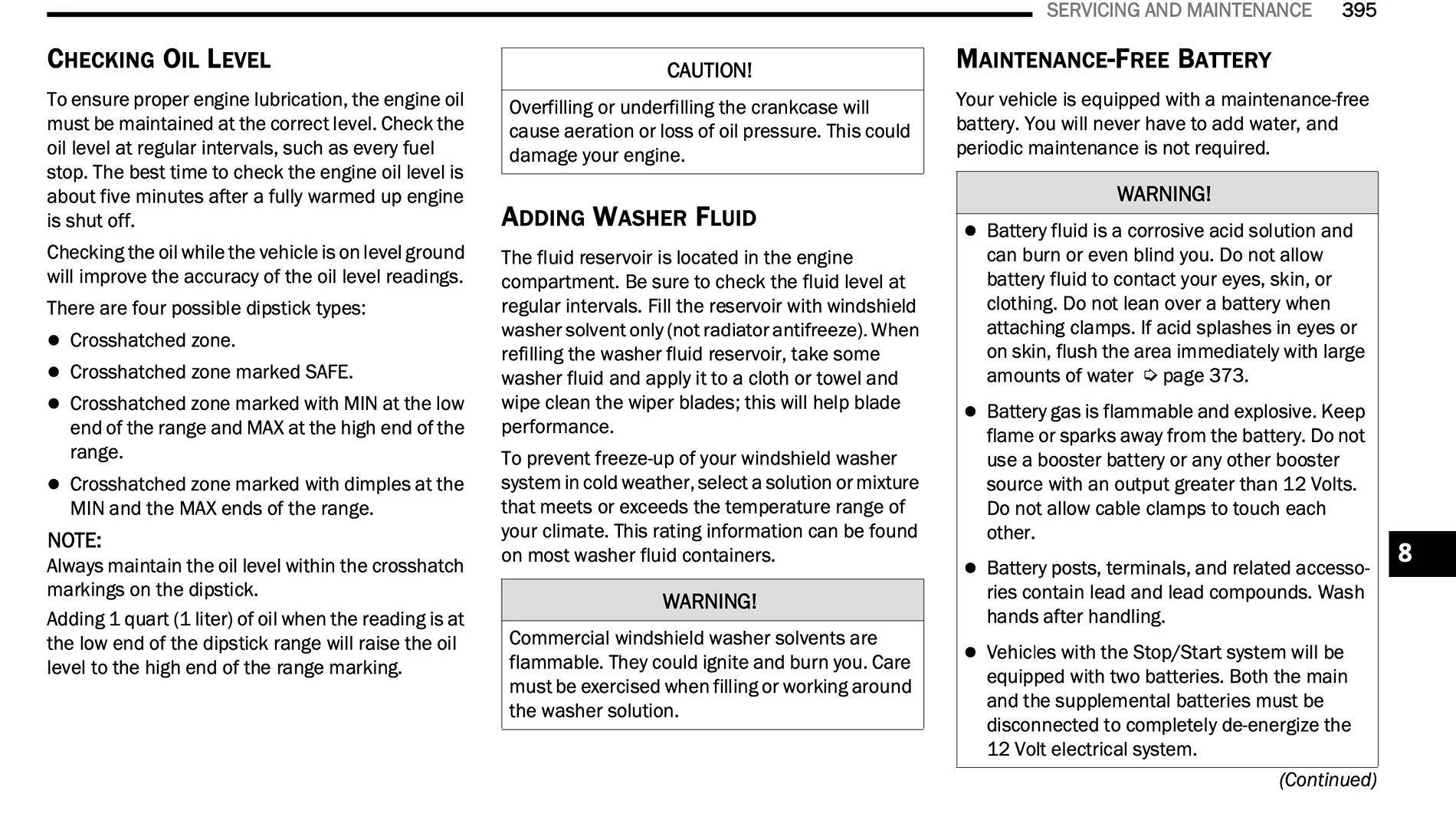

Just curious. I too have been checking the oil since I got my first bike 55 years ago. Every single manufacturer has a way to check the oil for for each of their engines. Some are cold, some are hot. For newer Harley's it has to be at operating temperature with the jiffy stand [kick stand] down.
So why aren't any of you just reading the owner's manual?

Can still more easily be checked cold - you just have to understand it will read slightly different warm. If someone can't understand the difference between hot and cold fluid level checks, they really shouldn't be doing them ;)
Many thousands of equipment operators, truck drivers, and others using fleet vehicles, check fluids at the start of the day. Just need to know it will read lower when cold than it does hot - not by a whole lot.
I'm not going to stand and wait 5 minutes - I'll check it before I take off.

Definitely NOT what I did with oil in my dirt bikes, earlier Harley's, and '70 Dodge Charger RT SE with the 440 Magnum. To me each engine is unique but I always start with the Owner's Manual.

hot check and cold check on opposite sides of the same stick that go in the same depth??
There is a recessed part with crosshatching made into it. They do that because as you pull the stick up, the larger part may be wiped clear by coming up the side of the curved tube. There are actually two recessed areas - the other side, opposite the crosshatching, appears to be a part number or whatever (alien code, coordinates to pirate treasure?)
Mine usually reads where that red line is, unless it's been 5,000 miles or more.
Same here.
