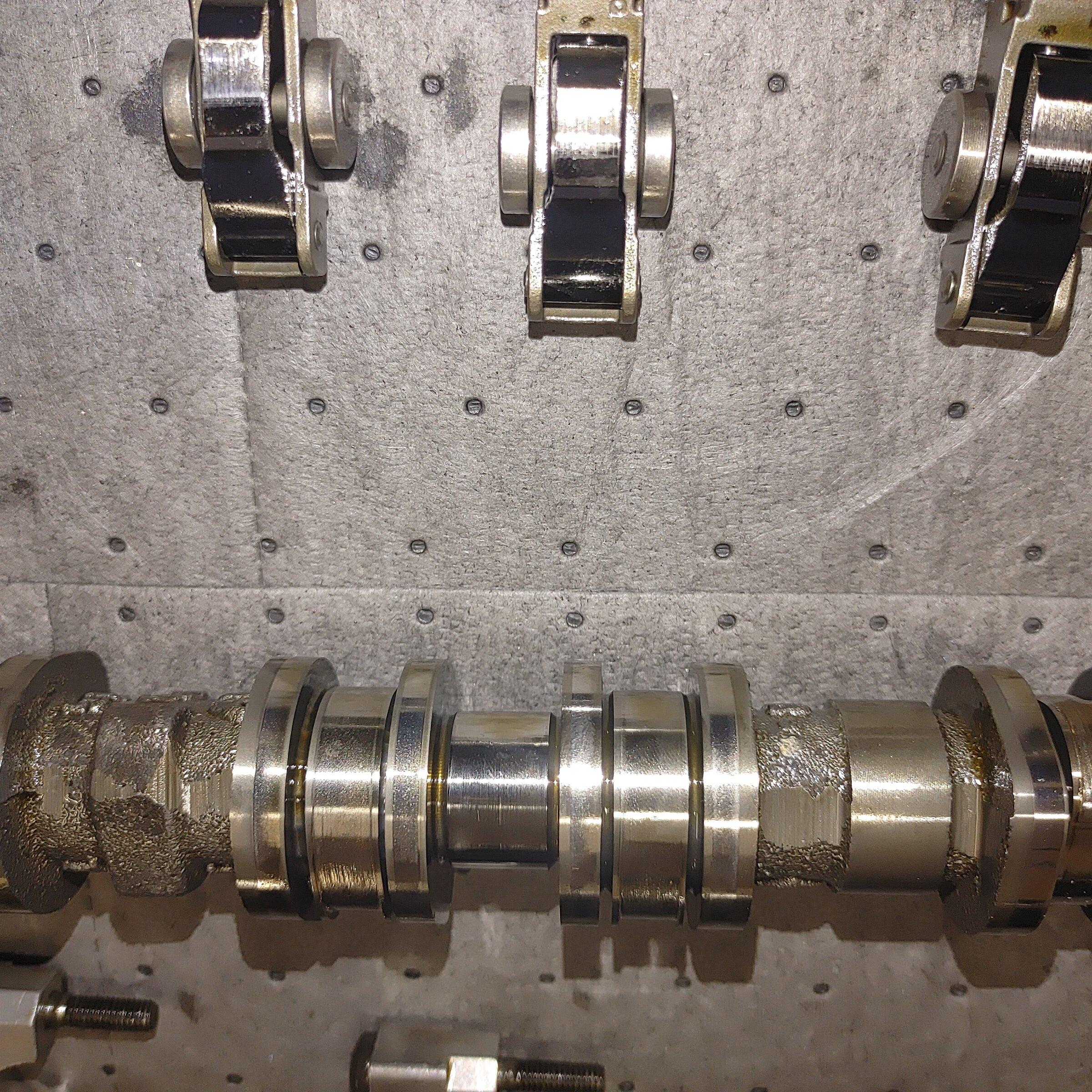

I have a couple data points that would counter this statement. I have seen this on multiple machines. Mine had 26K. I have switched to a mix of 5W-20 and 5w-30
Not sure what statement you're countering. Compared to a turbocharged DI engine the Pentastar is easy on oil.
Roller bearing failure in a cam follower is a different issue.

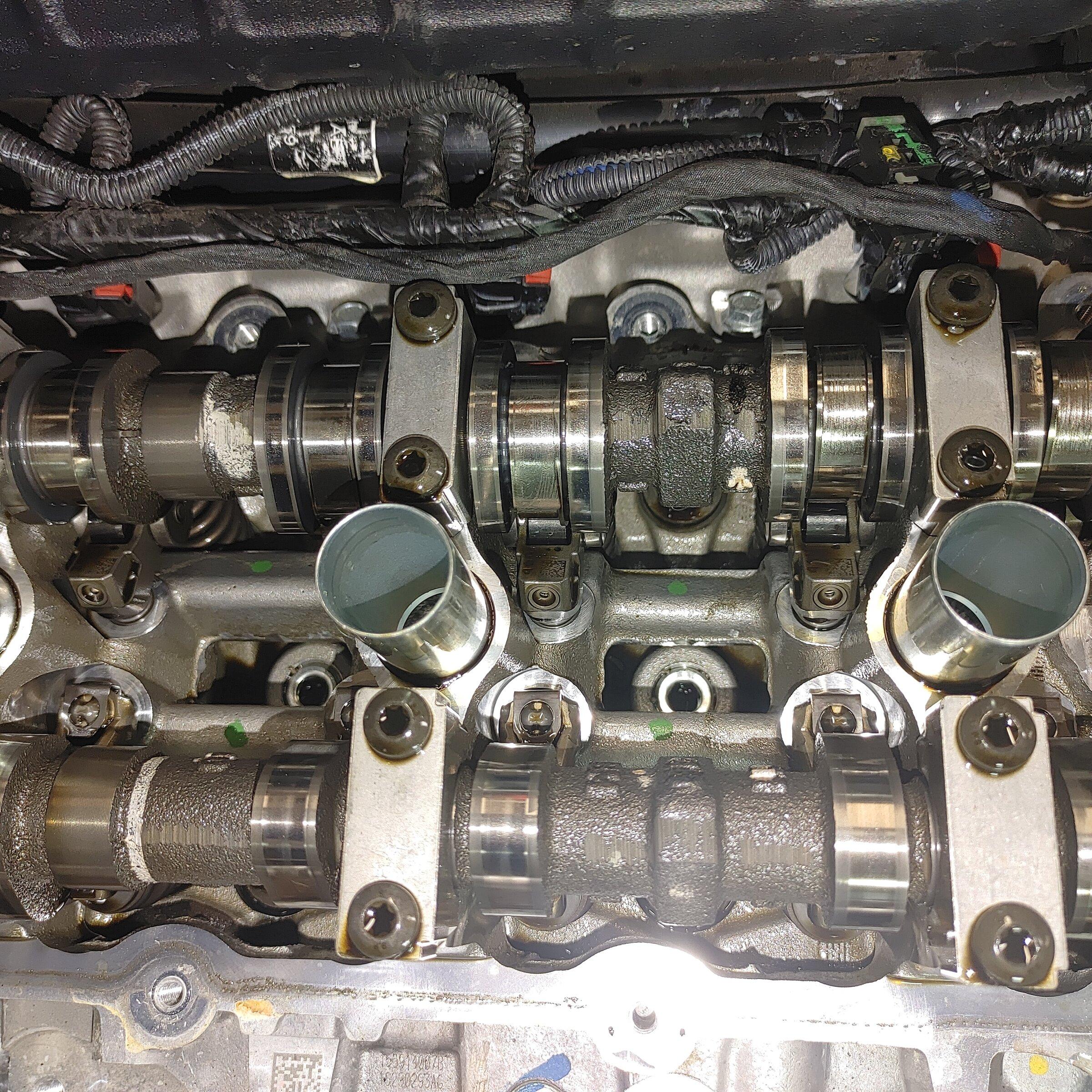

It is not a roller bearing failure. It is a viscosity failure. Fails to pressurise the variable valve lift passeges correctly and the high lift cam is actuating when the low lift cam is suppose to be. The rocker lobes have inconsistent contact and it generates a fair bit of heat, ulitmately burning up the oil interface and grinding down the cam and the rocker. So yeah, I consider the 3.6L to be, hard on oil. The more I think about it. The other issue is, the high lift cam is not a roller cam but extremely similar to a flat tappet interface, which probably requires high pressure additives like found in most race oils. Post more pictures when I am not flying.
Might be worth looking into changing after the factory 60k mile warranty is over?
How old was that oil? Ive seen gummed up lifters due to lack of oil changes. Isnt there also and oil pressure control valve that can fail on the Pentastar ?

Oil was changed every 5K with Penzoil ultra platinum 0W-20
