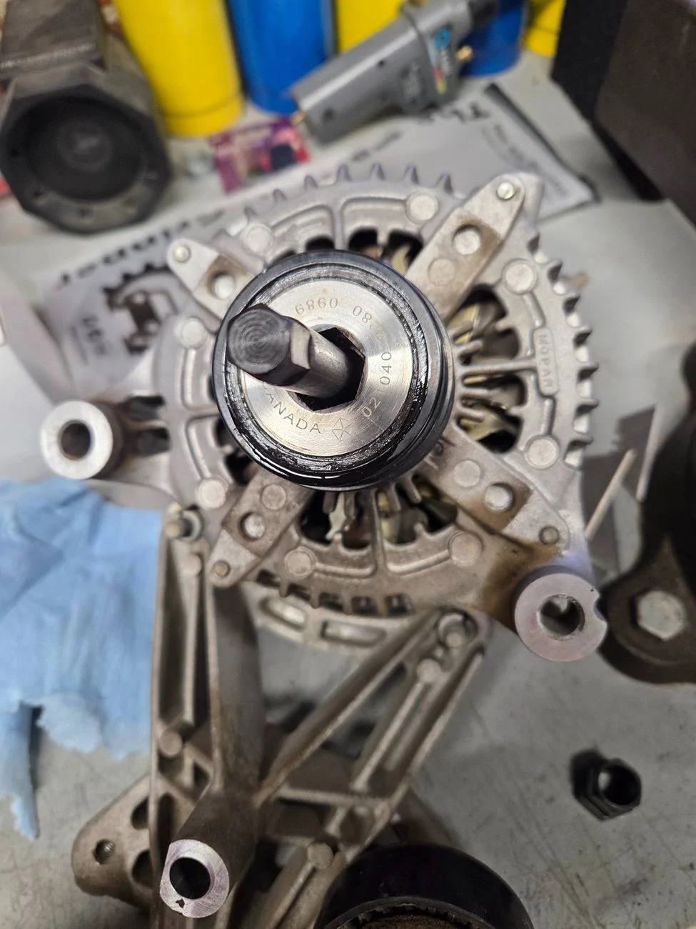

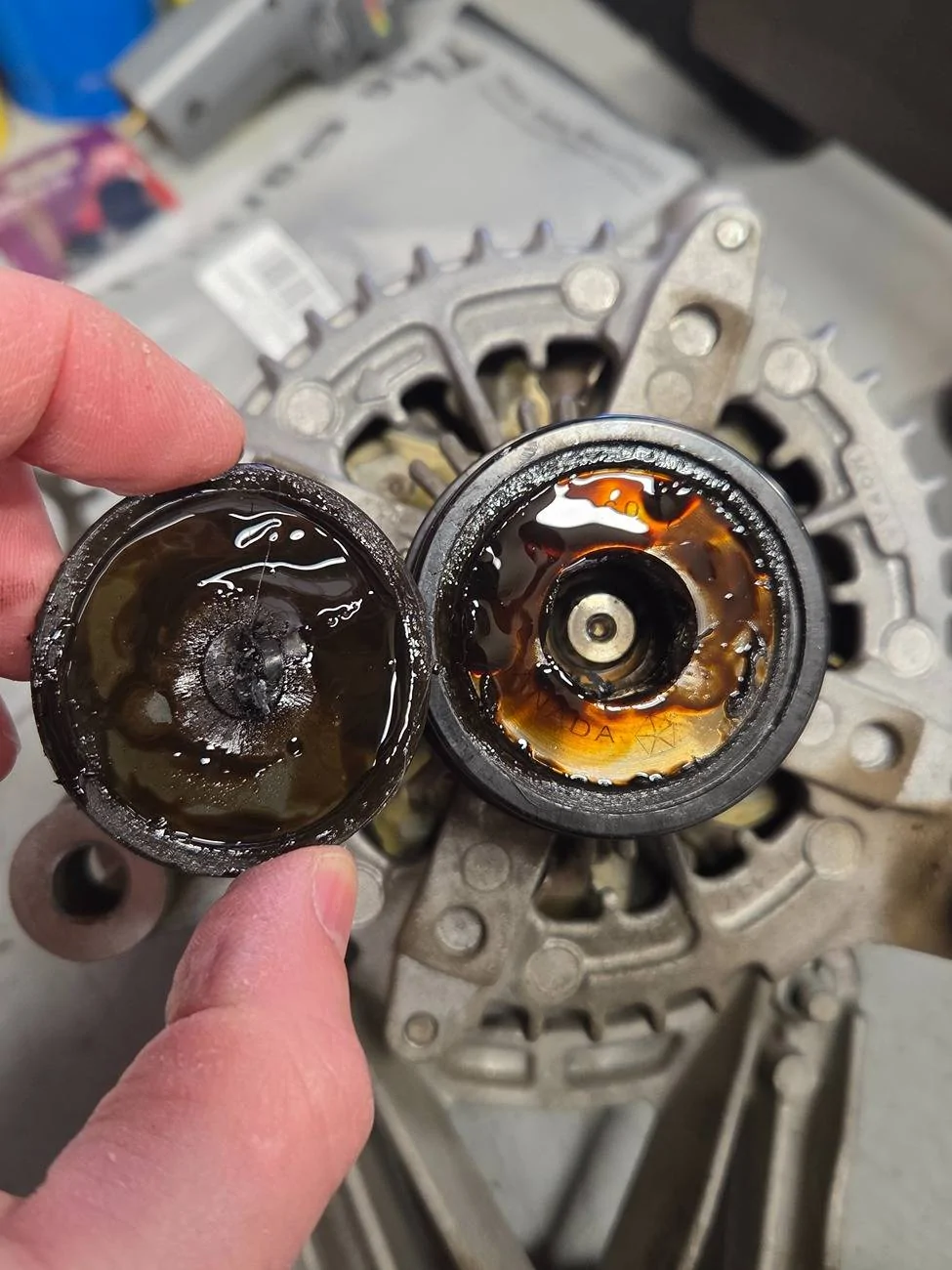

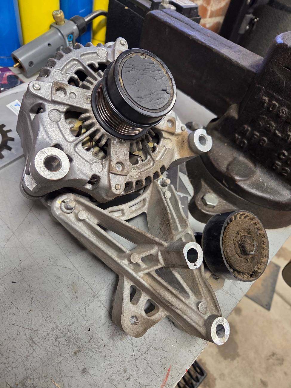

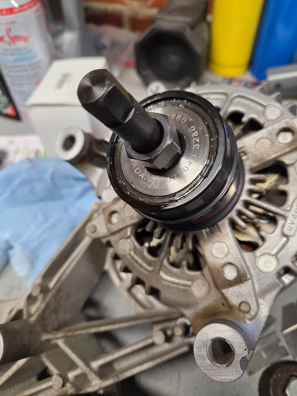

Just a quick update as I remove the OEM decoupler...

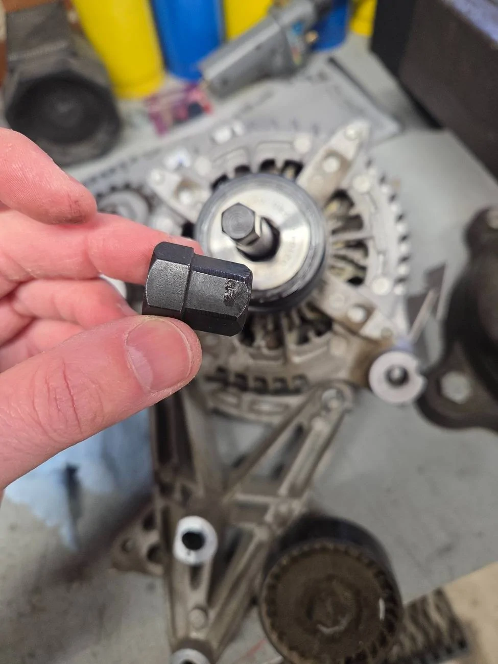

1) The dust cap was difficult to remove with a pick or small flat head screwdriver (for me at least). I simply drilled a small 1/8" hole in the center of the cap and used a punch to pry it out... worked great

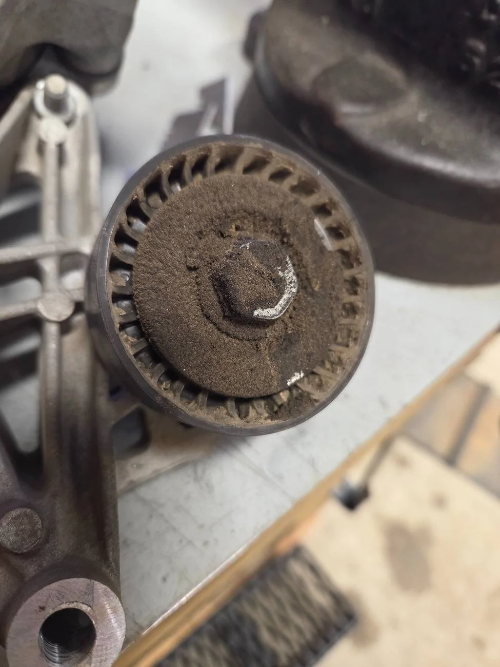

2) I had a lot of grease in the center of my decoupler pulley and it might be the reason the idler pulley looked so wet and crudy? I'm replacing both idler pulleys while I'm in here

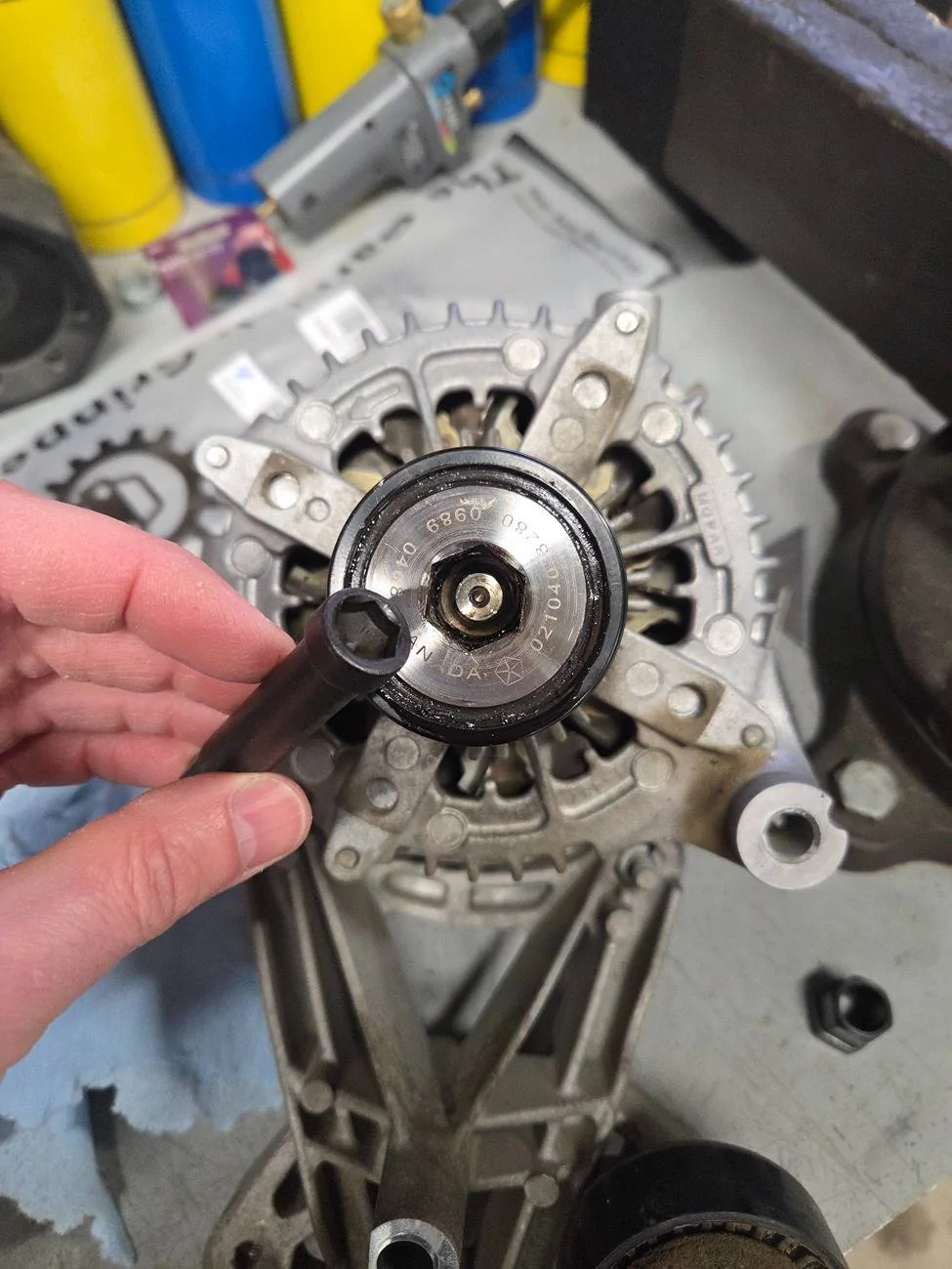

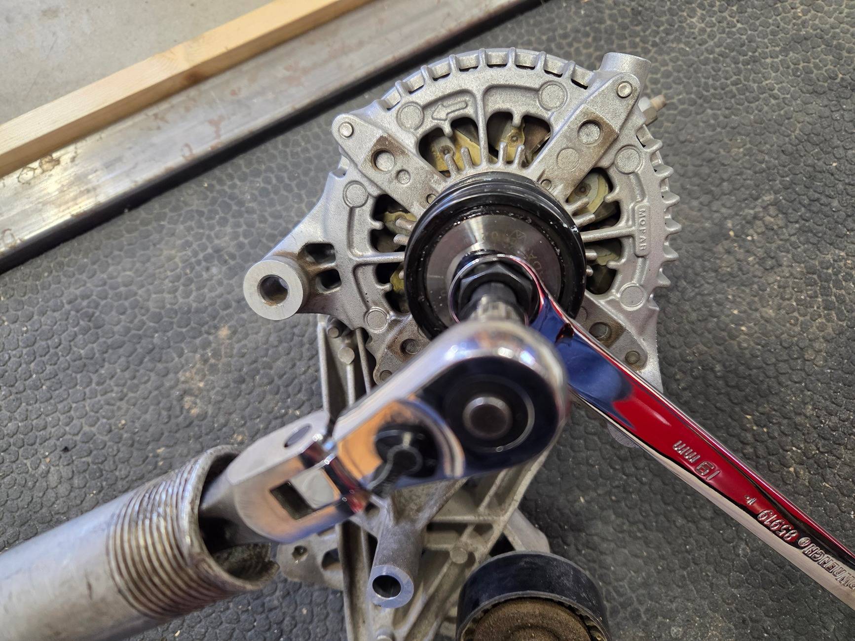

3) I personally needed all the leverage possible for the removal of the decoupler pulley... got a long 19mm box end to hold the large hex key in the body of the pulley and put a pipe extension on the 3/8" wrench with the 7/16" socket on the alternator shaft portion (10mm head) of the tool
4) If looking at the pulley on the alternator while it's off the vehicle, turn the 7/16" socket counter-clockwise (follow the direction of the arrow stamped on the alternator) while holding the 19mm box wrench stationary. If you do this while the alternator is still on the vehicle and you're standing at the grill, then you'd turn the 7/16" socket clockwise(or towards the driver side). Again, always turn the 7/16" socket the same direction of the stamped arrow while holding the 19mm box wrench stationary to REMOVE only
5) Reinstall
GREAT post - should be a sticky somewhere. I bet you'll save someone some work one of these days with that detail and the pictures.

Thanks! The JL Forum hyperlink in post #22 in this thread was helpful but it still left me a little unsure as a first-timer to this repair. I wanted to post EVERYTHING I could to make it simple enough for another beginner :) I'll be honest and admit it took me a minute to figure out the direction of the wrench to "loosen" vs "tighten" as you have to think of the decoupler pulley as the object that threads onto the alternator shaft.

So lefty loosy right?
Nvm. Re-read your comment and it's a reverse thread.

I updated post #30... let me know if that makes more sense? But yes, the decoupler pulley is reverse threaded when looking at it on the bench

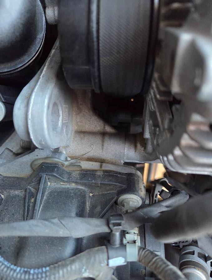

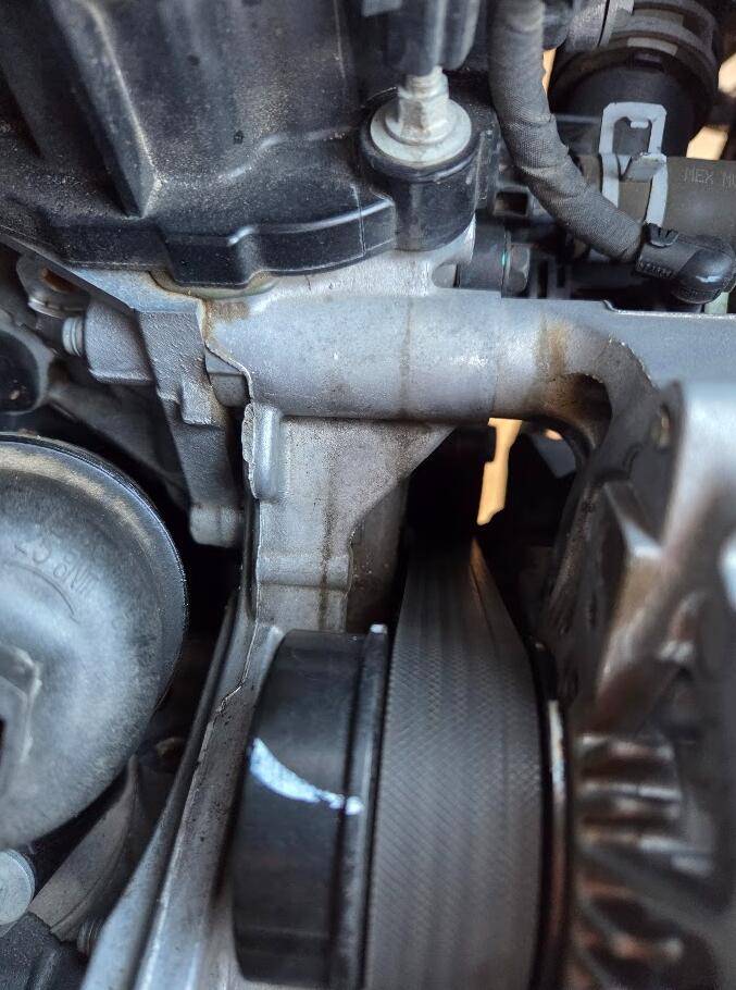

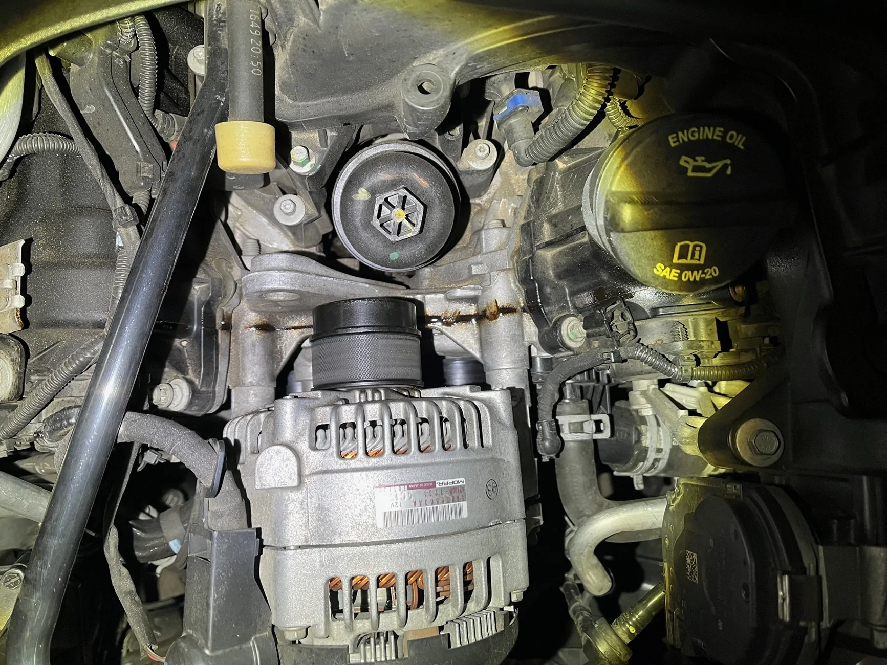

This pic of an oil leak was taken in the evening on December 30th. Because my selling dealer is a "Warranty Forever" participant (covers power train w/ no deductible), I brought my vehicle to their service department at 7:00 a.m. on New Year's Eve. It was a VERY slow day for them. The only thing that held up the repair was that the warranty folks needed to process my receipts to show that I had complied with the warranty terms.
One of the benefits of doing monthly reservoir-only PSF replacement, using a turkey baster, is that the owner has his/her eyes on the engine at least once per month. I consider myself lucky to have caught this oil leak, within one day after it started, while I was checking the level in the PSF reservoir.
My selling dealer diagnosed this issue as a faulty
oil cooler and valve cover assembly. After six days in the shop, including holidays, the repairs were completed on Tuesday, January 6th. No loaner. Learned quickly how to use Uber Eats.
Three days later...the line of oil has reappeared after cleaning it three times. Much less oil each time. I suspect that the original cause was the
alternator pulley, but the tech found the bigger issues and stopped there. I've bought the Litens 920080A Decoupler Pulley and Lisle 57650 Alternator Decoupler Removal Kit, and will replace the decoupler pulley next week. Big shout out to @Maximus Gladius for insisting, from the start, that this leak was caused by the clutch pulley wheel.
Although my dealer found bigger issues, I believe the following pic is a good example of a faulty alternator decoupler pulley. If this is correct, the countdown to alternator failure started in late December.
My comments above were revised on January 9th.
One of the benefits of doing monthly reservoir-only PSF replacement, using a turkey baster, is that the owner has his/her eyes on the engine at least once per month. I consider myself lucky to have caught this oil leak, within one day after it started, while I was verifying the level in the PSF reservoir.
I am watching the metal surfaces beneath the pulley like a hawk because at least one member of this forum would have sworn up-and-down that this was a faulty
alternator. I have not heard any unusual noises or had any warning indicators light up. I will have the alternator tested at O'Reilly and possibly at a local independent shop. The alternator received a small amount of the oil spray/mist, but the mist coated things behind and to each side of the alternator pulley MUCH more than in front of the alternator pulley.
If this issue was misdiagnosed and the alternator is still on its way out, I will come back to this thread. The alternator, of course, is not part of the power train, so replacing (any part of) it would be out-of-pocket.

Updated my description from "alternator" to "alternator pulley" to be crystal clear. Didn't know I had to be so specific. I will also update the testing comments in my post to meet the elusive forum specifications.
It would be on it's way out because the line of oil in
my picture looks just like the line of oil in the first photo in the (Wrangler) post shared by Gregj in post #22 in this thread. The resemblance is not as clear in any of the previous photos shown in this (Gladiator) thread.
In this thread, the (recommended) decoupler pulley remove & replace process is shown in
post #30, and the key posts include #21, #24, #26, #30, and #32.
