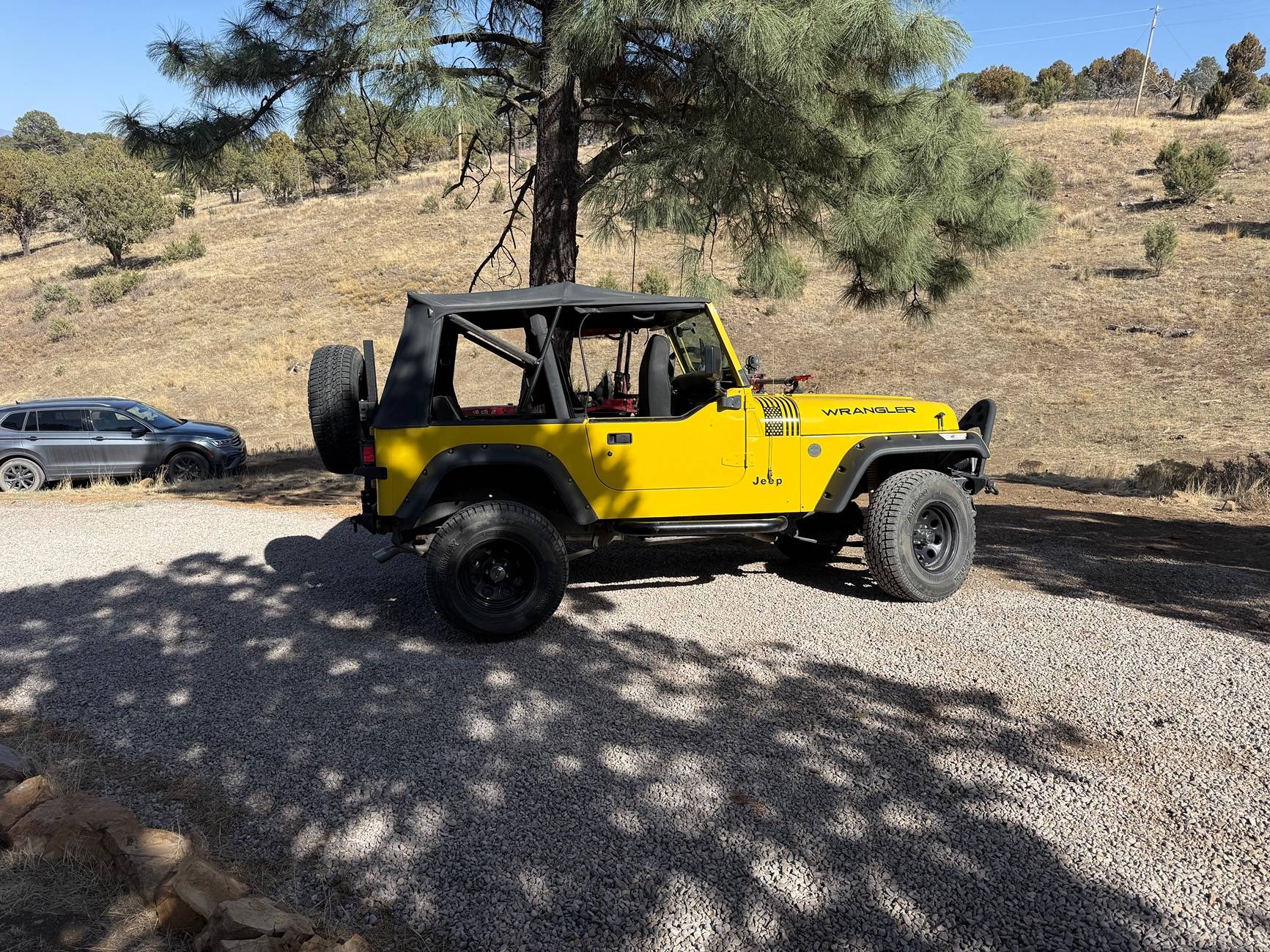

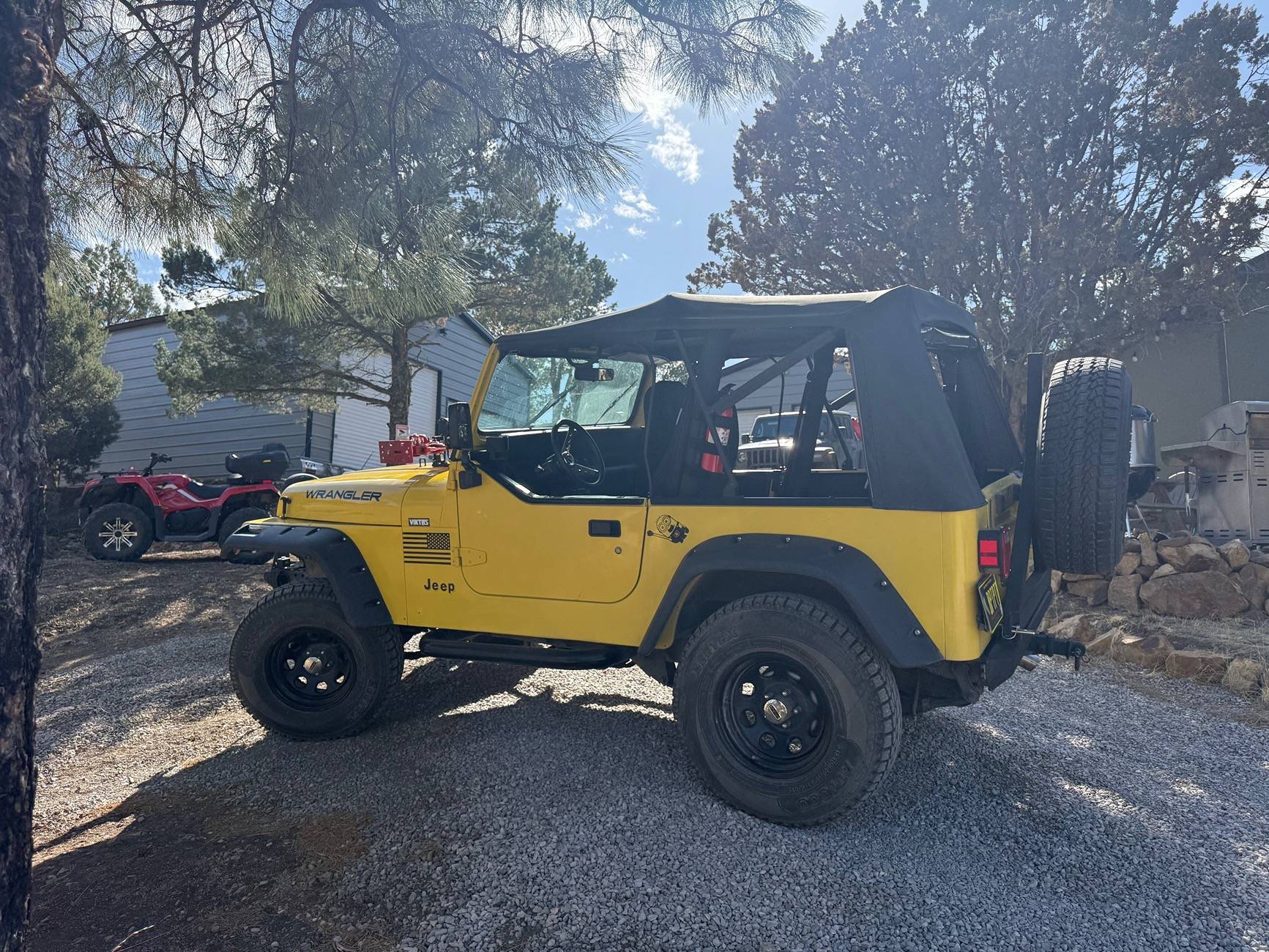

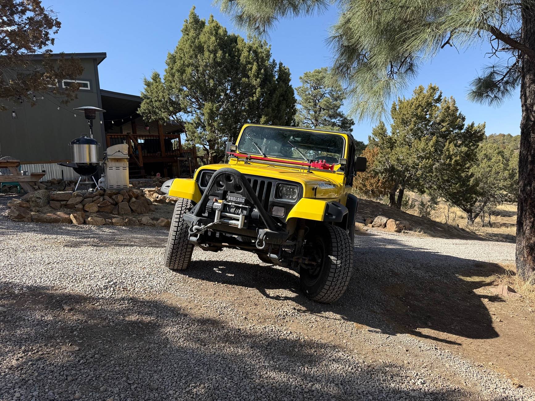

It had been a year since we washed our YJ. So we washed it, cleaned it inside and took it for a ride. Tons of smiles.

Thank you. I bought this one back in 2017 and it was a dump. The list of things I did to it is very extensive. It is a 2.5L 4 cylinder but it packs a punch after some modifications. Headers and full exhaust, new sensors, distributor (old one kept giving a CEL), 4.0 Throttle Body, 19lbs., Ford 4 hole injectors and intake. Detroit TrueTracs front and back and 4.88 gears. New interior, door panels, seat, seat belts, stereo, Polk speakers, Pioneer subs and Kicker amp, new Bestop top, winch, headlights, taillights, tire carrier bumper, new 31" last year (downgraded the 33" tires that it came with), rhino lined interior, new steering wheel, new brakes, lower steering shaft and bearing (last year), steering linkage, spot lights, hood lock. Etc. My mountain driving (local driving) MPG is around 17.5. Not bad for high elevation and mostly hills.
Seems like the steering linkage is failing or something needs attention as I'm noticing play in the steering wheel when driving. When I accelerate it pulls to the right and back to center when I let off. It used to drive very straight up until a few months back.
