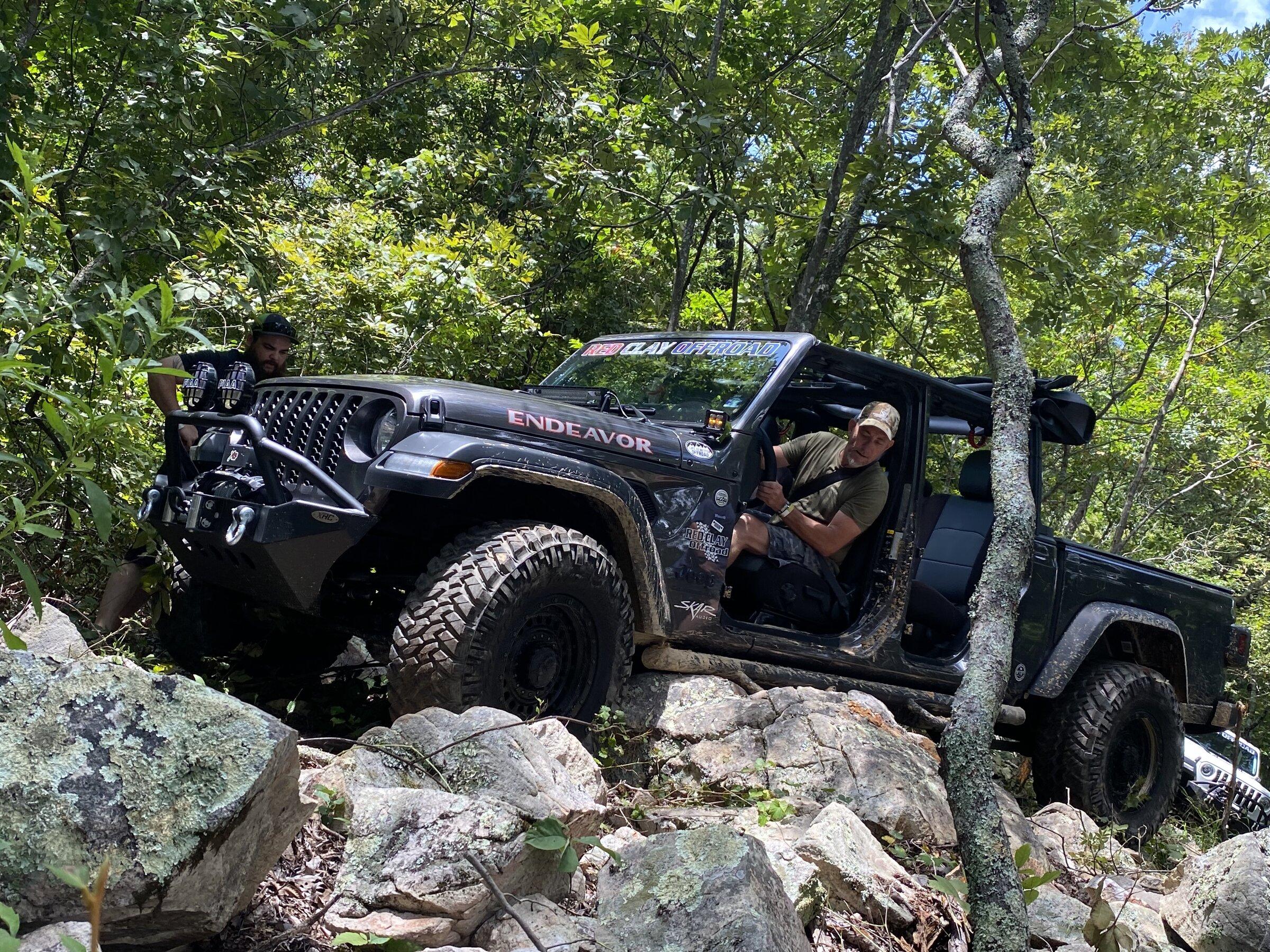

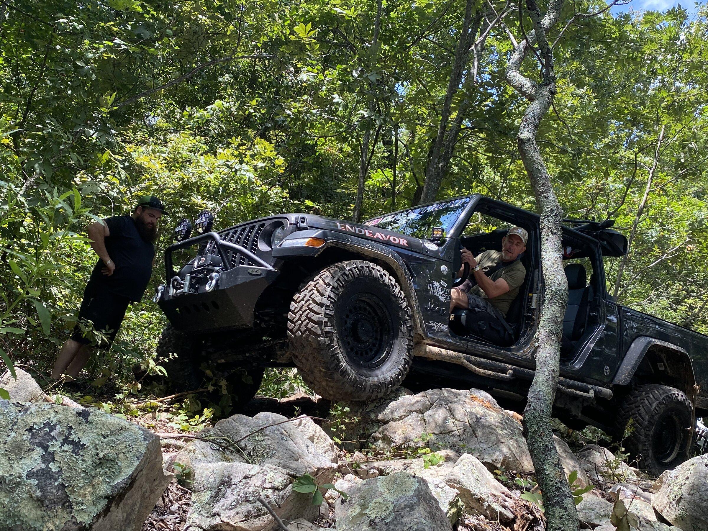

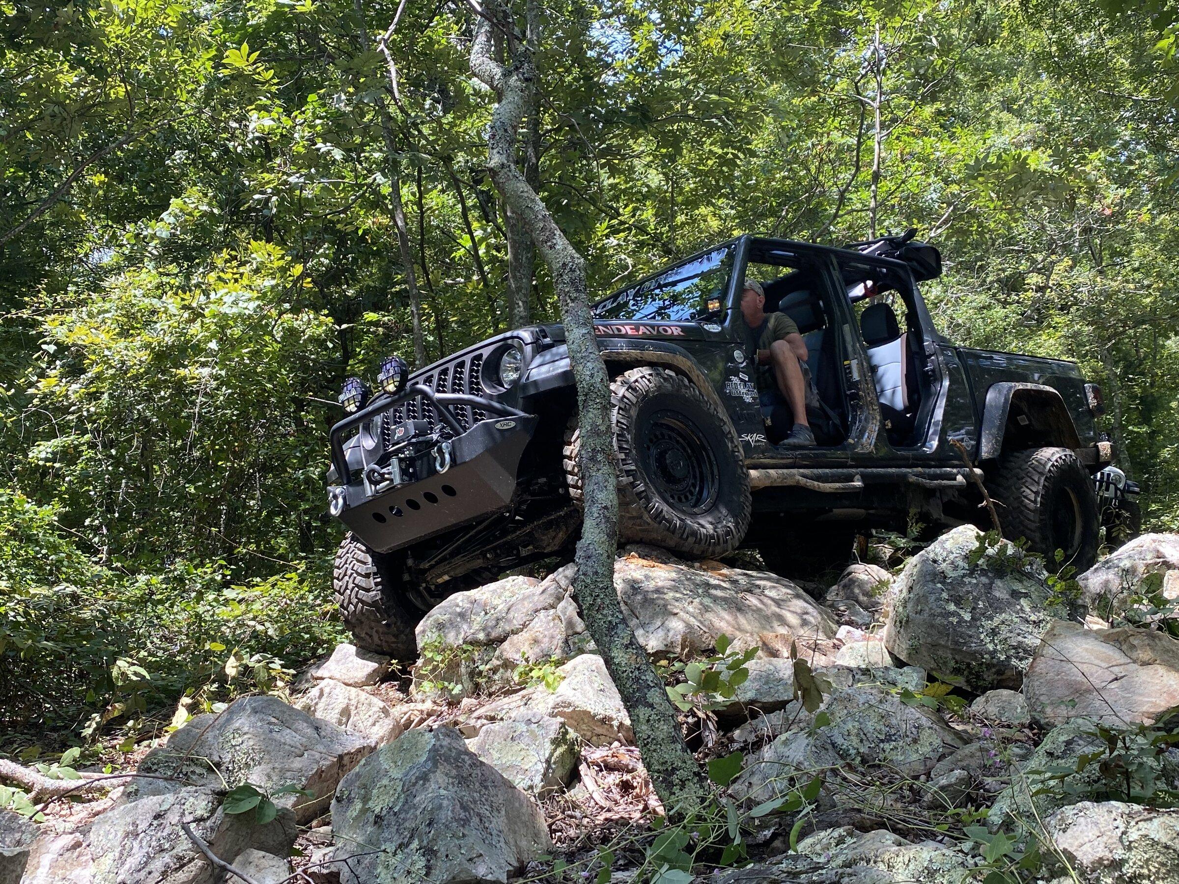

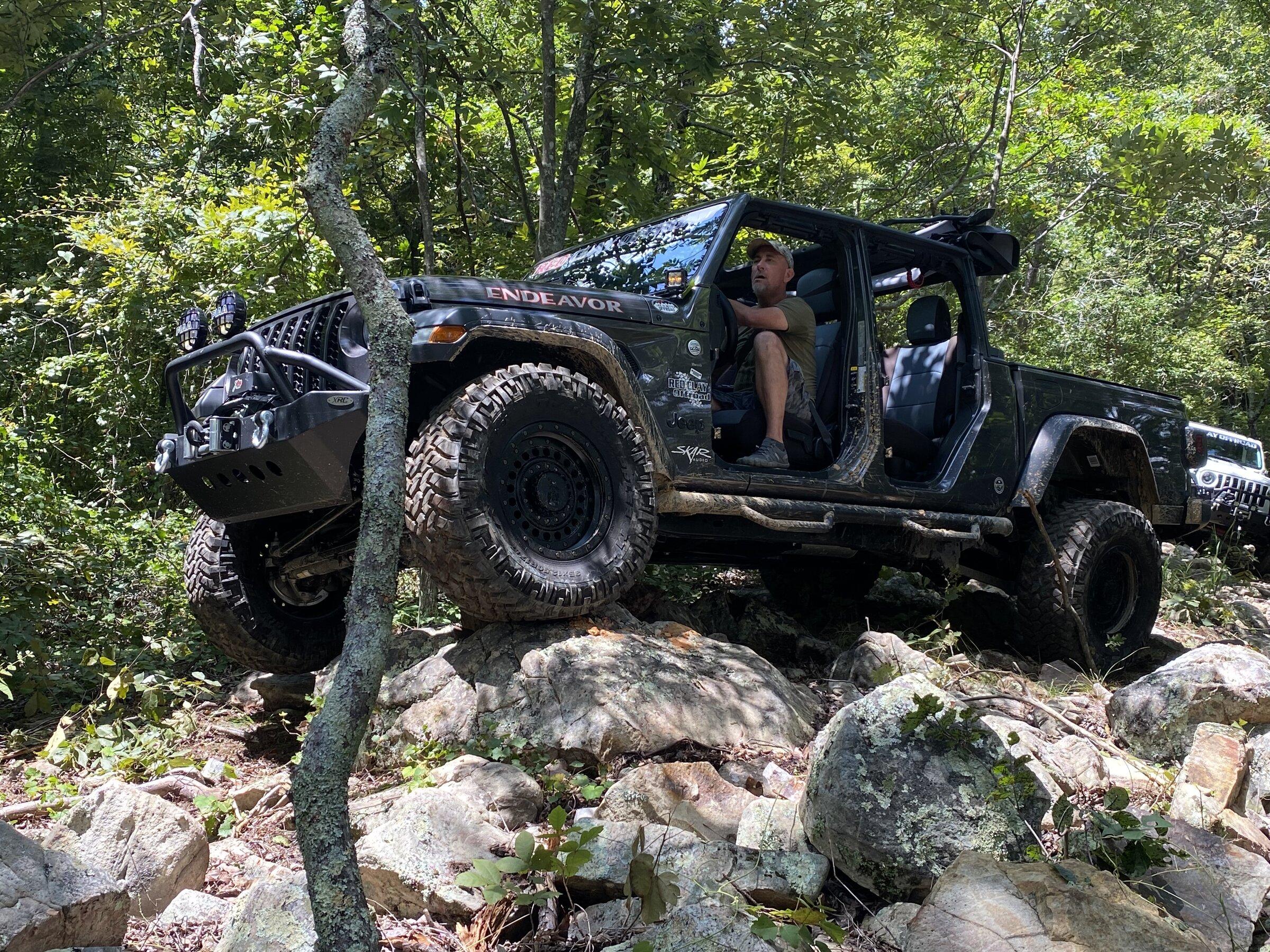

I have a 2021 Gladiator Sport with max tow. that I am ready to lift. I am currently running 35s on a leveling kit. Looking at either the Rock Crawler 3.0 or Evo 4.5
I went out to Choccolocco Off-road Park in Alabama and was amazed at where I could go with 35s on factory suspension (see pics)
local shop has an EVO 6” that someone ordered but decided against it. So they are willing to sell at cost. Don’t really want a 6” lift though.
will step up to 37 or 38” possibly next year.
she is a daily driver with some off-roading on the weekends but not rock crawling more than once or twice a year
