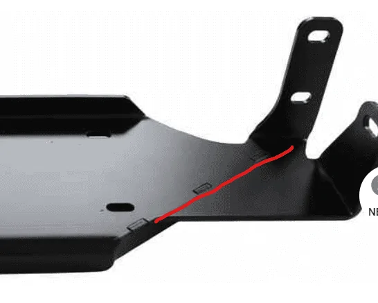

Depends - on how it's structured. If it's a flat plate with no other reinforcement, sure, but these also have trusses on the bottom - notched in, welded in. It's not a flat steel plate like some others. The brackets on the side are part of the plate, not bolted on, and the front mounts behind the bumper mounting ears. I'd be really surprised if you bent this plate.
Shape/design are almost as important.
I am not sure if I can access mine to do any measuring, but when I compared to my cheaper plate that came with the bumper, seems to me I got just about 1/4" with a micrometer. Granted, that includes the powder coating.
Take a look at the pics - there's not a lot of just plain flat plate to it. I'd bet it would hold to a full pull. Shape, design, and the welded on reinforcements on the bottom......... both the front and rear edges are also rolled/bent upward, both being close to the winch.
It's possible Warn's specs are generic - to count for various sizes and ways of mounting. It's narrow between the frame rails, and that matters. A wider plate mounted to a wider frame would need to be thicker or have some more reinforcement.
My bottom line is - when you specify how "thick" a plate should be - you have to cover all sorts of shapes and sizes and mounting methods. A smaller footprint means less chance to bend or flex.
Several reviewers say that have used their winch multiple times. I guess I have no fear or worries due to how it's made, which is just as important as a generic "must be xx thick". I wonder what an engineer would say about how the shape and welded reinforcements impact strength.

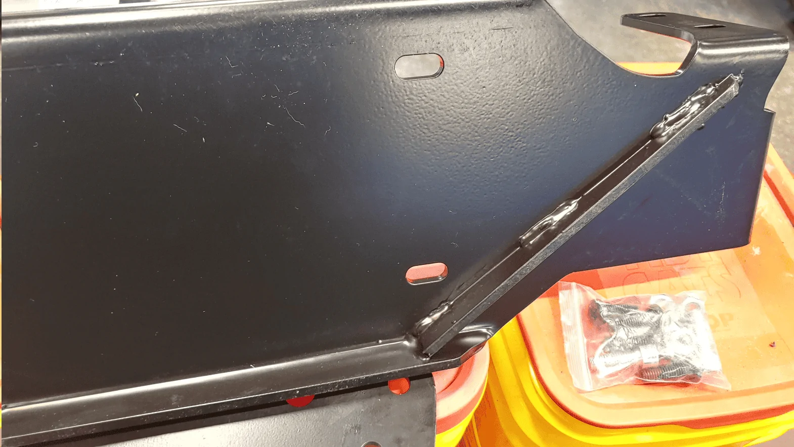

This is where the thick piece of steel is welded to the bottom - preventing the plate from bending or even flexing at all - you ain't gonna bend this unless you are abusing your winch or Jeep.
