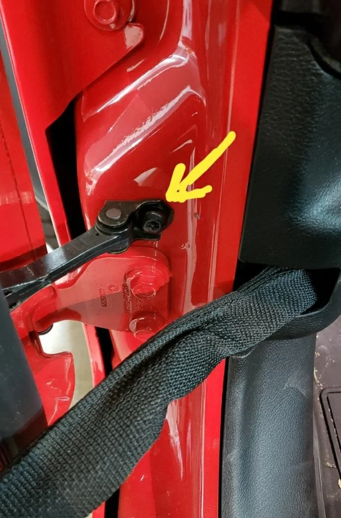

Check the door strap bolt. They can loosen up.
Jeep Gladiator Clicking sound driver side door 20200904_214454

Both of mine make a clicking sound. I'll check that door strap bolt. Would be nice if that worked.

The door strap (actually a door detent link like most vehicles have with non removable doors) can also be defective. My passenger side door detent was making that noise... then it broke off in the door (I like having them over the old school Jeep doors that just swing open on a strap only set up). Some on this forum have unbolted them and pushed them bank into the door.
I had Jeep dealer replace it and no more issues.
