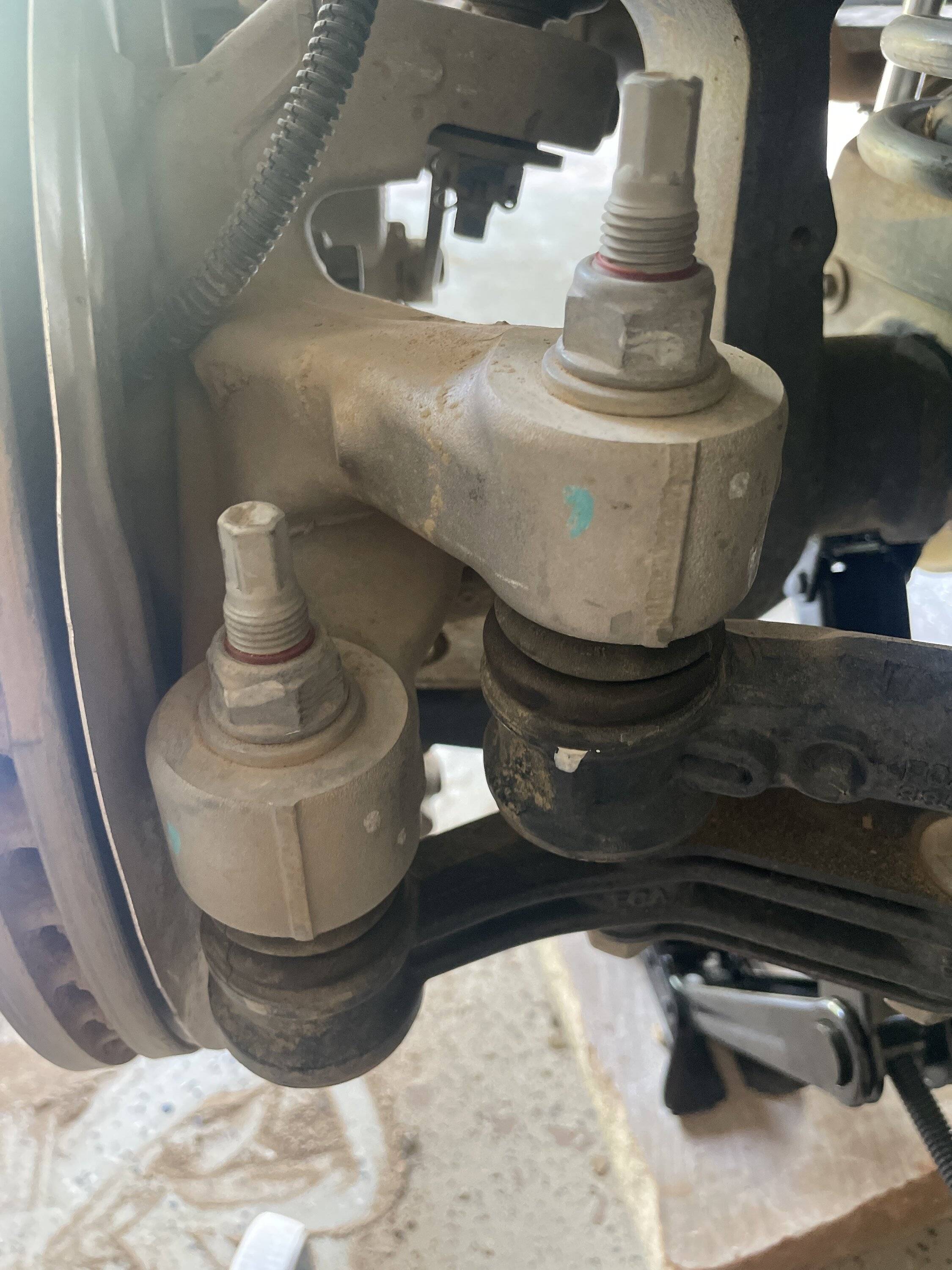

I went wheeling this weekend as part of the Ozark Overland Adventure Patreon meet up.
Noticed a pretty bad clunk on the front end when the sway bar was disconnected.
Hard to tell any further than that but I’d say it was when I was turning slowly, with some droop on the front wheels. I.e dropping down off something and turning at the same time.
It was a series of clunks. Boom boom boom. My first thought was the spring catching the bumps stop but looks ok?
I can grab and wiggle this part and the bars that run across. But tightening doesn’t fix any slop in there
Jeep Gladiator Clunk on front end image

Our JK had terrible clack from the stock drag link. Finally went aluminum Barnes and it went away completely. There are some heavy duty boots, but that only masks it for a while.
