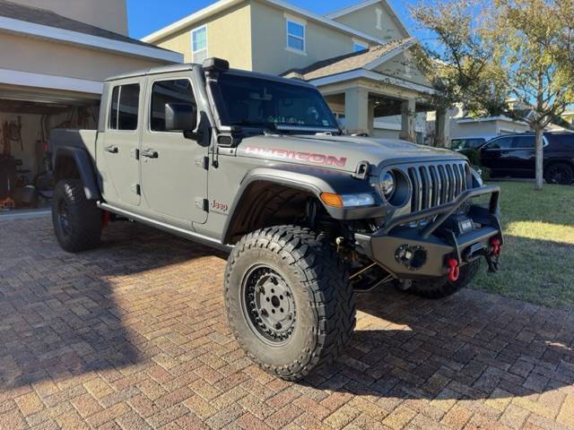

Just installed my Metalcloak Game Changer. Same issue. It was the sway bar links on mine. I had to push that rubber boot back on the one end and torque that to spec. I noticed the sound rocking the Jeep pretty hard from side to side. It stopped.
Now I’ve got some rattling in the back going on. I’m gonna print all of the torque specs out and go over all of the parts I installed just for peace of mind.
Then to the alignment shop.
