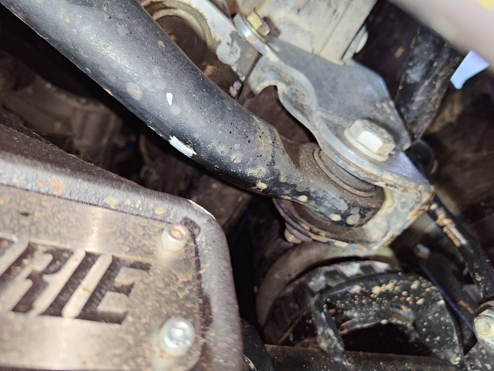

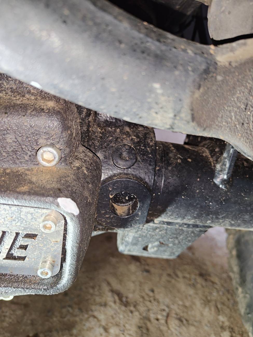

I went with the the Synergy and installed it when I installed their sector shaft brace. The two big pluses in addition to significantly more strength are that the axle mount end is fixed which perfectly positions the offset required to clear the pumpkin. Others require you to figure out the angle to clear everything. Also, the adjuster on the frame end is just like the oem adjuster on the drag link, meaning you simply loosen a single pinch bolt and then twist the adjuster by hand to dial it in. Simple!
