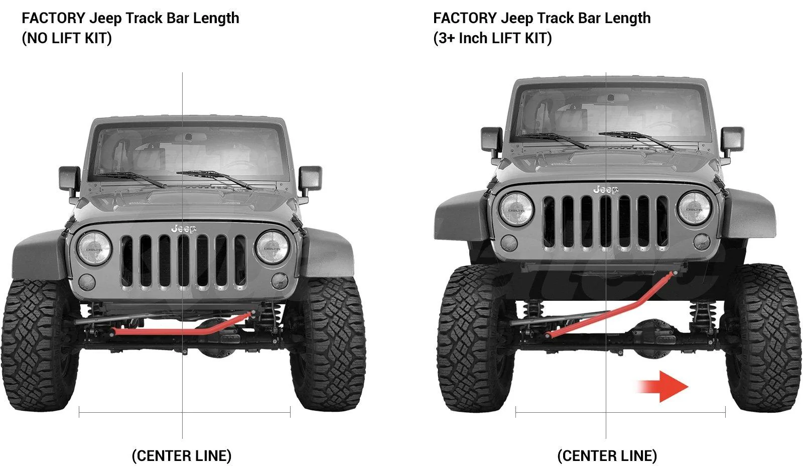

picture for visual reference for members who are not familiar with what you are experiencing.

Jeep Gladiator Which Adjustable Front Track Bar? jeep-track-bar-out-of-alignment-diagram
