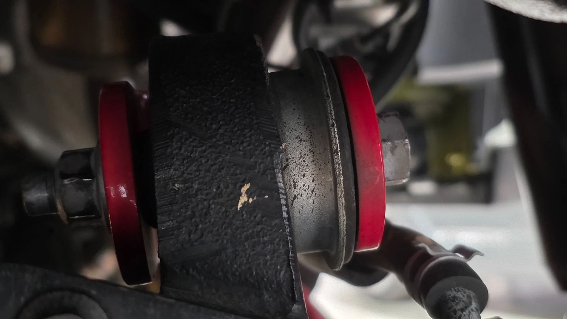

Thanks. This is off-topic, but is this bushing poking out on the driver's side upper control arm normal?
It would depend on the control arm bolt whose are those? If I had to guess though, I’d say probably not.

It's the stock bolt holding in a Core 4x4 control arm. That cast part that sticks up from the axle and holds the control arm appears to be narrower than the bushing shell.

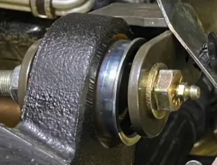

I found this on RockJock's YouTube page. It looks like that bushing normally sticks out like that on the driver's side.
