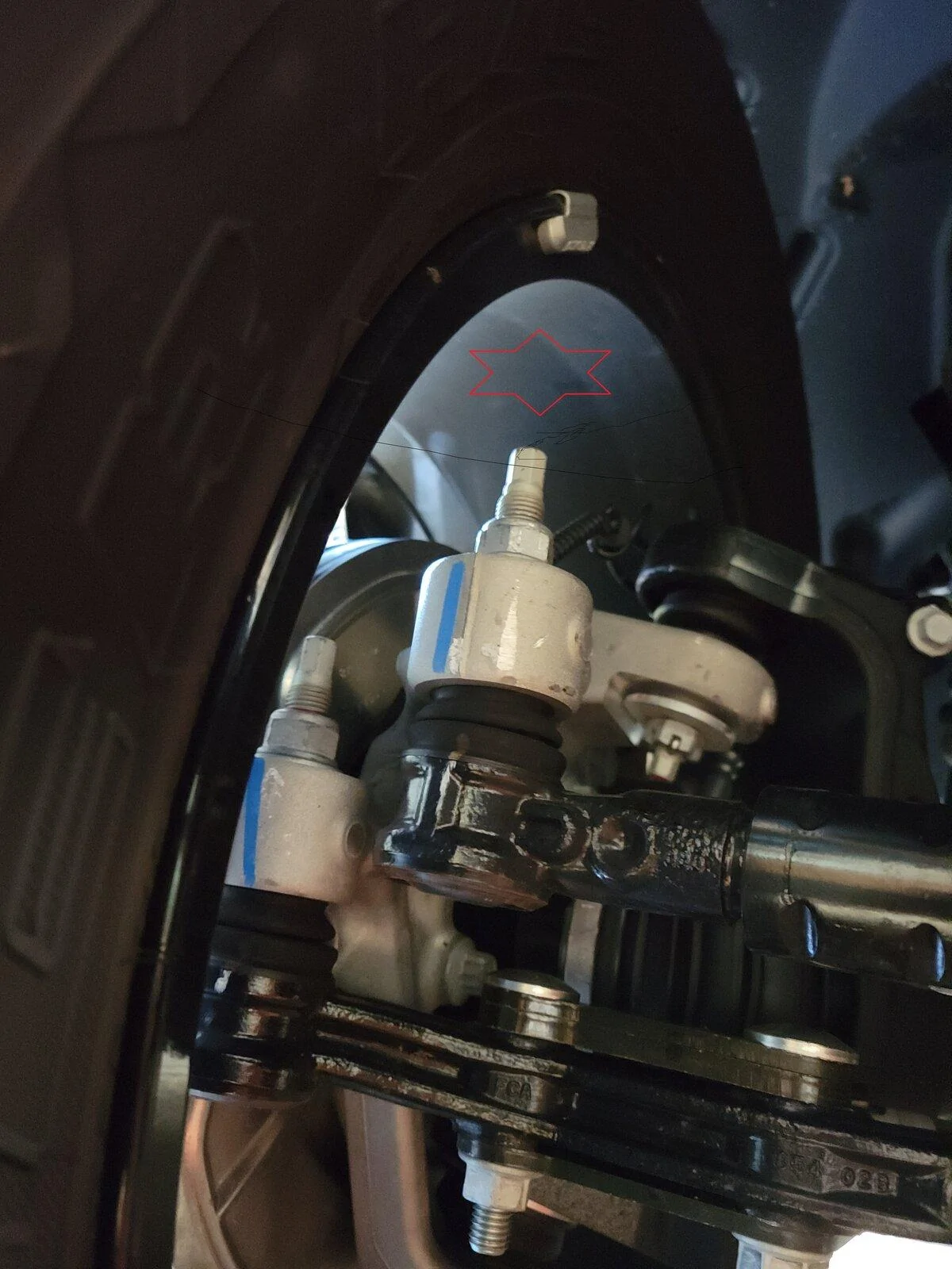

I found the top nuts on the knuckles loose! I tighten to 41 lf ft and have not heard my noise again. I have read a lot about nuts and bolts being left finger loose on our JTs.
